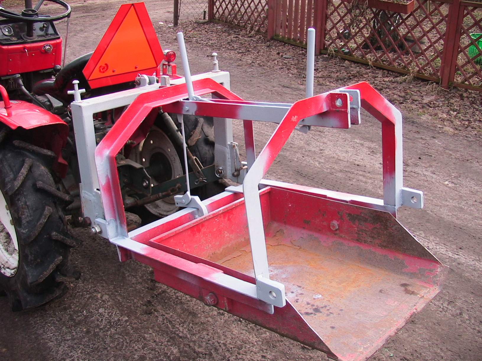

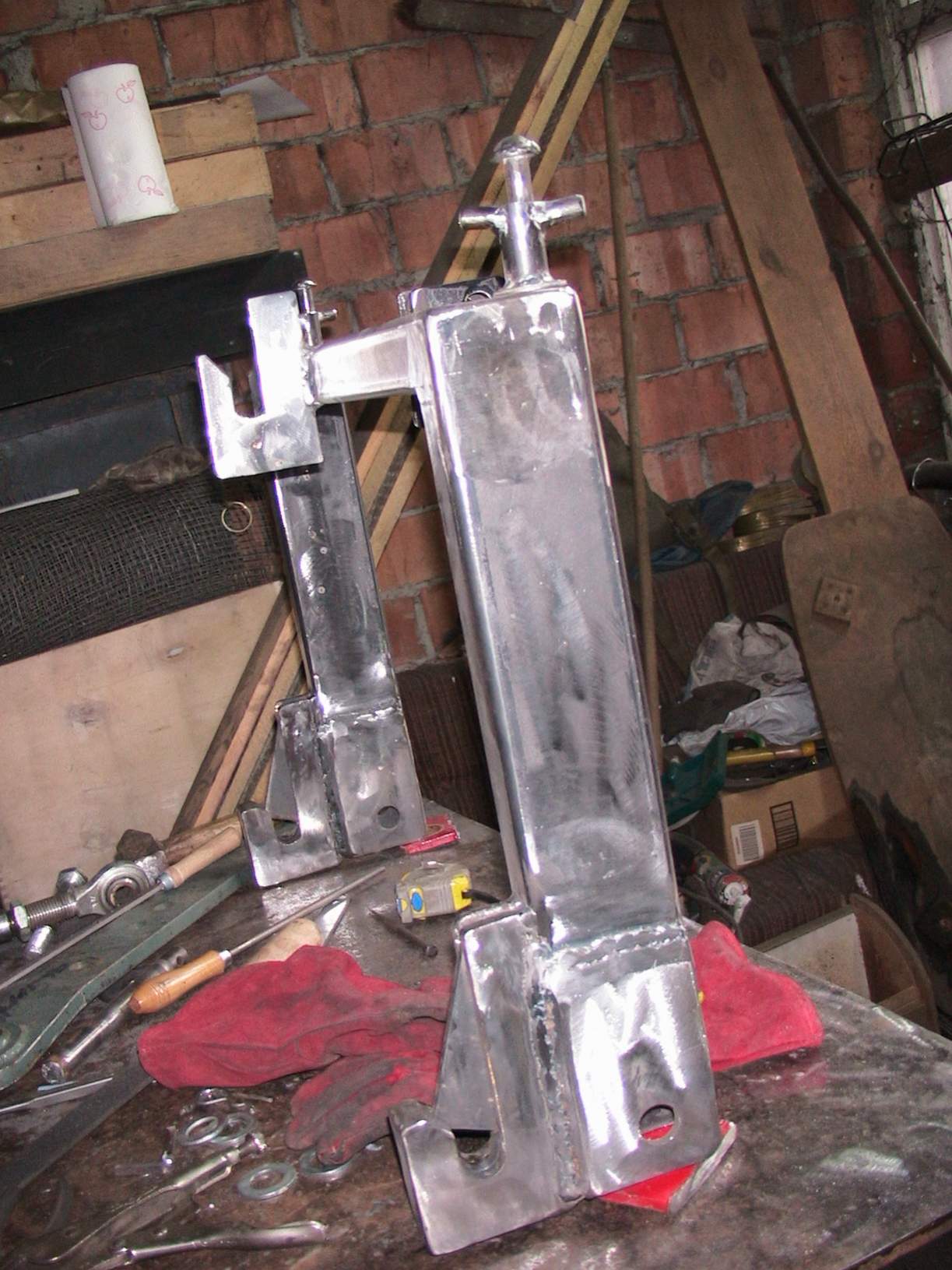

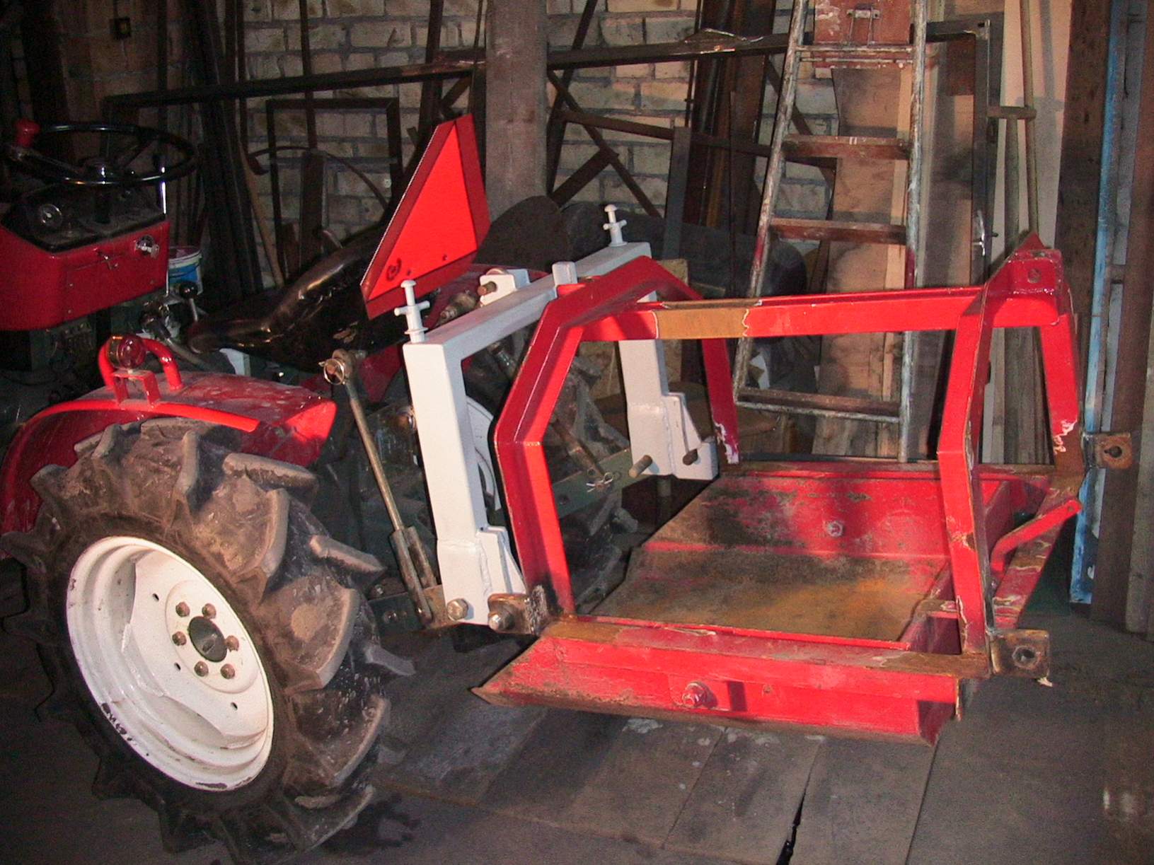

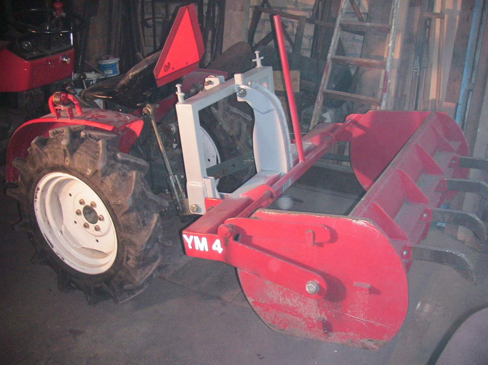

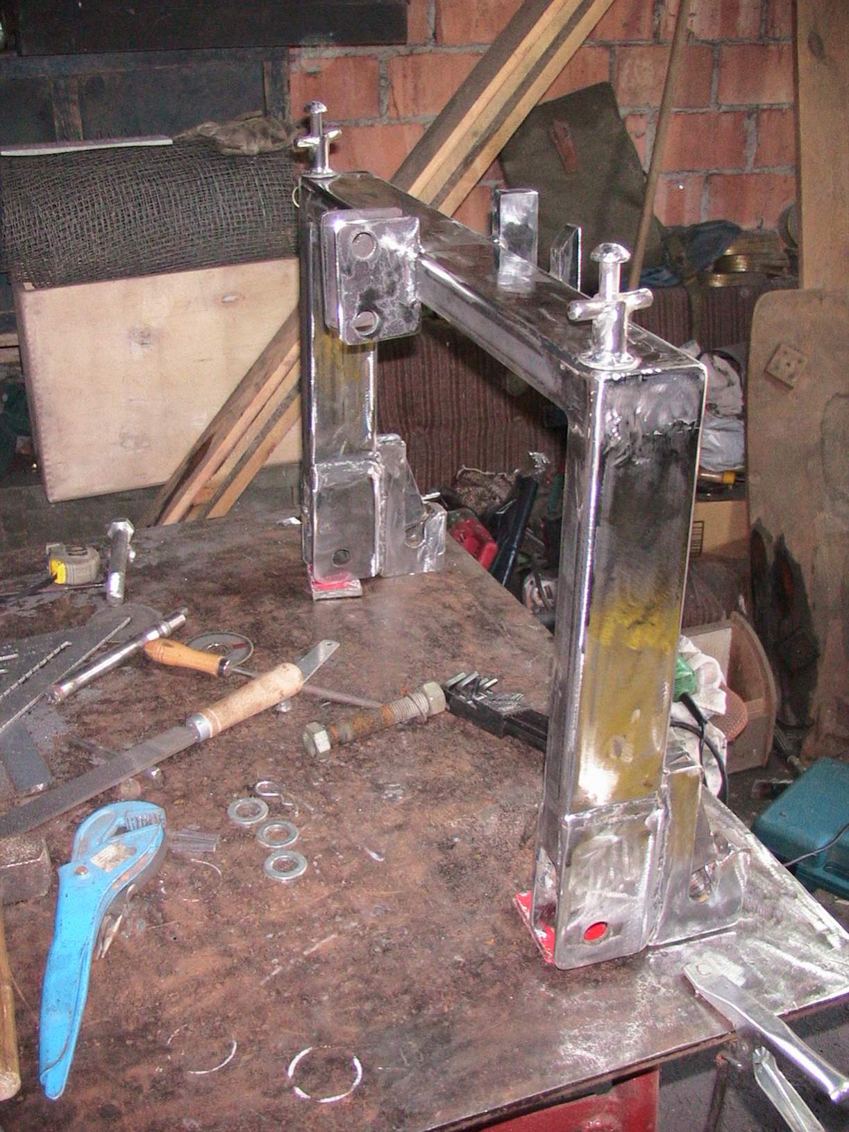

I had a few snatches of time here during Christmas break to work a bit on conforming my implements to the QH. First I polished the QH up a bit and sprayed some primer on it. Then, I started with the RB and ended with the Rollover. For most part I just did the standard thing to conform them, but the rollover I treated special.:D
The RB top link connection was a 1/4 inch low.:eek:
The ball hitch was right at standard. :)
The scoop needed its bottom pins spread about 1/2 inch, top is OK not perfect.

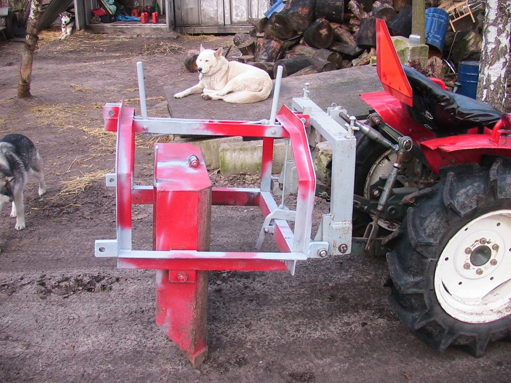

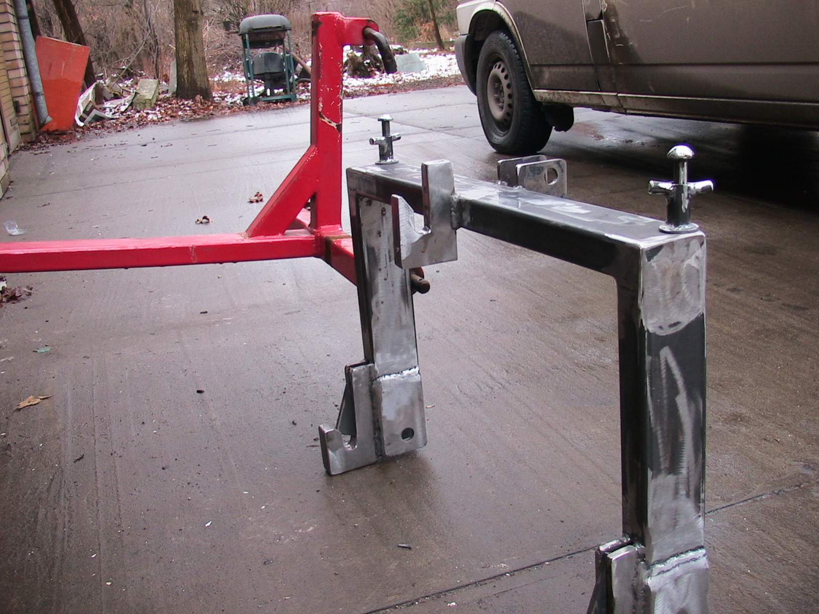

Now the imitation Gannon rollover was OK on the lower pins, but somehow in the manufacturing I messed up and the top was about 1.5 inches high. It is not a design that would be easy to just lower the hole or drill a new hole. I was going to require some major work to conform it.:eek:
If I was going to do some thing major I might as well do something exciting.;) So I drew up this curved neck for a top link and cut the pieces out of the old top link mast. Well I had to patch a few pieces together to get sufficient width.
Then I doubled up on the neck where the pin goes through to give it a bit more strength.
Then I conformed a 2 inch wide flat stock to separate the posts and provide some stability. I have wanted to try to do something like that for a while and it was a good opportunity. I just heated, bent, and tacked until it was all in place.
I welded it on the draft tube of the rollover, sprayed some primer on it and it was ready to go. I like the way it looks. It looks special and it was fun to do--although it did take some time. It sort of looks like a penguin sitting there. :D

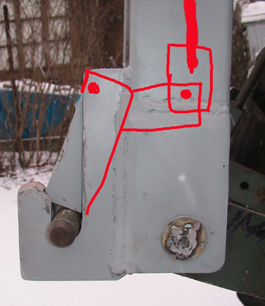

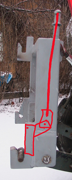

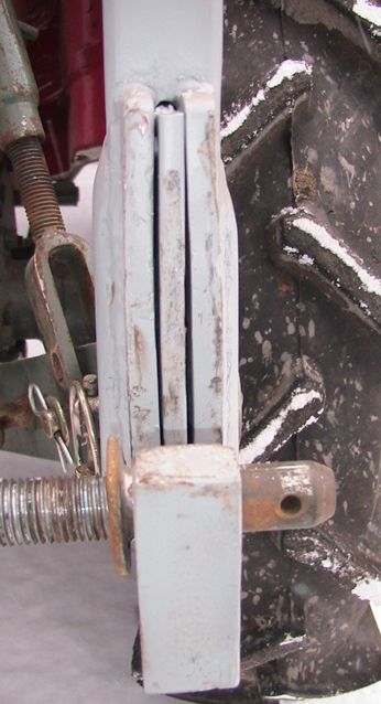

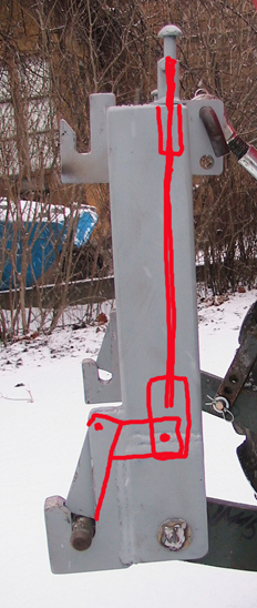

Just a question regarding the quich hitch locking mechanism Mike... Can you elaborate on how the mechanism works? Maybe a sketch?
I am not much of an artist and I do not have any drawings of what I did. but I took some pictures and tried to draw on them to show the internals of things. This is what I did, as I really do not know how the professional QH's work or what kind of latch mechanism that they have. I am just using the weight of the latch and the rod going out the top to close it. It seems to work well--I plowed some snow today and that puts the weight of 3 pt against the latch and it NEVER came loose. :D Love it when something that I designed actually works huh?!! The harder that the pin pushes against the latch the tighter that it should hold the pin. The clearance with the pin is pretty tight--there is no slop when it is latched. The latch barely clears the pin when closing.
I used a rod 10mm out the top so that if I have a stubborn fit that I can push down on it. I would not want to hammer on it, but 10 mm is pretty strong to push to get a positive latch. The release is a piece of 3/4 pipe that just clears the hitch when fully open. I may have to do something to help it stay open, but so far I have been able to get it to just hang on the edge of the hole that it would go down through.
If you have any other questions I will be glad to explain it more. Where are you in "western Europe"? What kind of tractor do you have? If you need some info about the rollover too just let me know.
Mike

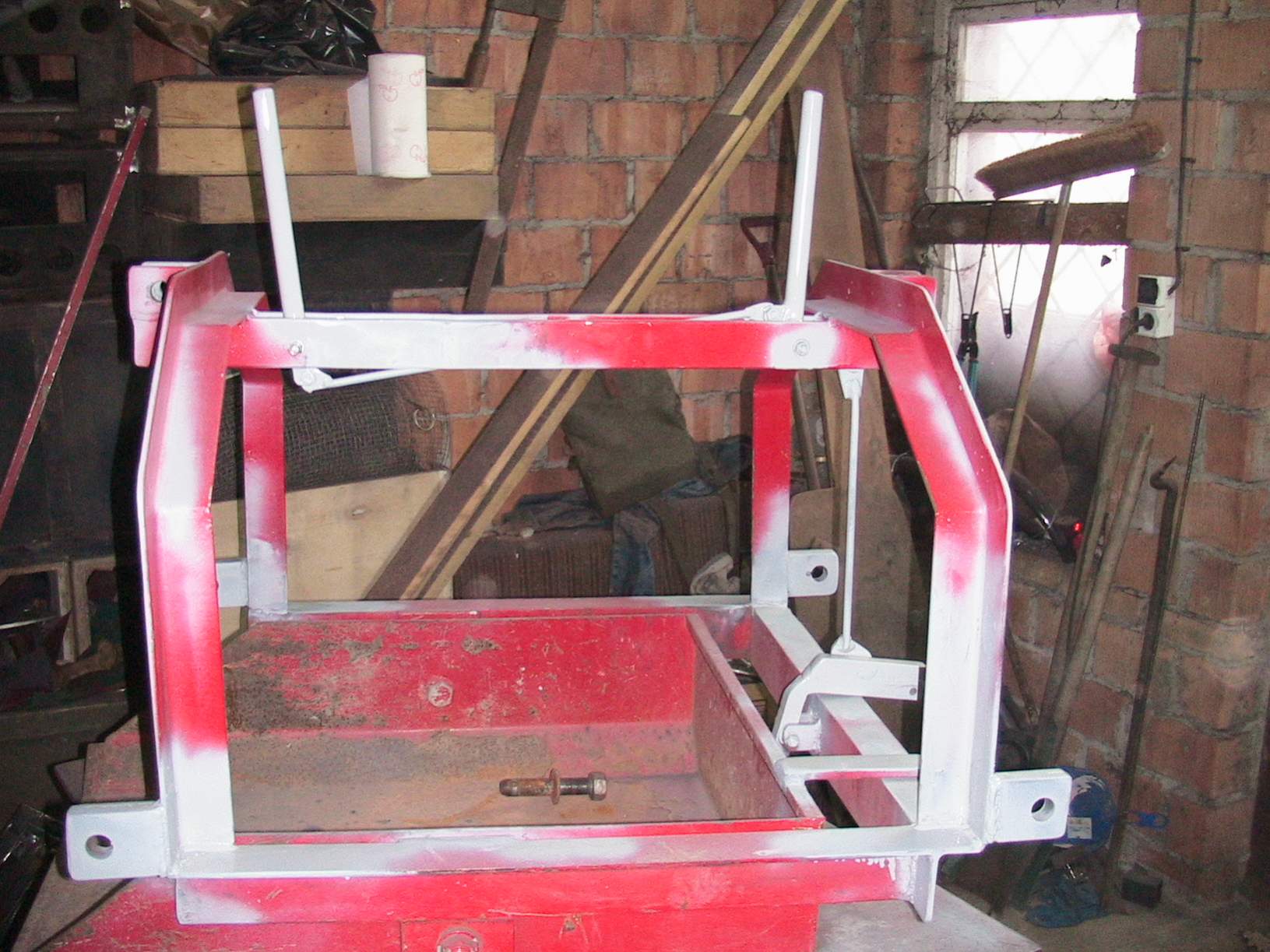

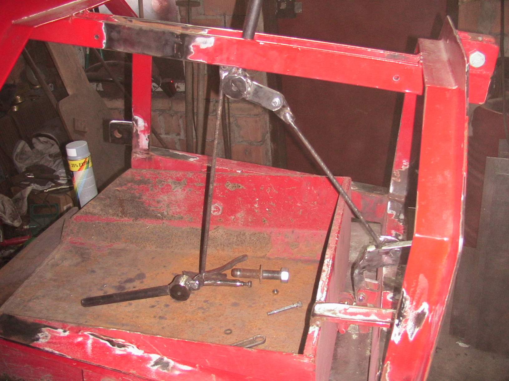

It has been awhile since I updated this thread and I want to show what I did in regard to the scoop. I was busy but finally had a chance at some shop time. :)
I was using my scoop in the reversed position--back into a pile mode--as a large dust pan. Normally, when I dump it I can just reach back and trip the mechanism, however with the QH, I cannot easily do that, the hitch blocks me and I cannot reach the trip without being a contortionist. :(
I tried simple things first like just extending a handle out the top etc, but nothing would really work properly, so finally I broke down and made up the linkage that you will see in the pics. I wanted to make sure that the latch closed properly so I doubled up on the latch counter-weight. If the linkage was attached to the end of the weight handle it would interfere with the top hook of the QH, so I fudged a bit with the linkage alignment. By crossing the linkage between handles from top to bottom, I was able to keep most of the linkage protected in between the top frame and that make both handles work the same. Just give the handles a push and the latch releases. This really works well, at least for the three trips that I made with it. I only wish that I had done something like this from the beginning. That is what I get for being such a "copy-cat" and slavishly copying the KK. :eek:
Mig is pretty amazing in the holes that you can easily fill in. The handles are made from 3/4 black pipe, I did not have a piece of rod in hand, but that meant that the pipe top need to be covered so that it did not become a reservoir for water and crud. I simply welded around and around and filled in a 3/4 inch hole!! To me that is amazing--I had never used mig before getting this one. Then I used the flap disk to clean it all up. The result is a nice looking handle.
