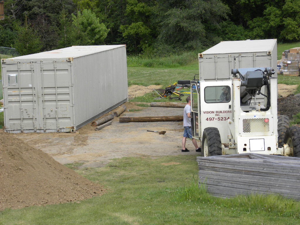

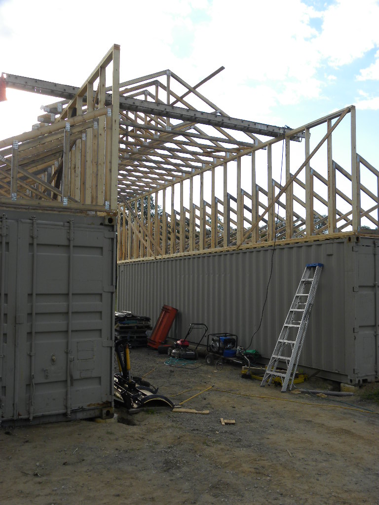

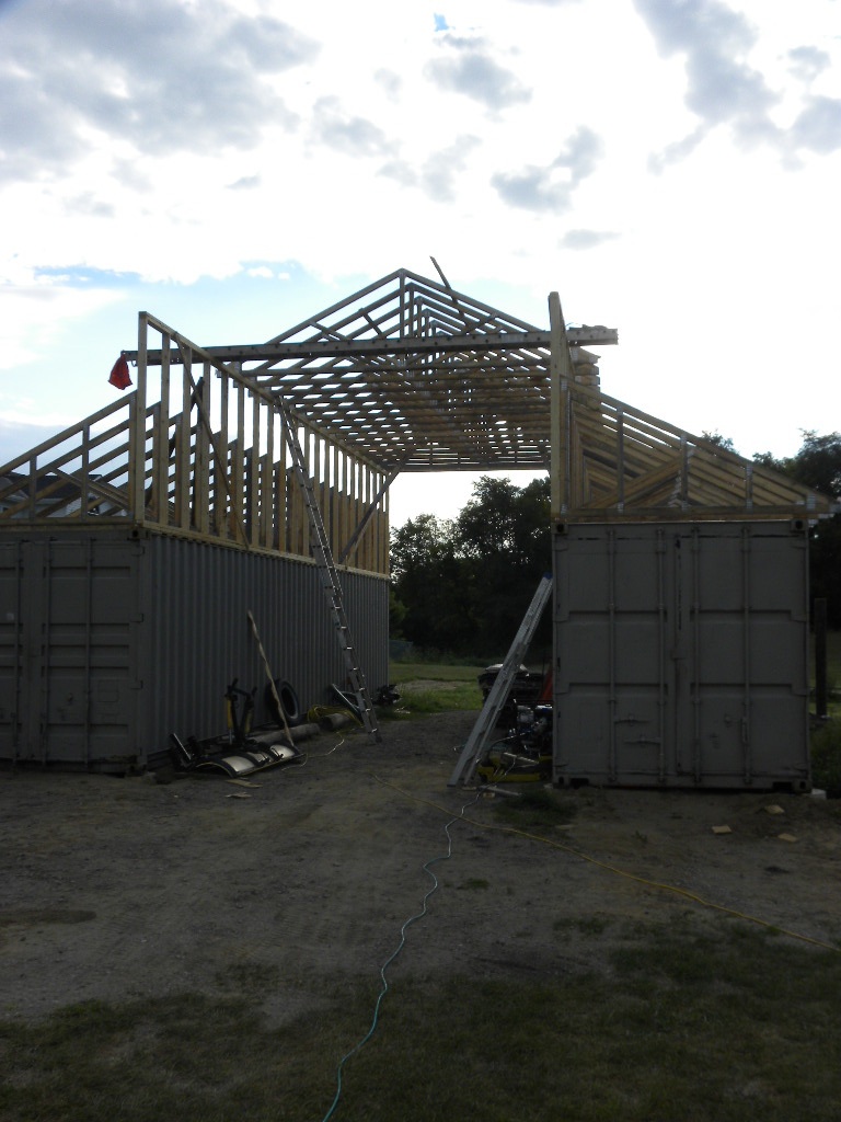

Each container has 10, 48'' deep 24'' post footings with another 1 foot of gravel underneath for drainage.

I'm probably going to get some input from the building inspector RB. YD, nice job. What is the inside width?

I'd say using containers actually costs more, but I already had two 20' containers and the 40 will give me enough for a second wall. I like the security of the containers for storing my more expensive items. I also needed the additional 40 for quick temporary storage, so it works out all around for me.

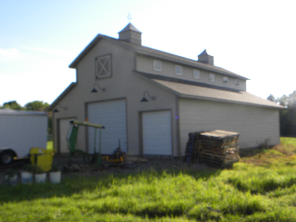

I should mention, 16' ceiling in the center and I built a 14 x 20' mezzanine in the back half with staircase, 7' ceiling height up there, and 8' of clearance underneath it to the joists.
Also, i get alot of storage on the roofs of the containers between the trusses.
   / Making a barn out of shipping containers. Any ideas? #19
that looked like a great place to store things!! it looks great btw.
