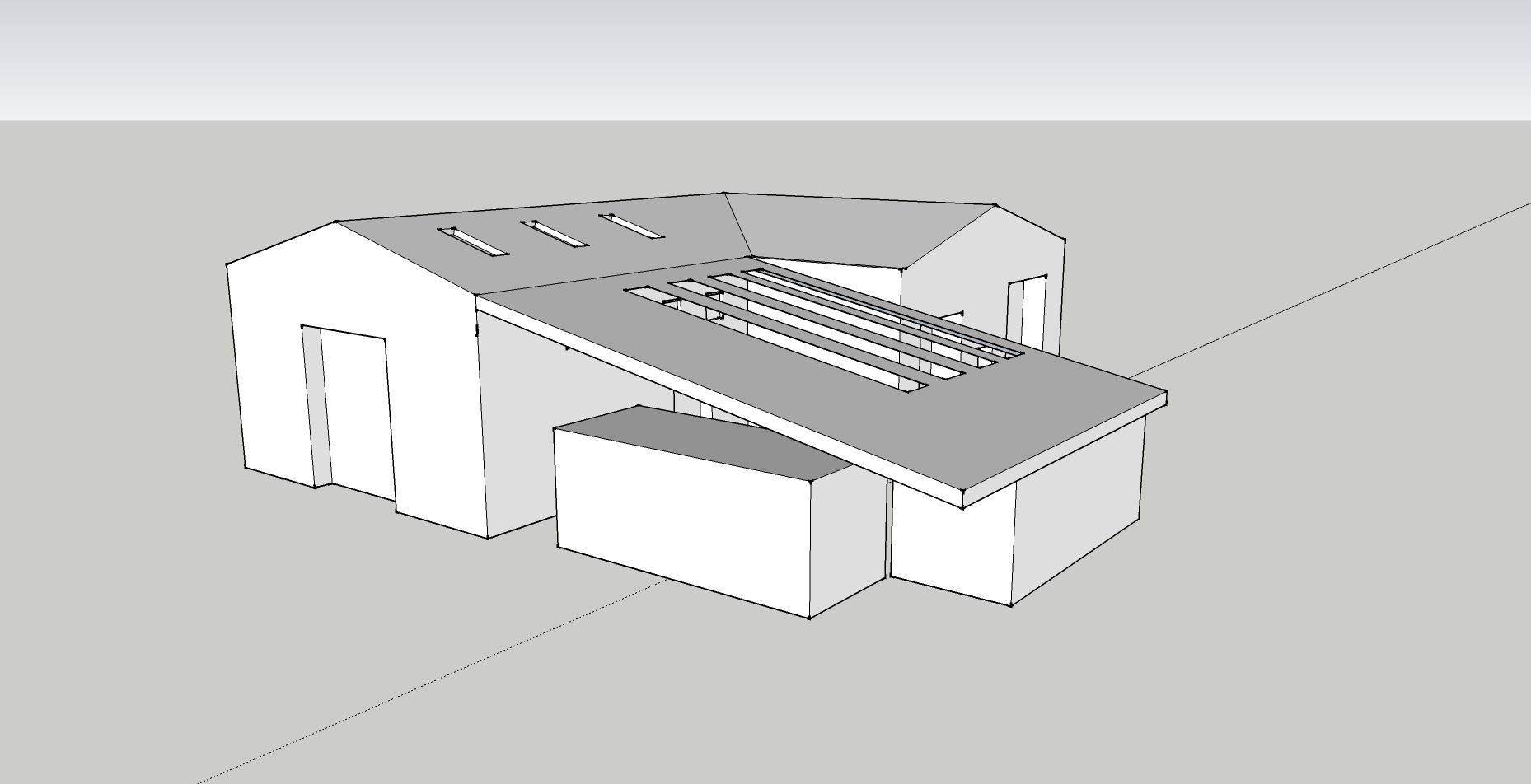

Bought a pair of "one-trip" 20'ers for temp storage after a microburst took out our old barn/loafing shed.
Soon they'll be placed under a shed roof attached to the new barn (actually garage/shop) that's currently under construction. This way they remain 'portable' structures exempt from building codes, and the max sq ft building size limits imposed on our property since it's part of a wildlife conservation area.
Once the project is a bit beyond holes in the ground containing poured footers I'll post some construction pics.
Apologies for my rather crude Sketch-Up skills.

Thanks YD, ttriff definately keep us posted.

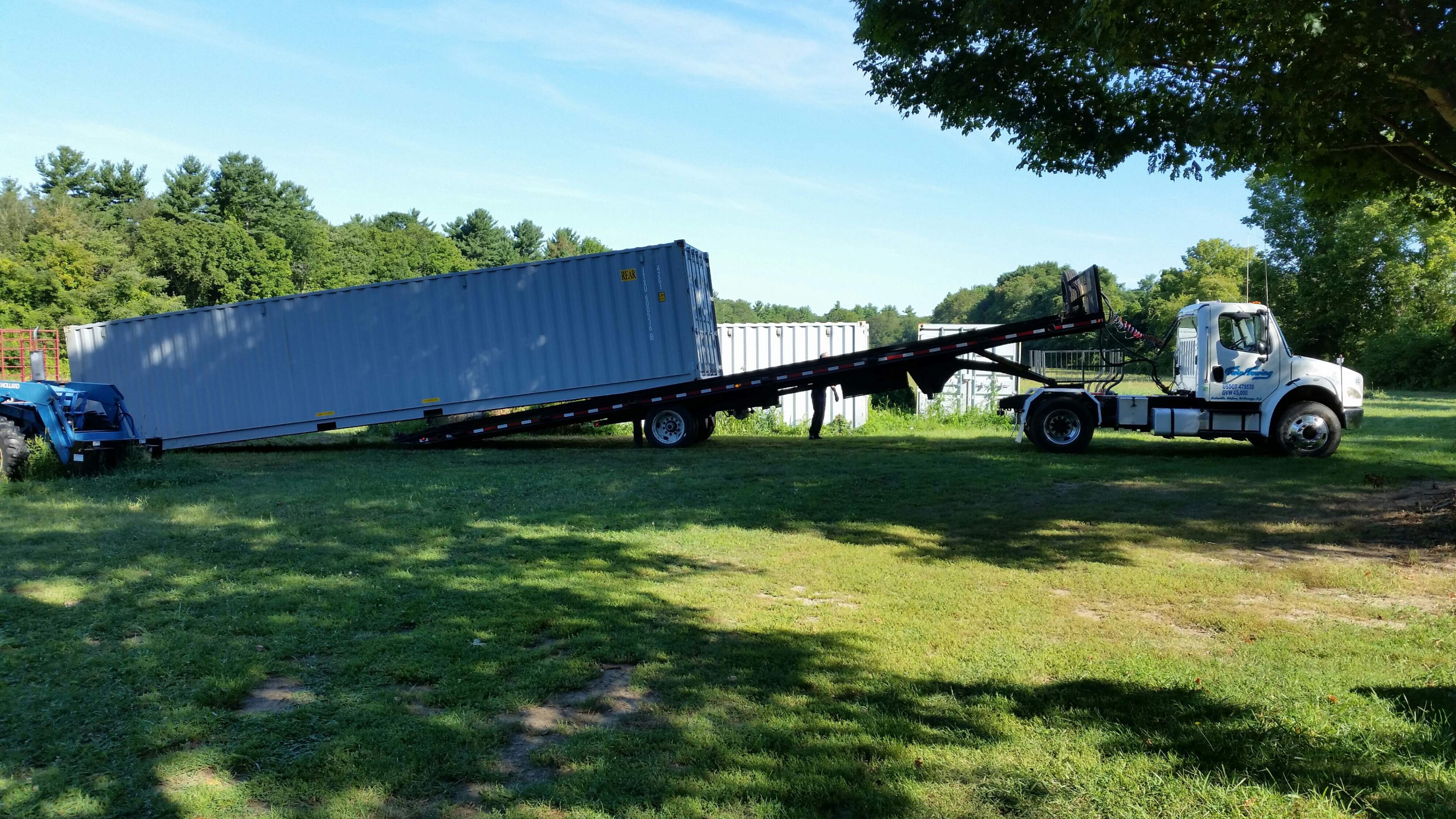

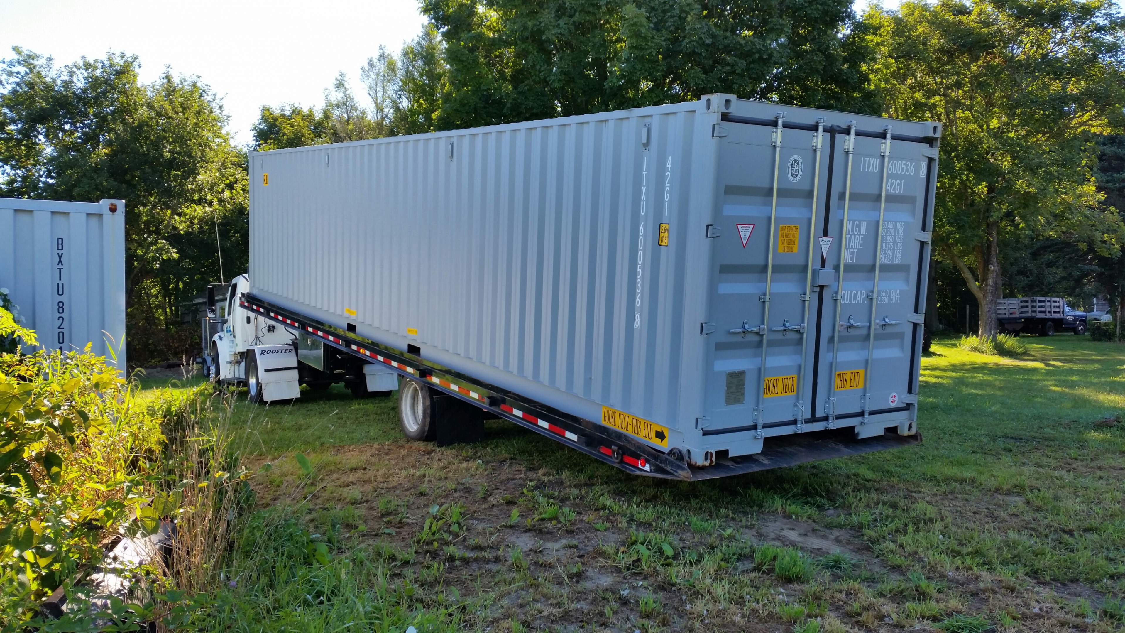

I got a call from the transporter this morning, the 40' should be here Thursday morning.
   / Making a barn out of shipping containers. Any ideas?
#28
The container came in this morning, it is in fantastic shape, as new. Real happy about it!
   / Making a barn out of shipping containers. Any ideas? #29
<img src="http://www.tractorbynet.com/forums/files/rural-living/389105-making-barn-out-shipping-containers-image-jpg"/><img src="http://www.tractorbynet.com/forums/files/rural-living/389106-making-barn-out-shipping-containers-image-jpg"/>
It sure does look new. Very nice.
