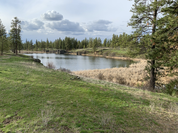

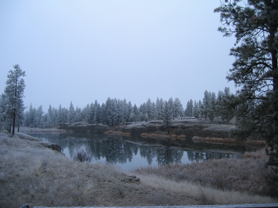

I've had the same extended beaver family on my lake for over twenty years. They graciously took over maintenance of the outlet many, many years ago. They built and maintain a low dam at the outlet. Over a twelve month period the lake level will vary only 8 - 12 inches. Looking West - off my front porch and down the lake. Five acres of open water - five acres of cattails. The lake( Martin Lk) is 80 feet deep.
Same view - summer & early winter.
