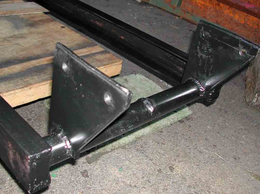

OK, the plan is to use some 1.5x3.5x1/4" channel, which I have salvaged from
a now-defunct tractor dealer. (They were from Kubota shipping crates.)
These main rails will be welded to the lower ROPS bracket in the rear, and
hang from existing holes in the tranny tunnel up under the foward middle
of the tractor. I cut some 1/4" plate for the forward brackets and drilled them.
I plan to attach all the bolted elements to the tractor, position the welded
elements, then tack-weld them while mounted/positioned on the tractor.
Then I will remove all the bolts to do the final welding.

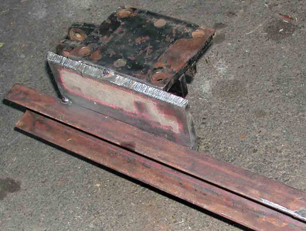

Here is the subframe after I tack-welded it, then unbolted it from the tractor.
I like to use a series of small automotive-type scissors jacks to fine-position the
channel steel before tack-welding. They are strong, secure, and are
hand-adjustable.
The forward section uses some shedule 80 pipe for transverse support. The
rear support uses some 1/2" plate welded to the frame channel, and the
ROPS lower bracket.
The 1/2" plate is the only steel I had to buy.....I never have too much 1/2"
plate lying around. I bought a 4' long chunk of 4"x10"x 1/2" angle steel
as the salvage yard for .35/lb, or about $35. Part of that is for the hoe-half
of the subframe, coming up.

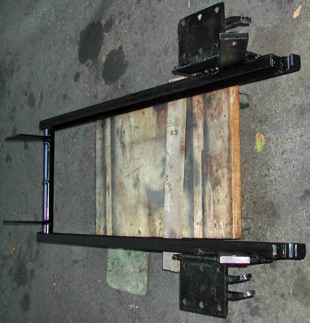

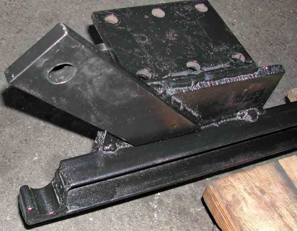

   / making a subframe for my 01 John Deere 4300 and Prairie Dog backhoe attachment
Here is the tractor-side of the subframe all welded and painted.
On the forward supports, I boxed in the channel for strength.
On the rear, I added some 5/8" bar at 45-degrees to the channel. This will be
the only place where the subframe is bolted to the hoe-side subframe. I drilled
the 1" hole first, so I could use my drill press. These holes will have SAE
grade-8 1" bolts. (Sadly, hardware stores around here no longer carry one-inch
fasteners, so I had to go to Fastenal.)
Below the bolted element, I made a cradle in the channel to support a 1.125" guide
pin. The hoe-side pin will rest in this saddle, and the hoe will pivot upwards to align
the bolt holes. It will be clear in later photos.

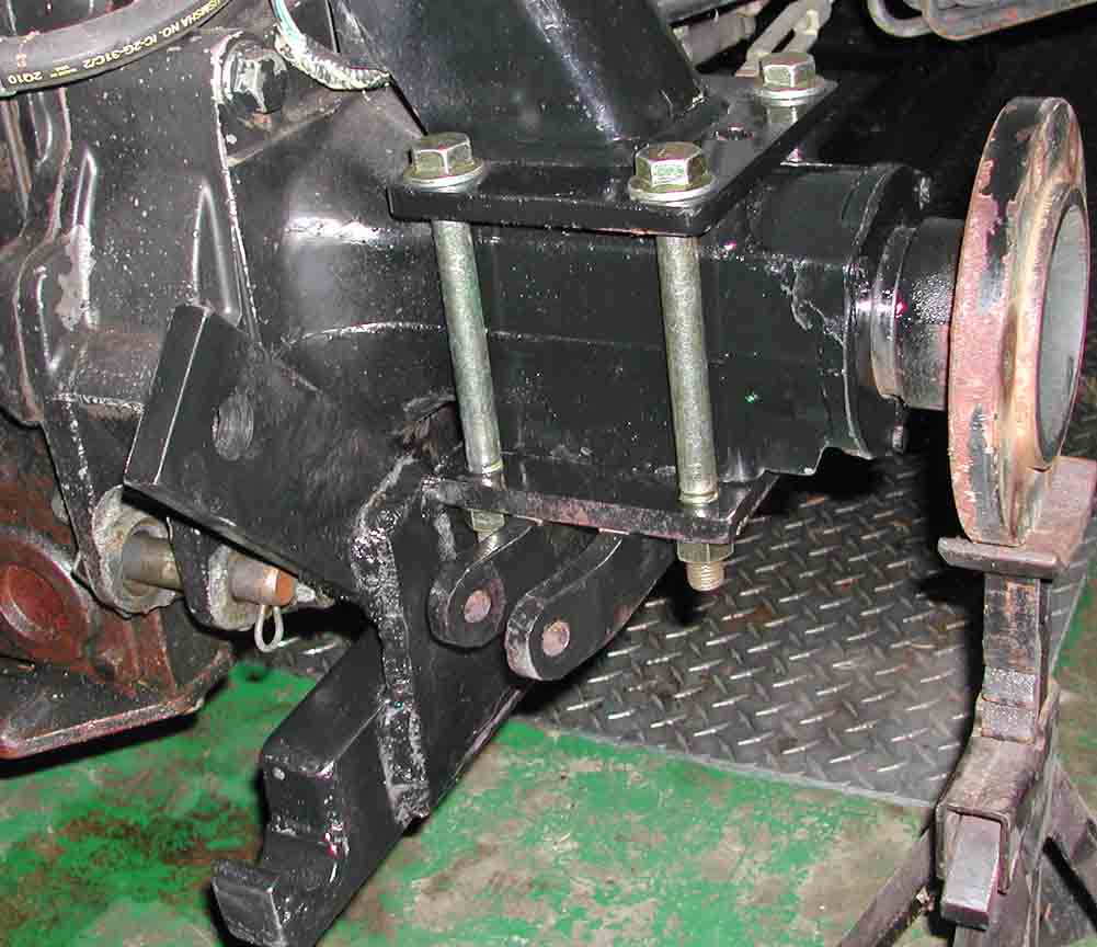

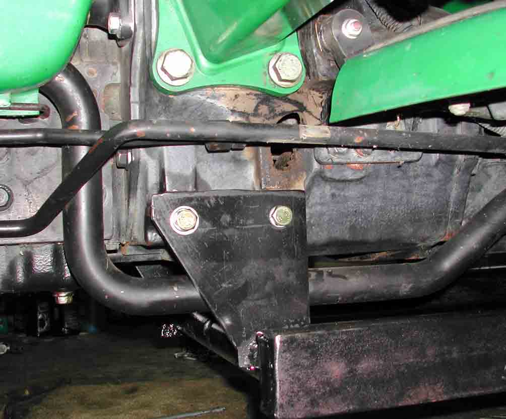

Here the tractor-side subframe is mounted to the tractor.
The forward section uses existing holes in the tunnel casting (after
cleaning out the threads. Unfortunately, the undercarriage armor
in the rental service kit interfered, so I had to toss it. The frame
rails provide substantial protection themselves, however.
The rear attachment shows the ROPS bracket connection. Note
the new bolts; these are critical and the original ones were rusty.

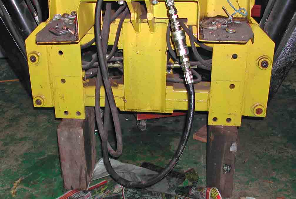

Now for the hoe-side of the subframe.
I positioned the hoe at the operational height I want using the two 4x12
wood blocks. I also have my overhead crane supporting the boom for the
correct tilt. I connected up the tractor hydraulics so I could operate the
outriggers for the correct height. I want this to be pretty exact, so I
am not going to count on hydraulics to keep the hoe in position.
After that is all set, I will back the tractor up to exactly the place I want.

I aimed for a 1" clearance to new tires. I trimmed the step a bit, and achieved
a slightly closer mount than the last 4300 subframe, due to the 3/4" additional
wheel spacing I got from reversing the rear wheels.
I made a mount for a new seat, and was off to the races.
