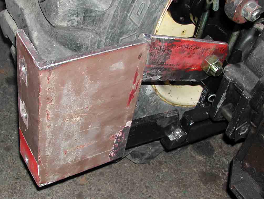

This is how the lower part of the hoe-side of the subframe fits into
the saddle seen above.
I used some 1.125" rod, which fits just about perfectly inside some
schedule 40 steel pipe, size 1.5" I think. I cut some 2" pieces of this
pipe the long way to make the saddles. This is how I made the saddles
for my Kioti subframe, too:
http://www.tractorbynet.com/forums/build-yourself/95092-yet-another-custom-backhoe-subframe.html
This design is simpler, however. I will not use any bolts on the lower
part of the mount.

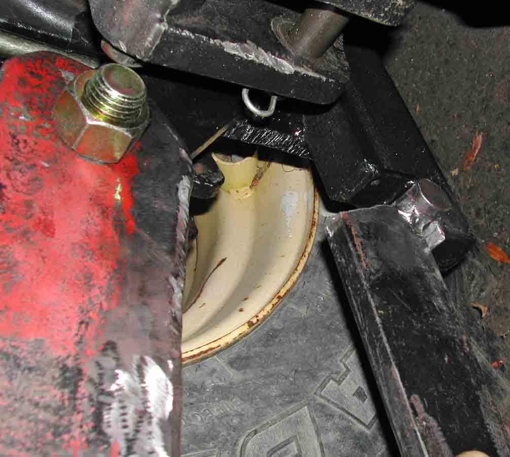

   / making a subframe for my 01 John Deere 4300 and Prairie Dog backhoe attachment
#15
In this series of pix, I have completed the mockup and tack-welding of
the hoe-side elements. With the hoe unbolted and moved away, you
can see how everything goes together.
Next, I will do the finish-welding and paint everything before re-attaching
to the backhoe.
You can't see it, but I welded anti-turn tabs on one side of each side plate
next to the 1" nuts. This allows me to tighten the bolts with just one
wrench; getting 2 wrenches in there can be difficult. This is superior
to just welding the nut to the plate because it gives just a bit of play. The
holes are drilled to a tight tolerance.

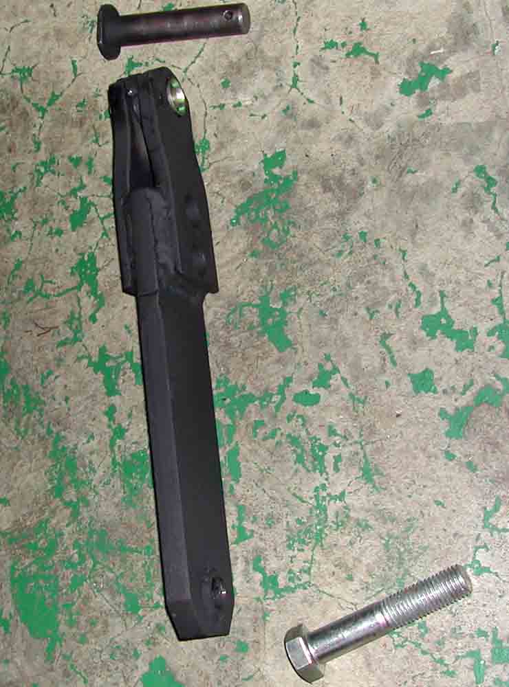

The last thing I had to fabricate is a toplink. This is not absolutely necessary,
but it will add a bit of stiffness without overloading the toplink bracket. I made
an 11/16" pin to take up the slop in the toplink bracket holes so it fits pretty tightly.
Stiffness in the subframe is very important; flex leads to worn bolt or pin
holes, and eventual metal fatigue and cracking. But don't believe me; just
look at the subframes on serious, purpose-built backhoes. These subframes
feature no visible flex in the frames.
Careful observers will see the similarity of my toplink to a Woods 3-pt enhanced
toplink. I have a bunch of these, so I shortened one up and welded it solid. It
is over one foot shorter than the standard 3-point toplink. Sadly, I ran out of
gloss black paint, so it is flat-black. The show must go on.

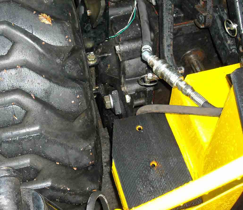

#18
And here is the final result.
I mounted the hoe as close as I could to the tractor. My tires are about 50% worn, so
I aimed for a 1" clearance to new tires. I trimmed the step a bit, and achieved
a slightly closer mount than the last 4300 subframe, due to the 3/4" additional
wheel spacing I got from reversing the rear wheels.
I made a mount for a new seat, and was off to the races.
