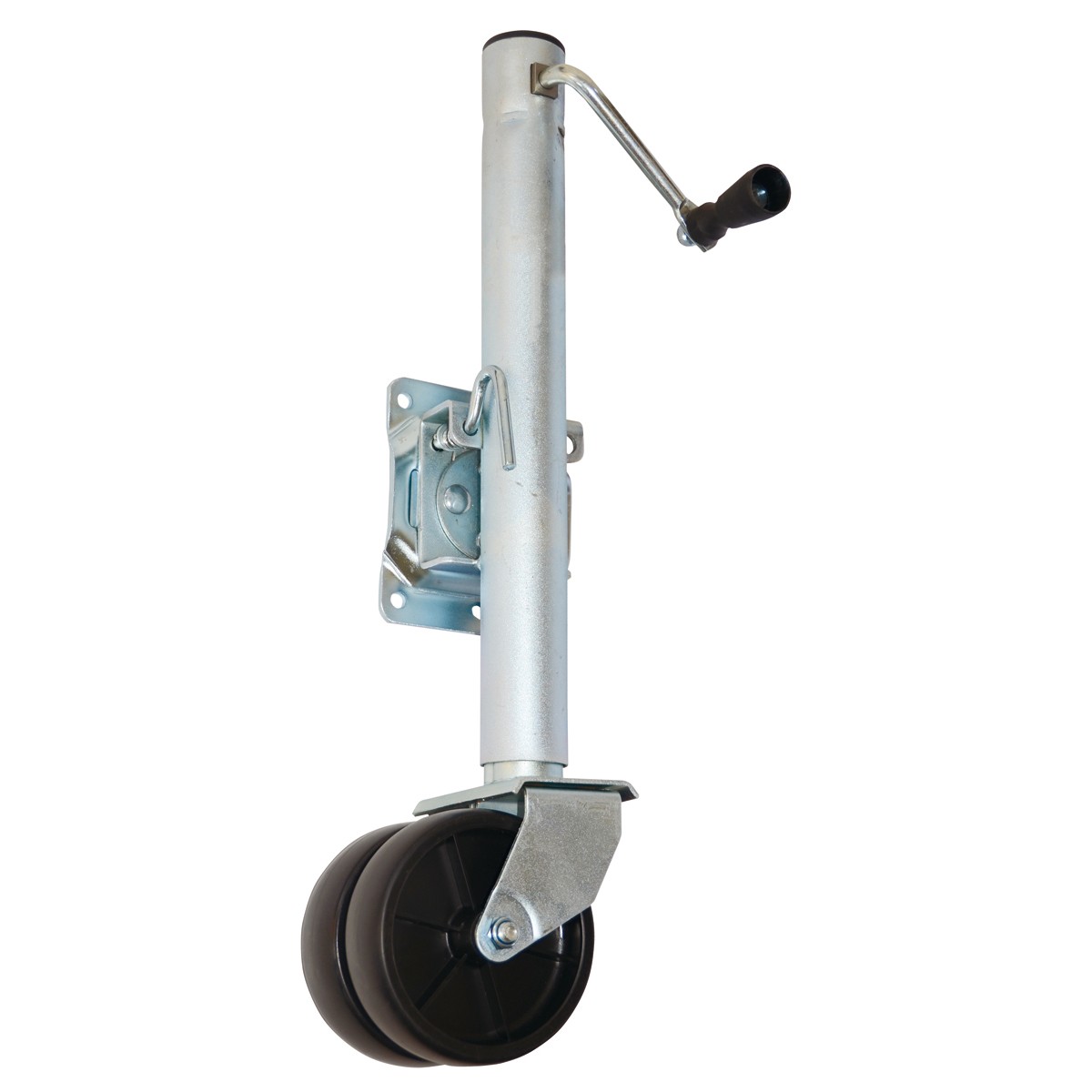

How about getting a trailer dolly to help move it around with?
6 lb. Heavy Duty Trailer Dolly

I also have a 5.5x10' two wheel trailer with 2x8s for wood. It is heavy to maneuver around. What I did with that was bought a Harbor Freight Hitch Dolly.jpgitem #69779 1500# capacity swing back dolly. Mount it to the hitch and when you unhook it from the truck you can just push the trailer around because the hitch is on wheels.
