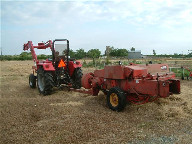

You can do it. People have used small tractors like a Farmall Super A to pull a 2-twine small square baler like a JD 14T or like the one I have--a Massey Ferguson 124.
Here's what I use on my 10 acres (flat pasture)
Baler--MF124 2-twine small squares - $2000 (bought it right out of the field-previous owner baled 30 acres the day before)
Sicklebar mower--MF 31 (7 ft)- $550 at auction plus $200 new parts
Rake--JD 350 pto driven, 3pt hitch style - $800
Here's a YouTube video showing a Farmall Super A operating a small square baler. The baler sequence starts around the 5 minute mark in the video.
[ame=http://www.youtube.com/watch?v=Cvz8-Sw1ntA]FARMALL Super A - YouTube[/ame]
Pretty impressive considering the Super A has about 16 pto hp:thumbsup:. I would guess the fellow in the video has an over running clutch (ORC) installed in the pto drive line since the rear pto is driven directly off the transmisson.
You should have no trouble haying with your 30 hp tractor.
Good luck

You really want to check out very carefully any baler you're considering buying.
Stay away from balers that have been "field stored" for any length of time unless you or someone you trust with baler experience can estimate the cost of getting it running properly. Your best bet is with older balers that have been carefully serviced and shedded.
Parts for some old balers can be expensive and hard to find. That's why you often get advice to stick with used JD or NH balers. For example, the linings on slip clutch on the pto drive of my MF124 baler were shot. Fortunately I found new parts from an MF dealer in Maine and the price was reasonable.
Get the operator, service and parts manuals for whatever baler you finally purchase. Setting up the knotters is a lot easier with that documentation.

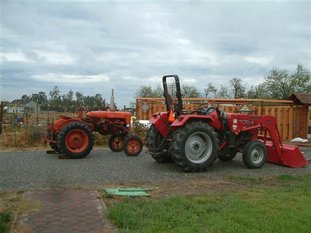

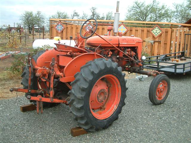

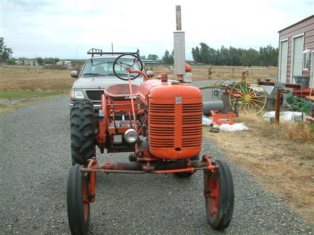

One of these days I'm going to hook up that MF124 baler to my 1951 Farmall Super A just for grins:laughing:.
MF124 baler and my 2008 Mahindra 5525 (54 hp engine, 45 hp pto)
The 1951 Farmall Super A vs the 5525
