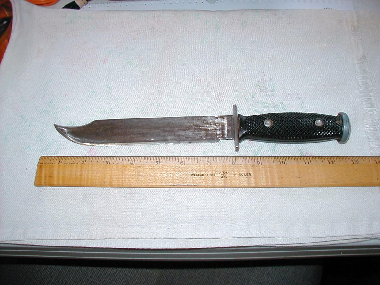

My parents moved to Alaska in the Fall of 1965. Someone gave my Dad a heavy piece of an industrial hacksaw that simply had a lot of black electrical tape wrapped around one end for a handle and then one edge had been sharpened for skinning moose and caribou. Dad said it was hard to sharpen, but when sharpened would hold an edge better and was a better skinning knife than any store bought knife he'd ever tried. I wish I had a picture of what looked like a piece of junk, but I don't. Anyway, in the mid-70s Dad gave it to me. I really had no use for it, but a neighbor friend took it and worked on it. I still have it and the photo is what it looks like today.

wow! nice!

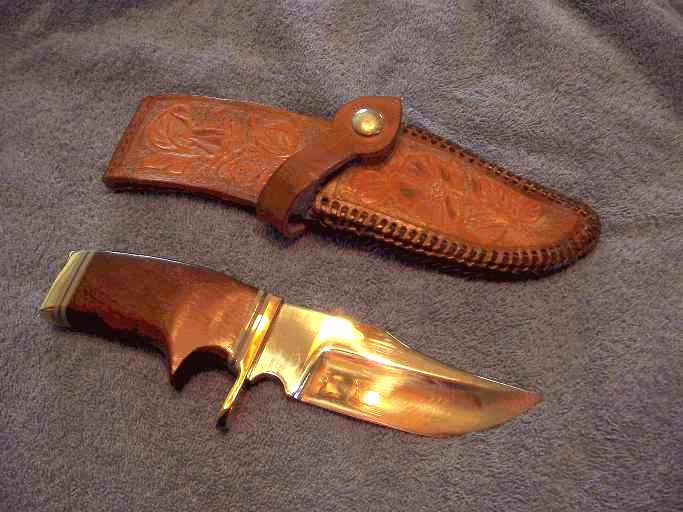

I made this knife from a file. I made the sheath for it also
