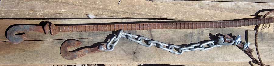

Look up "black smithing" on the web. I don't have it book marked, he goes into tempering and most all forge work.
RR spikes are a step up from mild steel, will make a good knife that holds an edge. Early "Buck Knives" were all made from old files. The plant was just up the street from my business in "El Cajon CA". Stopped in a few times and watched them work
In refference to the earth forge, a forge does need a grate to hold the fire on and allow air to blow through it.
If you build a forge out of a barrel or water tank, weld a 2" pipe "T" under the grate area, put a sliding gate on the bottom and a short pipe going out. Attach a flex hose to it. The gate will let you control air flow and clean out coals that fall through.
My old forge is still a hand cranker, sure keeps you busy, cranking & forging. Will put a vacum on it some day.
Will be posting and article with pictures on forged hooks, "T" hooks and other fun toys.
