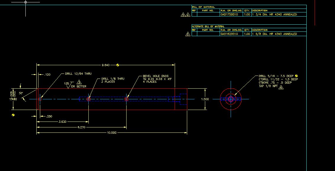

pin.JPGAgree with MOwens. 4340. Here is a sample pin we use for industrial applications. About as severe as you can get with abuse. They hold up well.
