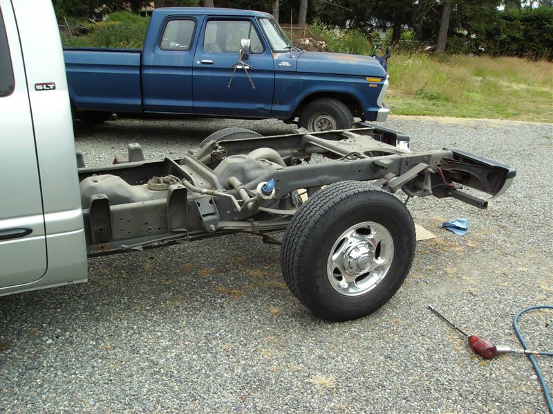

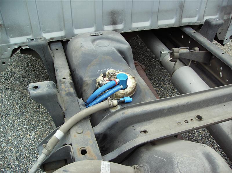

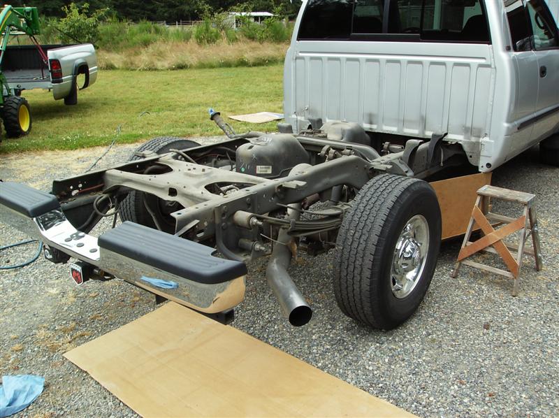

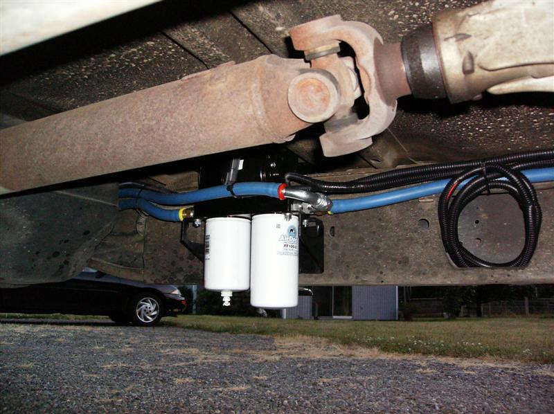

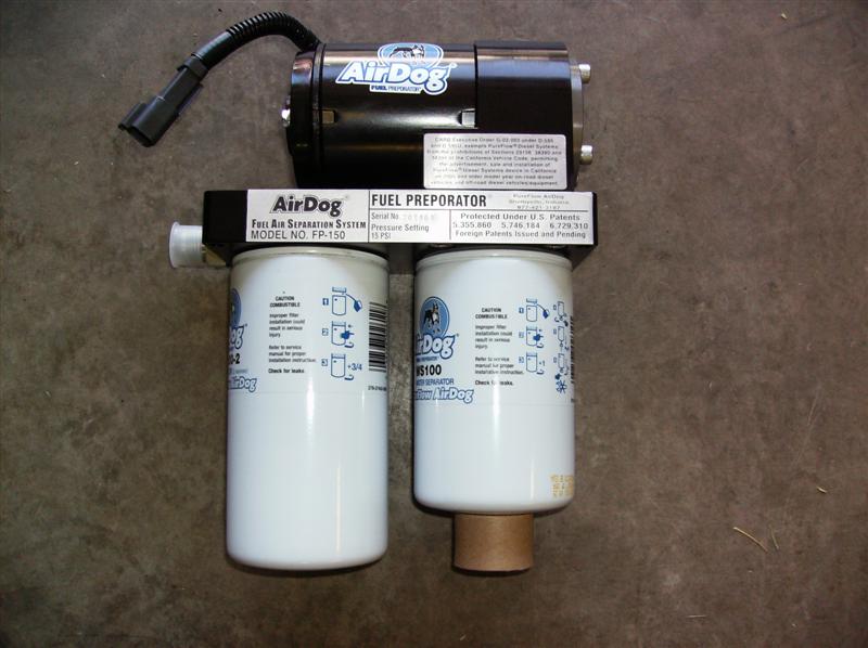

When I upgraded to a Airdog 150, I pulled the bed off instead of dropping the tank. Was quite surprised how easy it was.
I'll have to agree with pulling the bed. I had to drop the tank on my '96 dually, to replace the brake line that runs up behind the tank. Those connections are a PIA to unhook. At least were for me, as I wasn't sure how they worked, or a good view to figure it out. Finally got it, but not after giving some engineer somewhere, a piece of my mind.

Pics.

Willl, nice photos. Do you have an idea how much that bed weighs? Is it something 4 people could pick up and lift off? Is there just a few bolts that hold it on? It looks like once the bed is off, its an easy job.

Great pics!
That Ram looks to be in very good shape. That'll be a 500k mile truck for sure!
