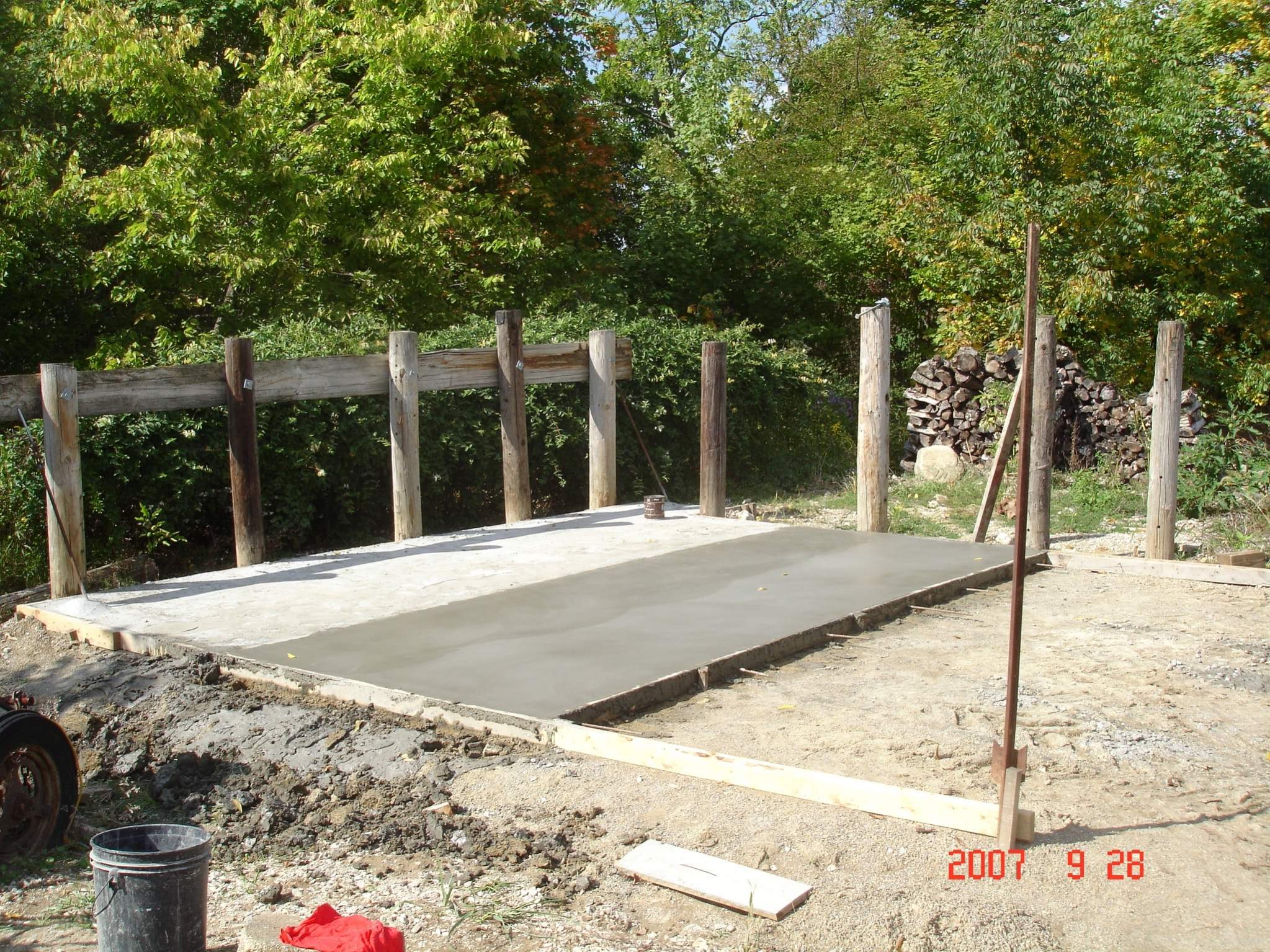

Here are a couple pictures of one I made. One in the construction phase, and one, in the finished stage. I too got tired of wallering in the mud, once into the pile.
I made mine two sided, so as to make a 1/4 turn with the Bobcat, and go to the spreader. I clean 4 stalls, and this will hold 6 months worth, even with the straw. Overtime, the rain will "melt" the pile down, and I restack every now and then with the Bobcat. I have a 100 acre field directly across the road, that the farmer is more than glad to let me spread there, and build humus up in those old clay knobs.
It doesn't say where you are from, but most State University Agricultural sites have plans for these. I got mine from the Ohio State University site, although theirs shows a 3 sided one like you want.

Hmmm, LOL..., Good question... I'm thinking 18' X 20'.
No worries, it happens to us all:D I have a couple of empty slabs sitting in one of my fields due to two old buildings falling down. Making one of them into a manure crib seems like a good idea. One is already cleared of debris, the other still needs the cinder blocks and roof rhauled away. Your pictures have given me a good idea however:thumbsup: Thanks!
Hawk

You've got the hard part done... As you can tell, the posts are pieces of telephone poles, and the sides are 2" pine Dad sawed out years ago, except the bottom piece. They are salvaged creosoted bridge 3 X 5's. Preservative on the pine, used motor oil, cut with diesel.
I put a 2% slope to the corner where the boards meet, so the "juice" would run to that corner. I also poured a weak mix around the back outside, to keep the groundhogs from digging under.
As luck would have it, there was a groundhog hole about 4' from the back corner, so I made a trough in the outside pour, directing the flow to that hole. My purification system/groudhog eliminator. Almost 4 years now, and still working fine..!! :thumbsup:

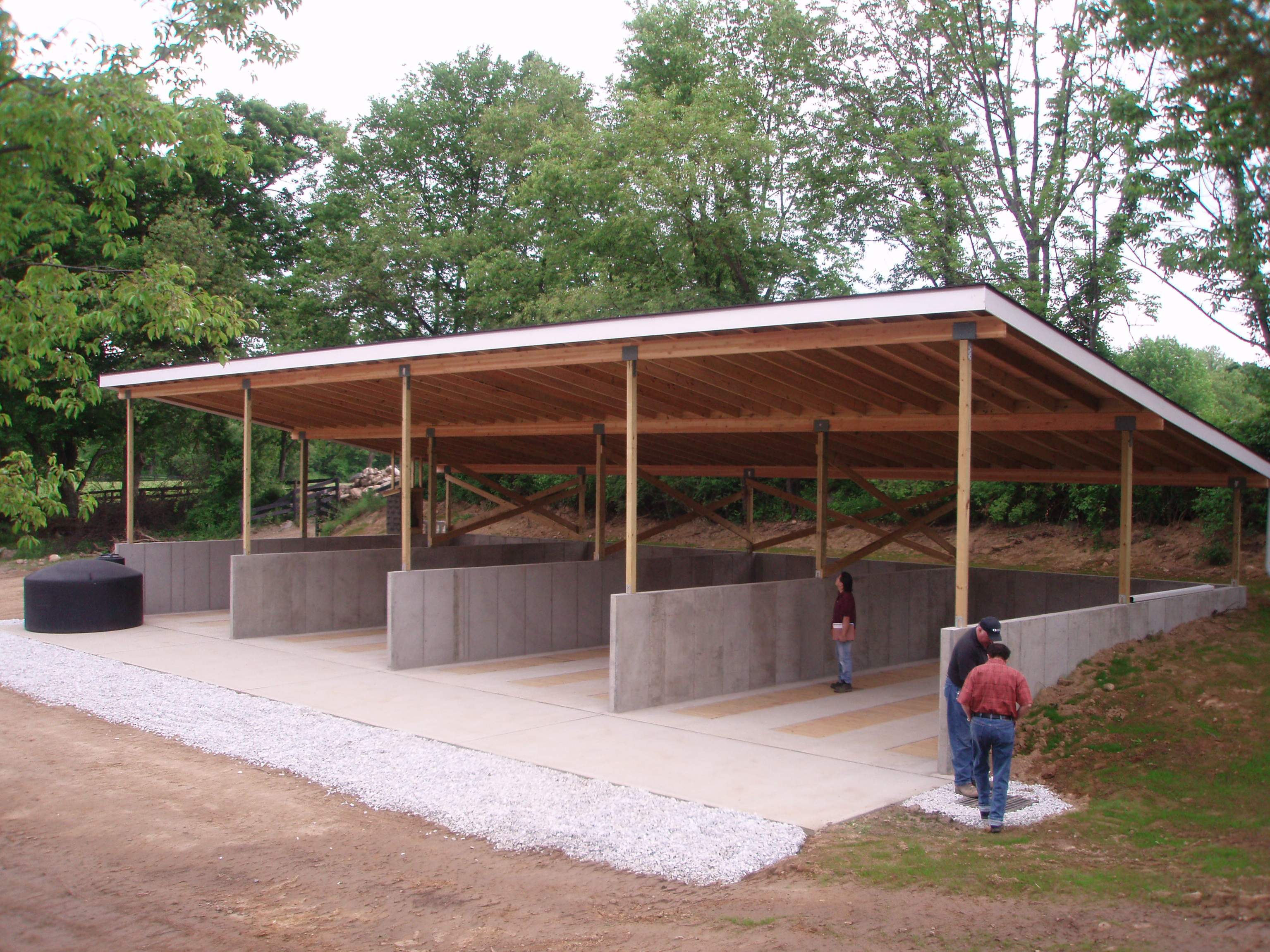

Well, I did it... 10X25 pit slab, four foot high walls, 3 inch holes in the bottom of the wall and a french drain around the perimiter, sloped to back and a sidewalk to the barn.
Partially backfilled before the rains hit, but at least we can get manure into it.
Hopefully this will be a "forever" solution.
