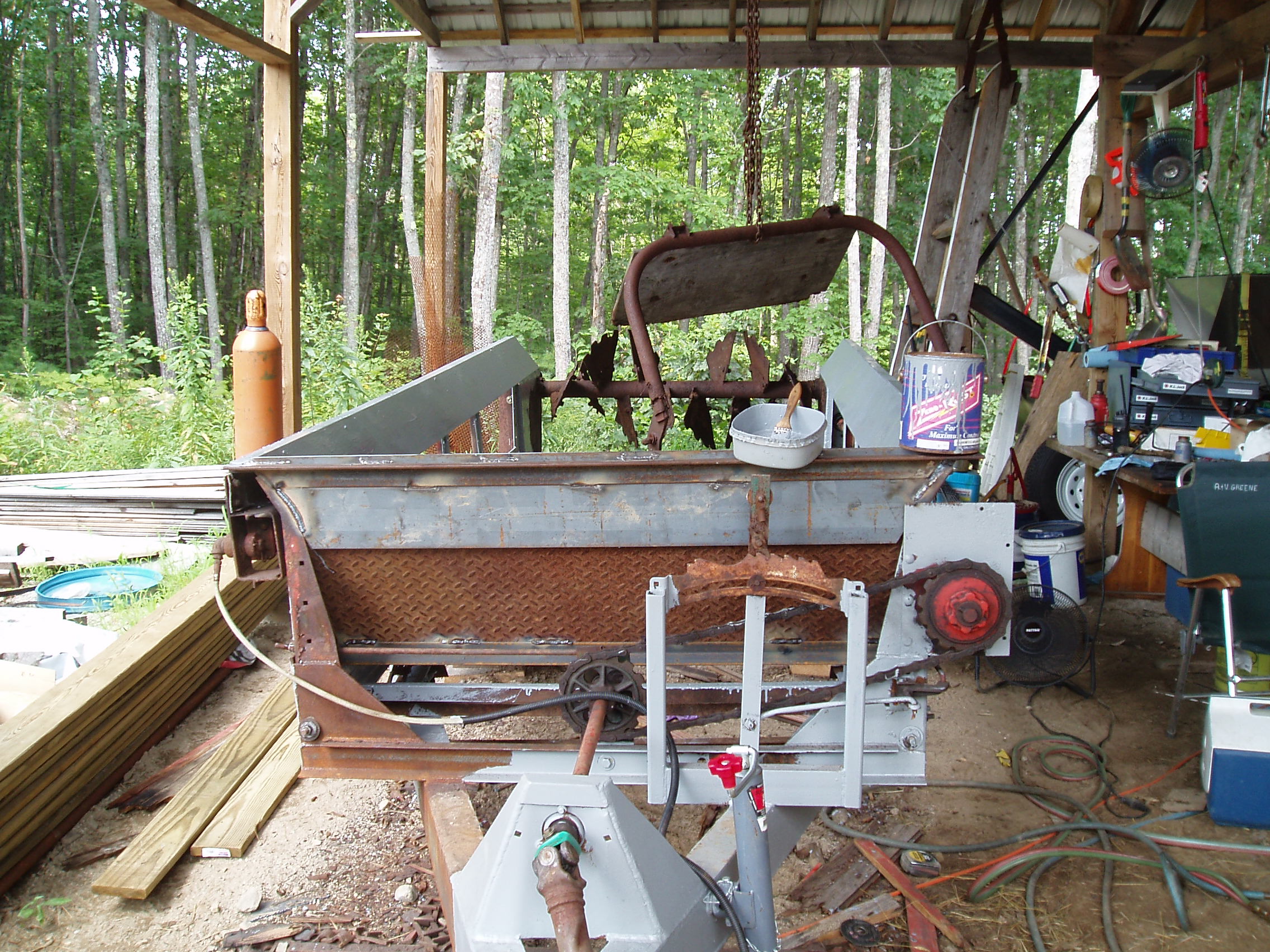

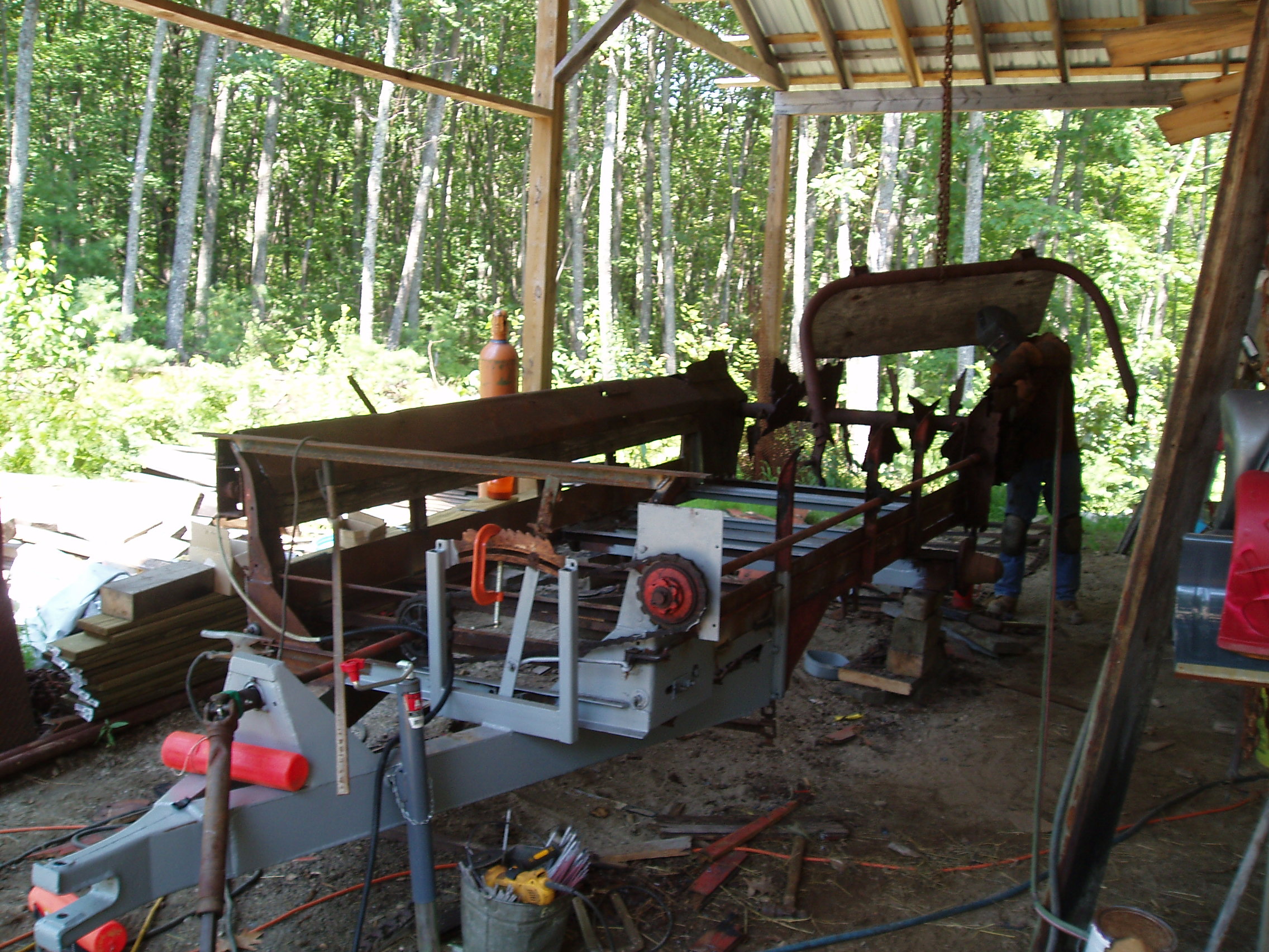

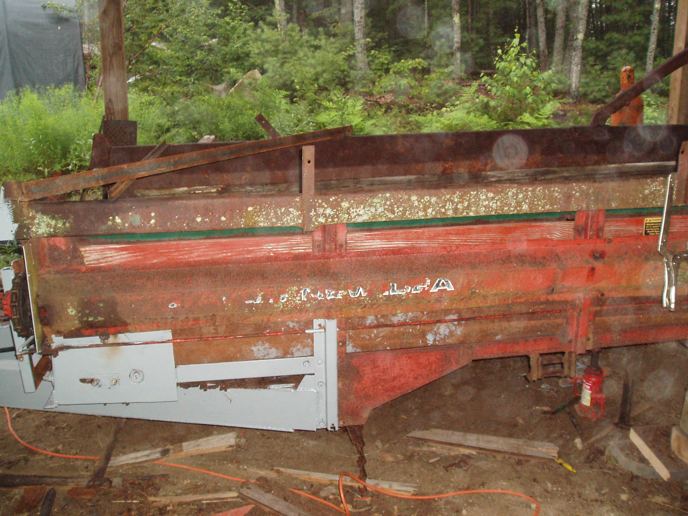

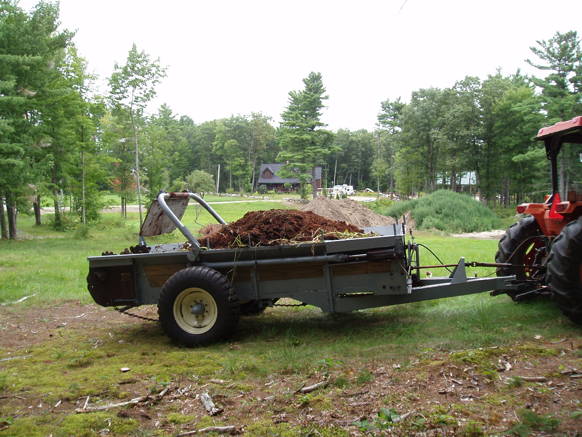

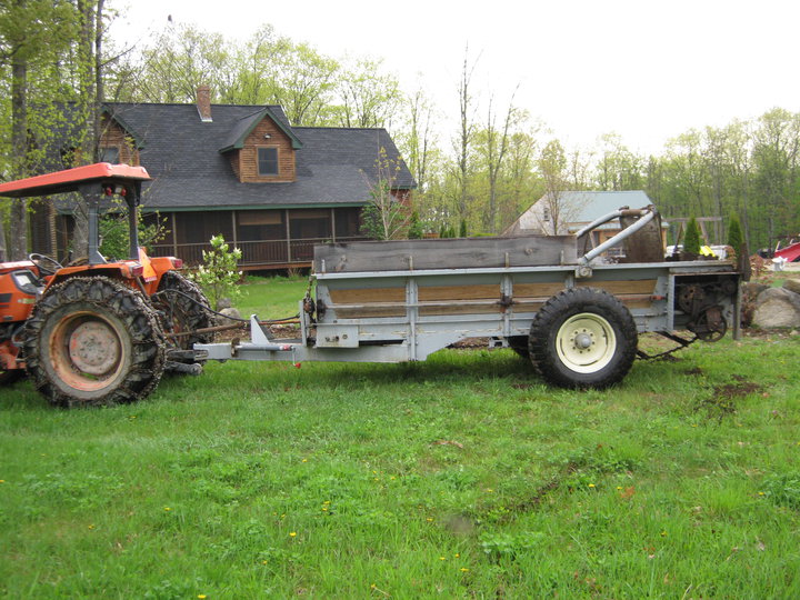

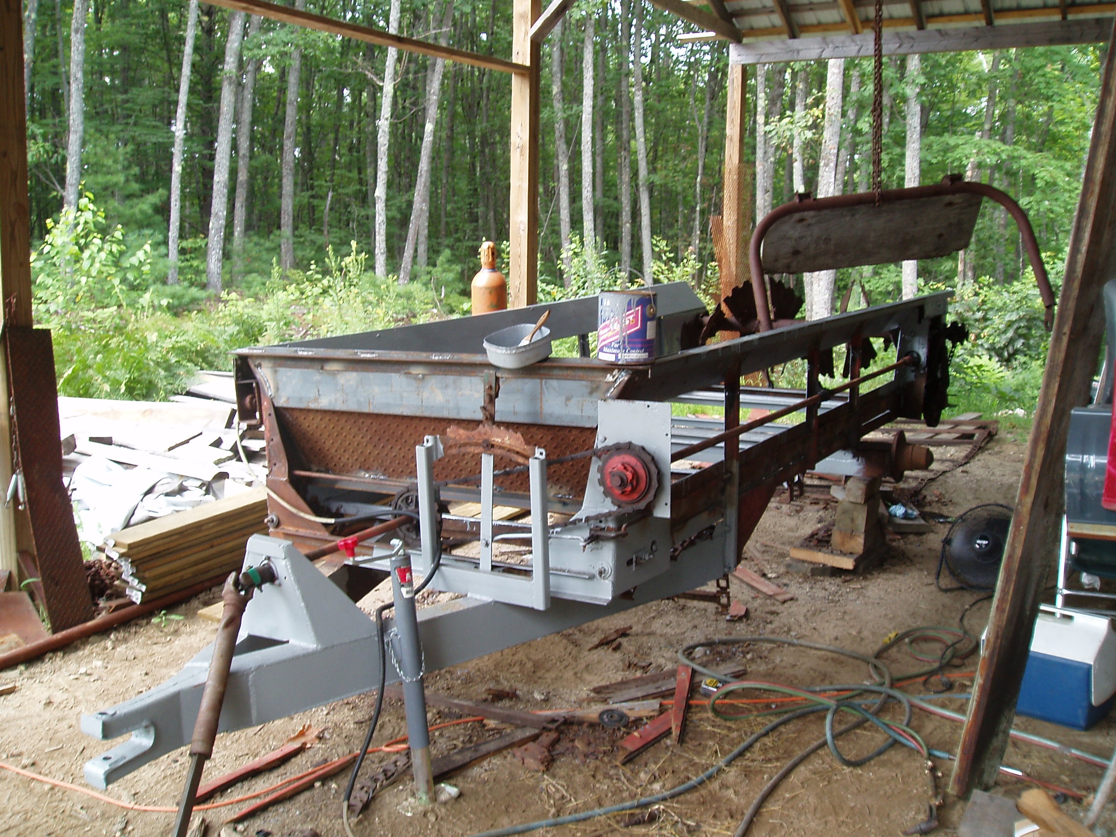

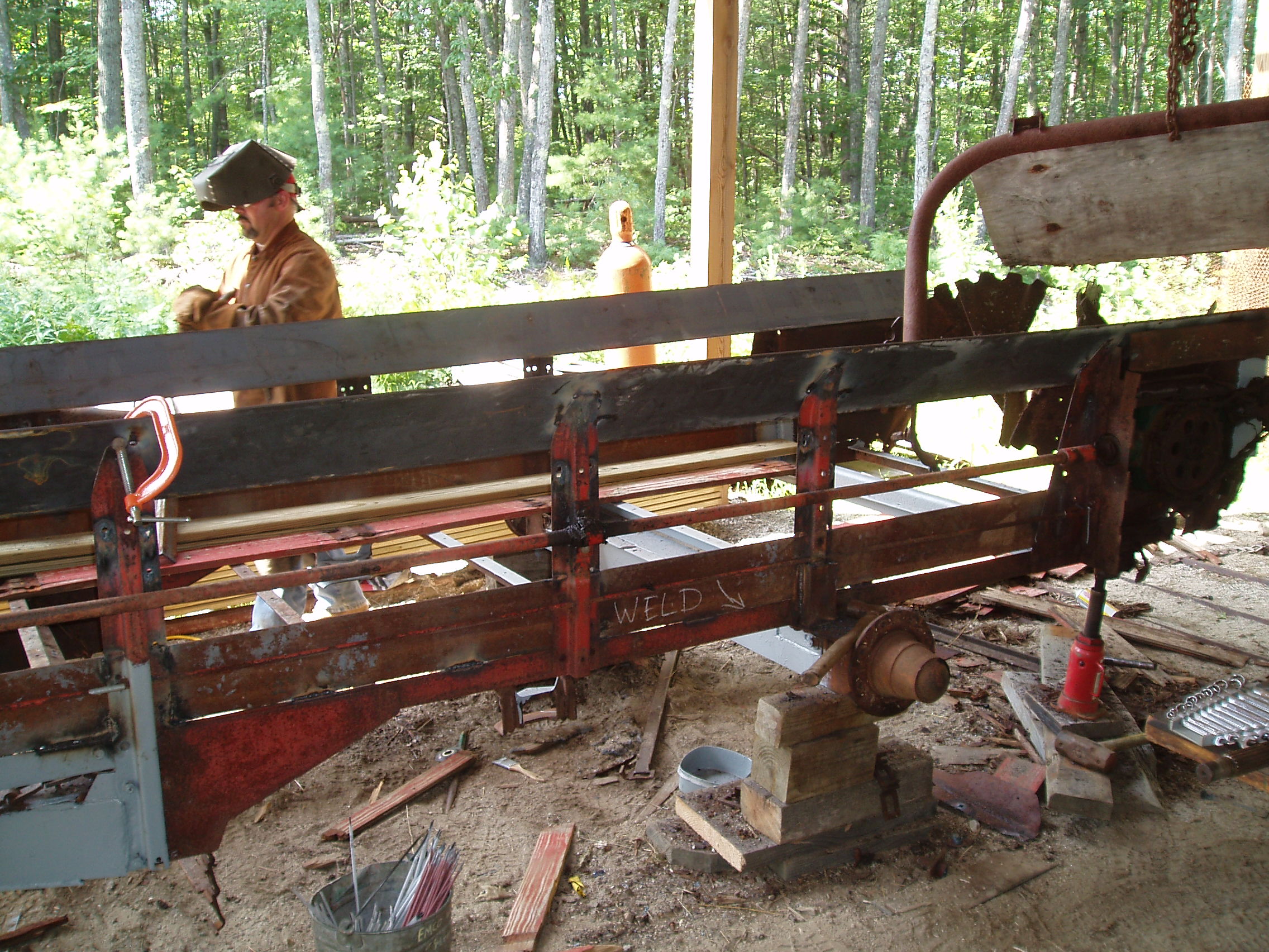

I had to have new spockets cut for mine. Eastern bearing in Portland was able to have some flame cut for my shaft size. Took a little time, but for what I'm doing with it I didn't need anything special.
Here's some pics of my overhaul. Took some work, but well worth it.
