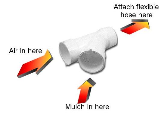

For the amount of mulch that you want to carry...
A narrow cart was specified for going through gates, so it will have to be long or tall, not wide. Also, low cost was mentioned. /forums/images/graemlins/wink.gif
The weight of the mulch in a tall cart would compress it at the bottom of the cart, where the feed mechanism would have to be if you want unmanned operation. This might cause jam ups without some sort of expensive conveyor or auger mechanism. I think you will need a two man operation, or make multiple trips to the mulch source.
I'd figure out how to use a wye pipe as a venturi for the mulch. Run the blower into the upstream straight end and feed the mulch down the upstream wye. The air blowing past the upstream wye should suck the mulch in pretty easily. Then you'd need some sort of flexible pipe on the downstream side of the wye to dump the mulch where it is needed. The blower could be made to attach and detach easily so it could be used for other things. You could try this very cheaply with a trip to the plumbing supply store, a leaf blower and some duct tape. See attached for what is in my brain. /forums/images/graemlins/shocked.gif

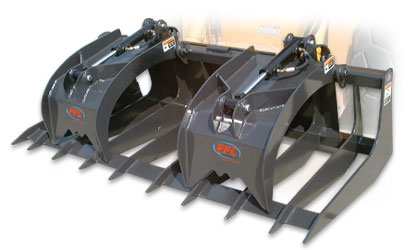

I would also like to see a rock rake that is multipurpose in nature. I can dig up rocks and dirt and the dirt would sift out. Additionaly, I might use it to pull up some shrub roots.
Also, a nice attachment would be a grapple that could be removed. This way someone might just want to buy the rake and not the grapple. Or, someone might want to use just the rake and if you took the grapple off, you would not be hindered by it's extra weight.
Here's something that is like what I am talking about.
