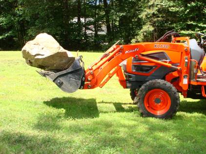

First try with my Markham toothbar. This toothbar allowed me to scoop up rocks I could only pick up with a grapple before. The picture shows the large rock I couldn't grab with the loader bucket before and now I am able to get under it get a grip on it...
Bruce
