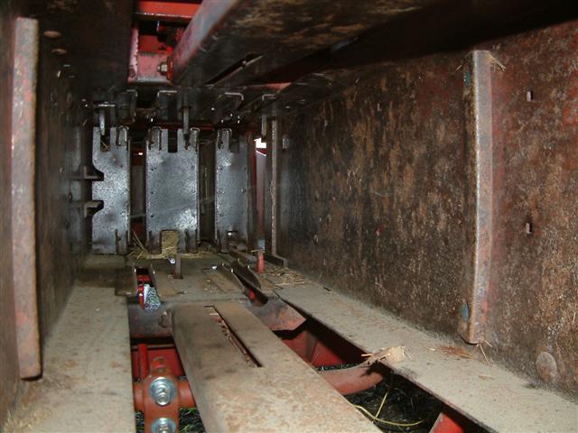

I need help. This may be the wrong place to post this but I am going to take a shot. I have a old massey 124 square baler that will not bale with the twine tight on the bales. I have done everything that the operators manual suggest with no luck. I have cleaned out the bale chamber and even replaced the trip cogg. The bales look fine and are uniform but the twine is not as tight as I would like it. The twine is tight enough to pick the bales up without falling apart but not as tight as I have seen on other balers.

Sounds to me like you're losing compression on the bale flakes while the plunger is packing hay into the baling chamber. I assume you've cleaned the hay out of the 5 hay dogs in the baling chamber. How about the springs on the dogs? If they're worn out, you'll have problems packing the bales properly.
Have you installed the wedges in the baling chamber? You can install up to three pairs of wedges to minimize bale decompression. The guy who sold me the 124 only had one pair of wedges. I fabricated two more pairs using scrap angle and bar stock.

Thanks for the tips. We have checked the springs and cleaned the hay out of the dogs. We have not installed the wedges. We will try that next. When we try to increase the compression the baler starts braking shear pins. Thanks again for the tips.

One other thing--I would reduce the pto speed and increase your tractor ground speed. Idea is to increase the amount of hay in each flake. With more hay in the bale, it'll be heavier and when it decompresses after the twine is tied, the slack in the twine may be reduced to what you want.

These wedges install in pairs on the side walls of the baling chamber and help keep the bale compressed while the plunger is recycling for another compression stroke.
