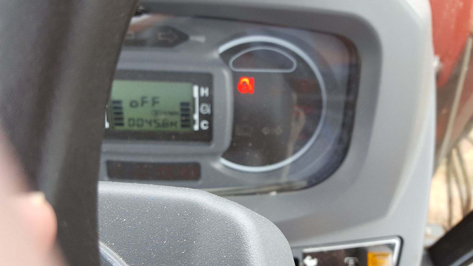

Well updated from last year. Overheat is still there. 650.00 and a 50 hr. service, I was told it was fixed. Well folks, it is not. Nobody can give me an answer. My rep retired and now mum is the word.
Remote valve is disconnected so I can rule that out. I was cutting my yard with 3 to 6 in. tall grass and the trans oil is broken down is under 6 hrs. Temp outside is 85 deg. The soot light comes on and after a few minutes goes off. Run it a little bit and the light is back on. Massey has put as many hours on this as I have.
I really need some help folks. 20180429_134840.jpg20180429_134840.jpg20180429_134840.jpg
I really need some help folks. View attachment 551631View attachment 551631View attachment 551631

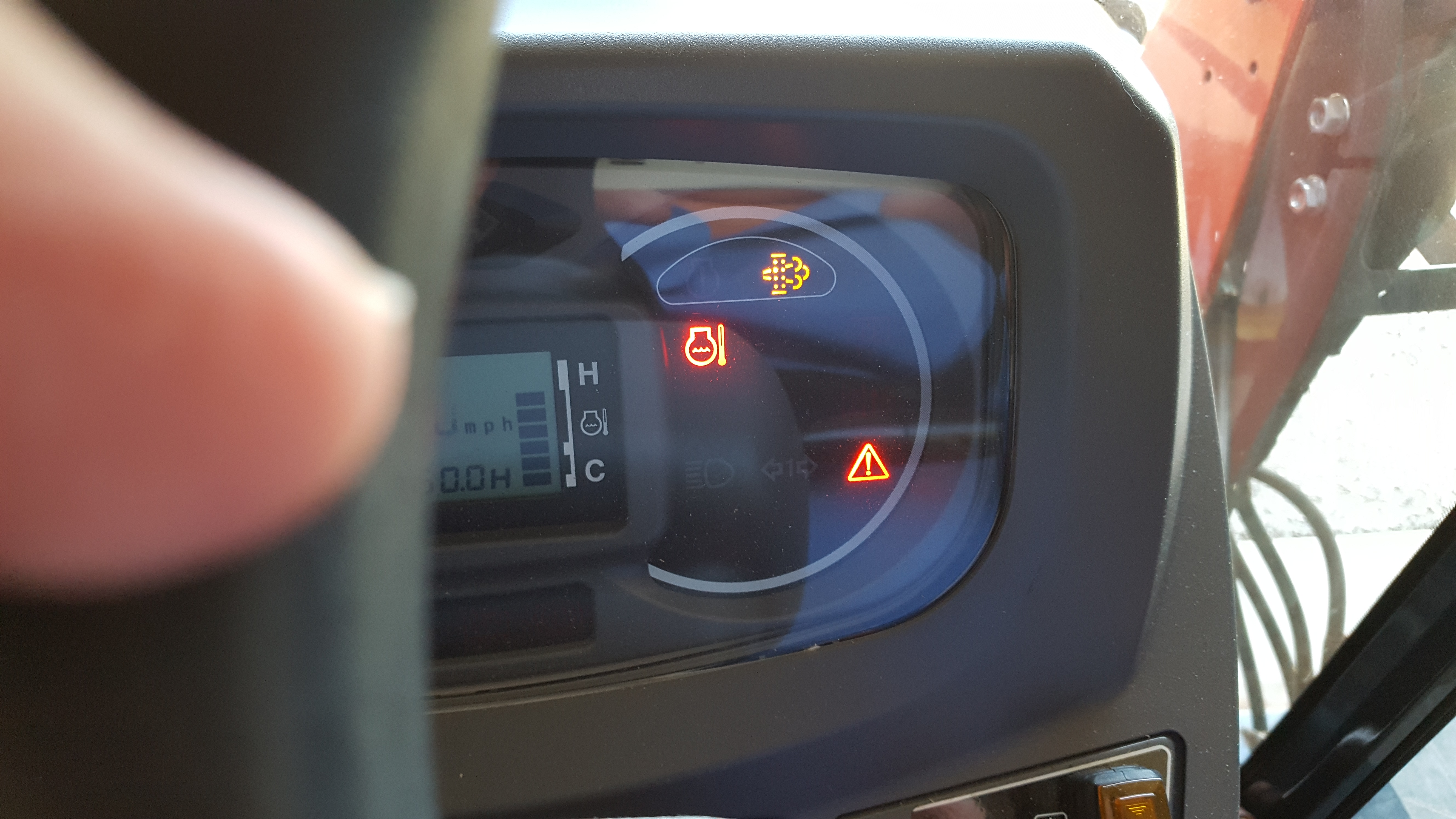

Resized952017092495145332.jpgResized952018042995134840.jpgHydrostatic fluid. The questions have been asked. rep is checking press. next week. My old tractor had a cooler on the back with a fan. Was told it did not need it. It is now in the 80's. What will it do if it gets in the 100's?

Well I have some good news. 2 people from Massey came and spread the magic pixie dust and so far no overheat. The hydraulics work great (first time). It squeals a smidge when you first take off in high gear. It also appears there were corners cut on the 50 hr. service. So I am going to change all the fluids myself ( I will have the oil butler do it as I am disabled).
I think I want to go full synthetic all the way thru. I am looking at the Chevron 1000 THF and rotella synthetic 15w40 because I am in Texas.
Just an FYI. You need to wash every part under the hood and not trust the dealer to do it. There are 2 screens and it is extremely important to keep them clean. It was in multiple times to the dealership and the 2nd screen was not checked.
