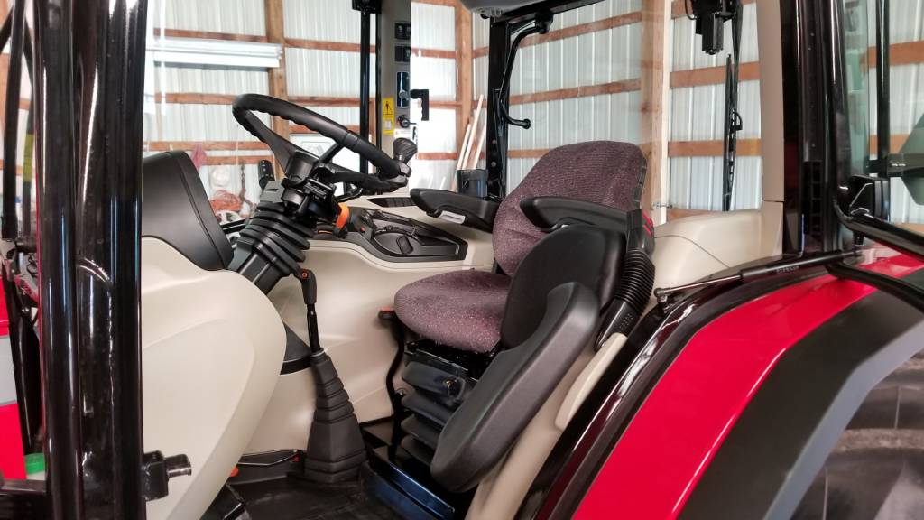

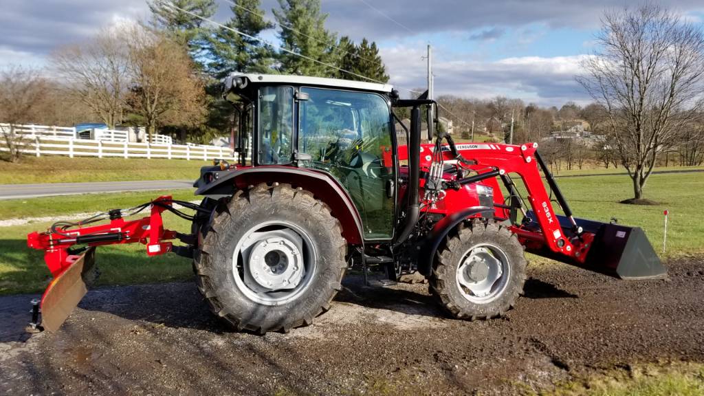

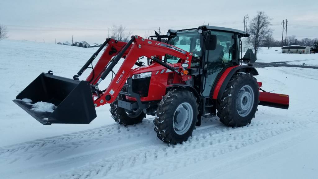

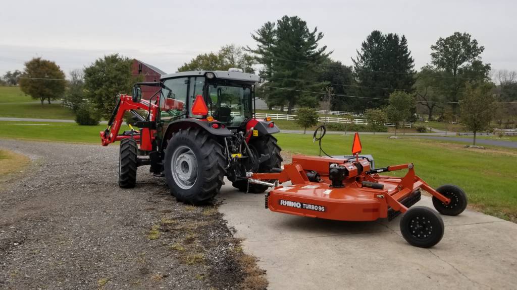

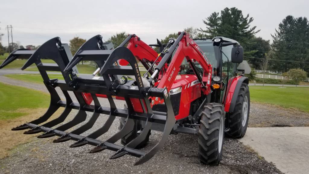

Get the 4707 and dont look back. Fantastic machine. Very comfortable and capable. Get a nice heavy grapple, a good quality rotary mower, and a heavy rear blade or box blade. Woods makes good stuff and there is a $400 rebate if bought at time if tractor purchace. Rhino makes excellent rotary mowers. You will need a 14k or 16k trailer. 20190113_164723.jpeg20181203_140453.jpeg20181026_114133.jpeg20181026_120043.jpeg20181025_085143.jpeg
