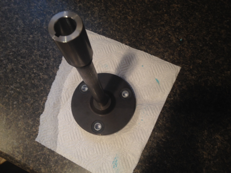

I literally just finished this job on mine, but I had a cobbled together setup with extra long shaft thanks to the previous owner.
That three bolt flange (yours might be four bolt, hard to tell) is still available new from MF. I just got one. Mine came with new bushings already pressed in.

shaeff that looks like what i need. It is indeed a 3 bolt. I tore it apart this afternoon and pulled the axle assembly forward a few inches. I cut the shaft off instead of pulling the axle off the studs. I figured it's all junk now anyway.
Problem is that whoever put it together welded the shaft onto the adapter hub! This would explain why I couldn't impact it loose. I wonder how they knew what length to make things not to mention it would have to go in from the inside so the axle assembly would be over a foot away from where it's supposed to be...weird.
The other thing is the sleeve or whatever you call it that holds the axle assembly together is worn bad, it looks as though the shaft was ground away where it broke so I may as well replace that too.
