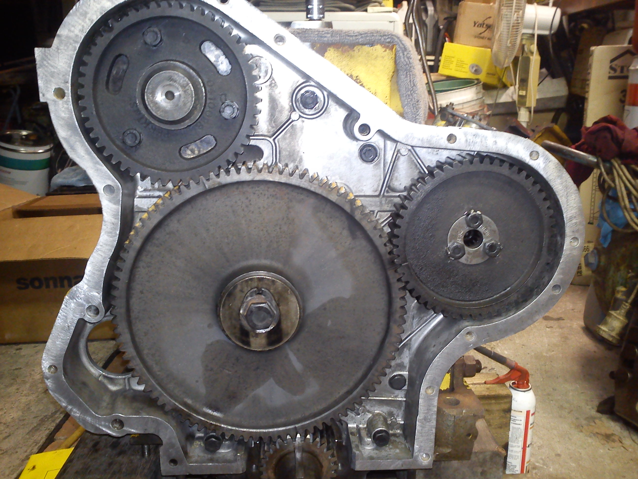

Hi Dave, Sorry for the delay - life got in the way a bit. Looks like a makeover, but I reconditioned the engine because it needed it. I only painted it at our youngest daughter Jennifer's suggestion. She would quite often bring me a coffee and biscuits or cake, and asked me what I was doing, commenting it was a huge job. I appreciated her interest (and refreshments) and would explain it was worn, but would be as fit as, and run, just like a new engine when I was finished. She then replied I should paint it and make it look like a new engine ... an obvious and practical thought for a teenage girl, but delivered so convincingly I just had to admit she was right! I painted it, even though it was by then refitted. I had her help too - she held the starter button while I sprayed the front pulley nice and evenly. As an afterthought, I painted the steering links to improve the overall looks in the engine area. Note ... she drives both our tractors quite confidently - the 135 since she was about eleven years old.

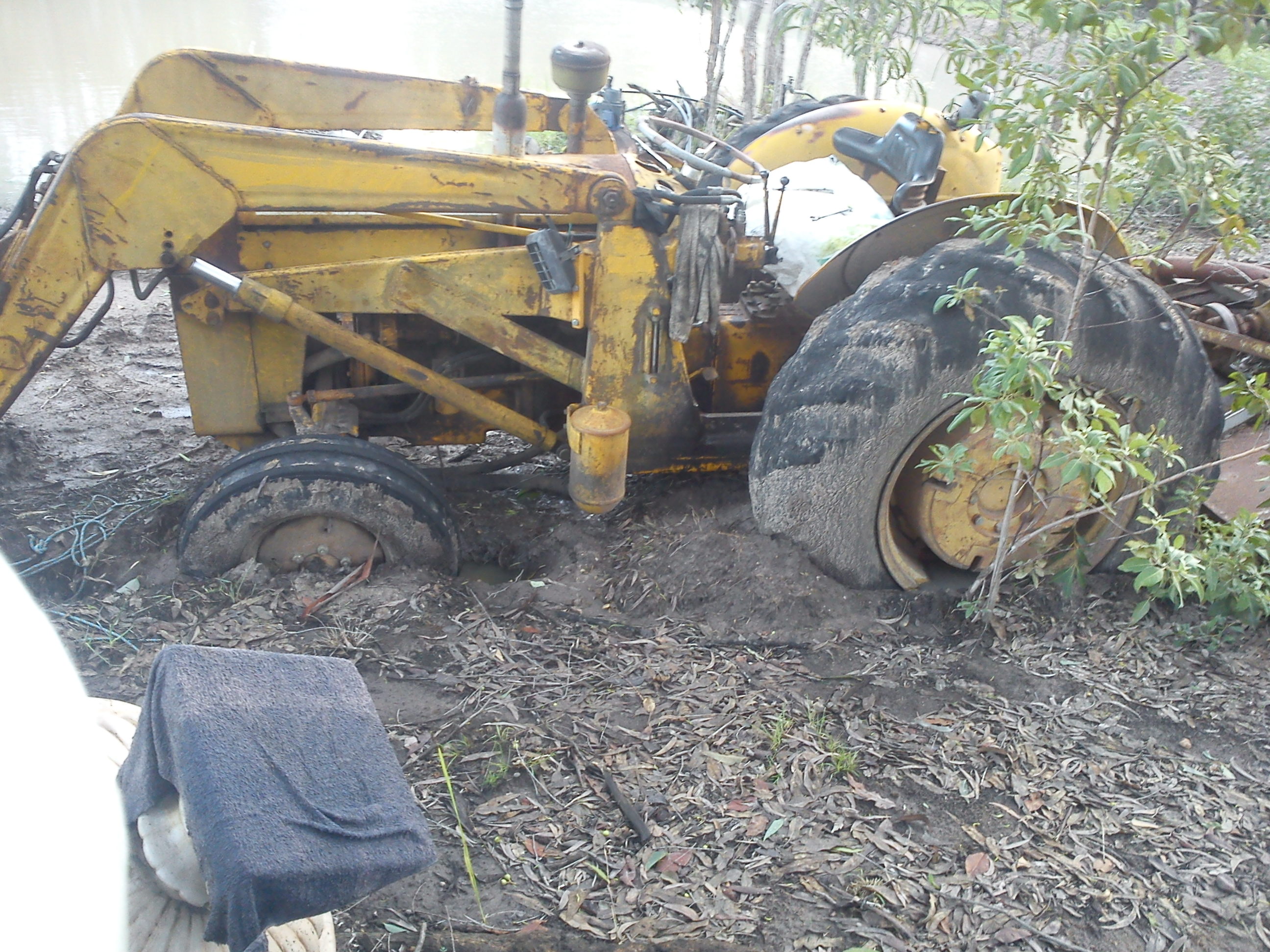

Here are some pics.
As purchased, and during engine work:

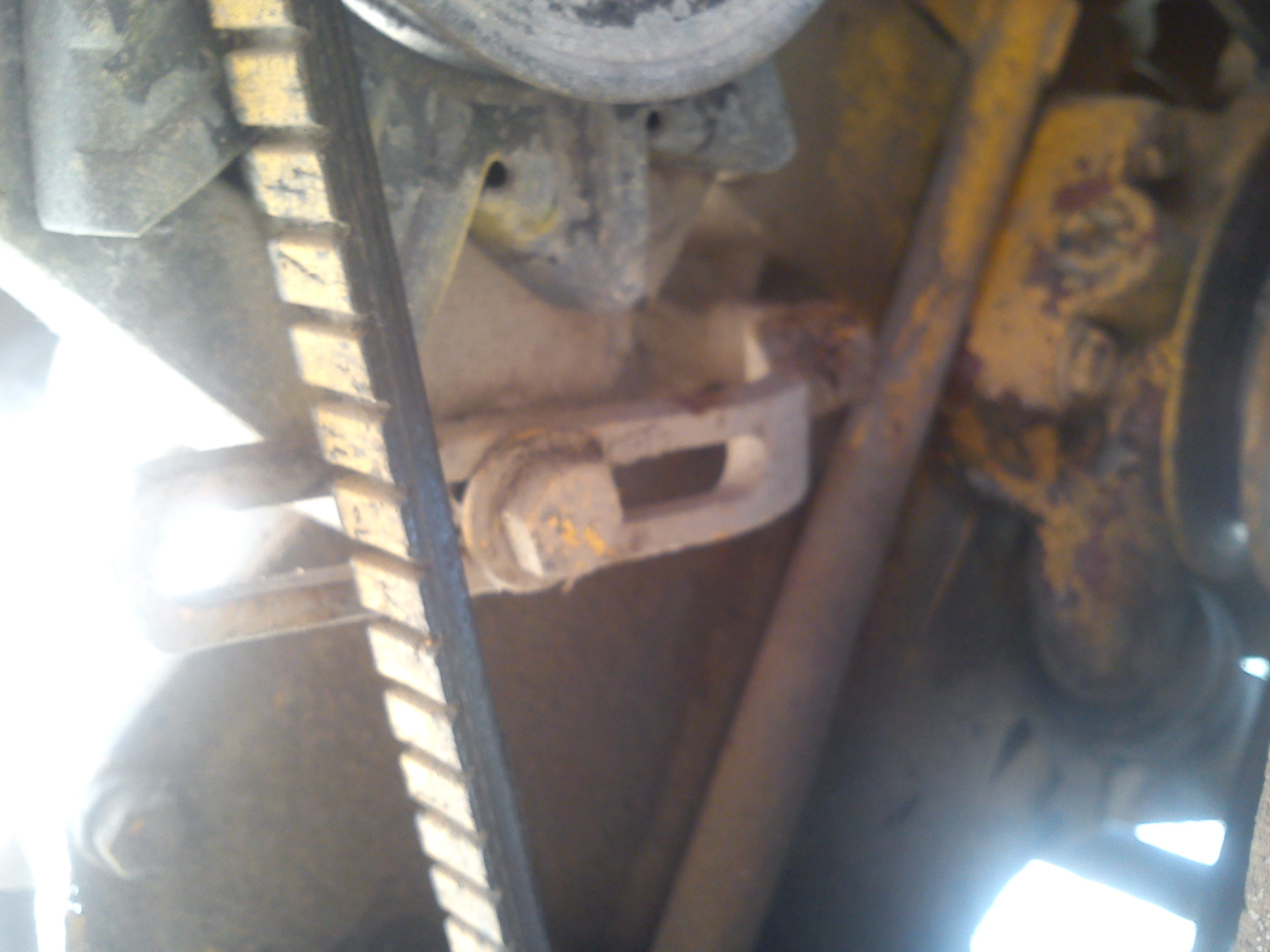

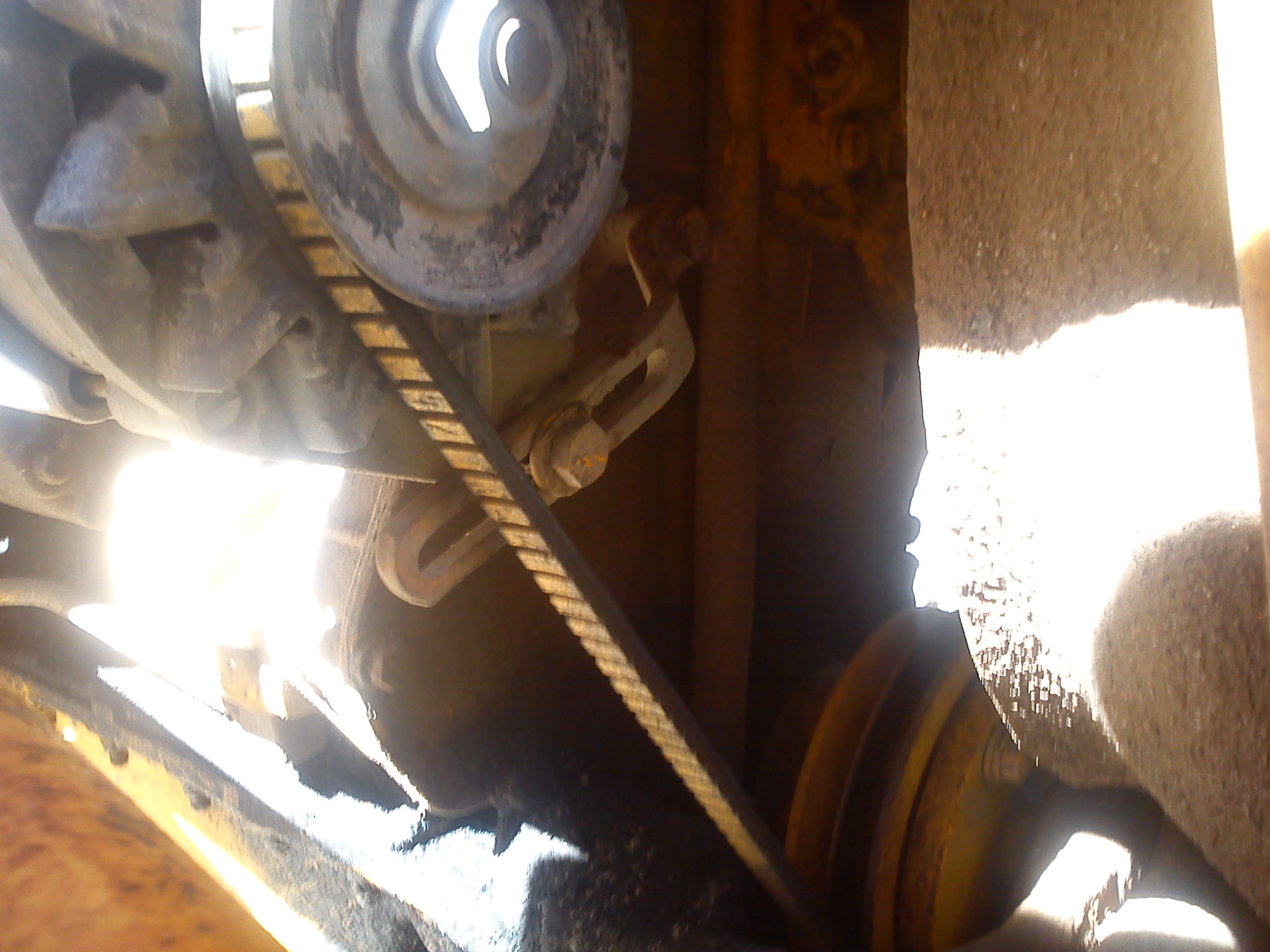

Alternator area ..... not a location to easily photograph!
The adjusting strap has bends to allow for the alternator's offset lower mount. I don't know exactly what shape the strap should be - this tractor when I bought it had a horrid Motorcraft unit from a Ford almost falling off it. I fitted a normal everyday Bosch 65Amp unit from a Mercedes Benz 280E (in the graveyard down the back) and reshaped the strap a little. It has one bolt through it to the engine timing case. I also added a spacer and a longer bolt. I'll post a pic (I thought I had one) of the upper mount - that will show you how easy the job is. I'm really glad I did that job - the machine has 5 x 55watt lights, but that unit would run about 15 with no trouble. I will do the same conversion to our 135 soon.

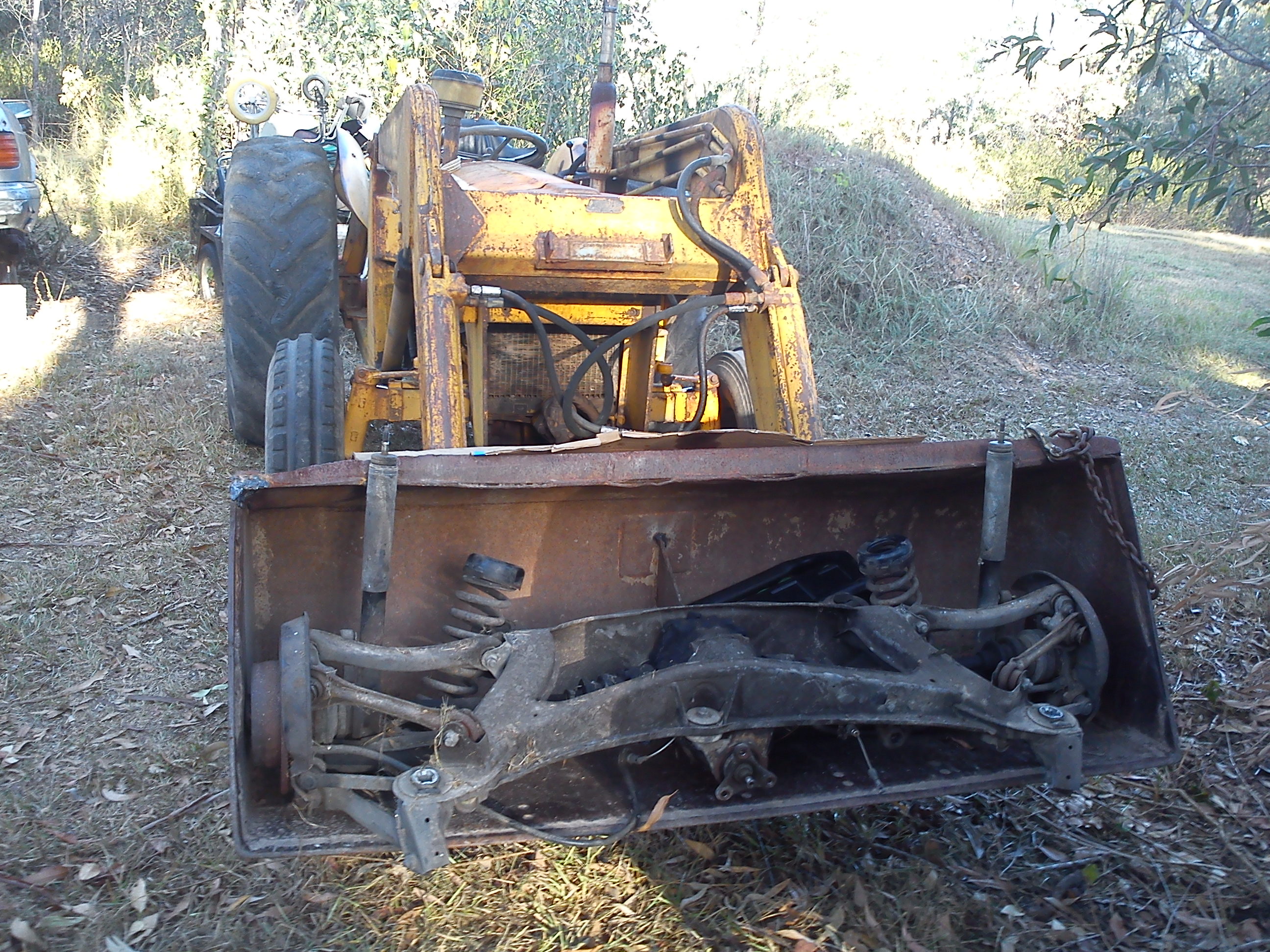

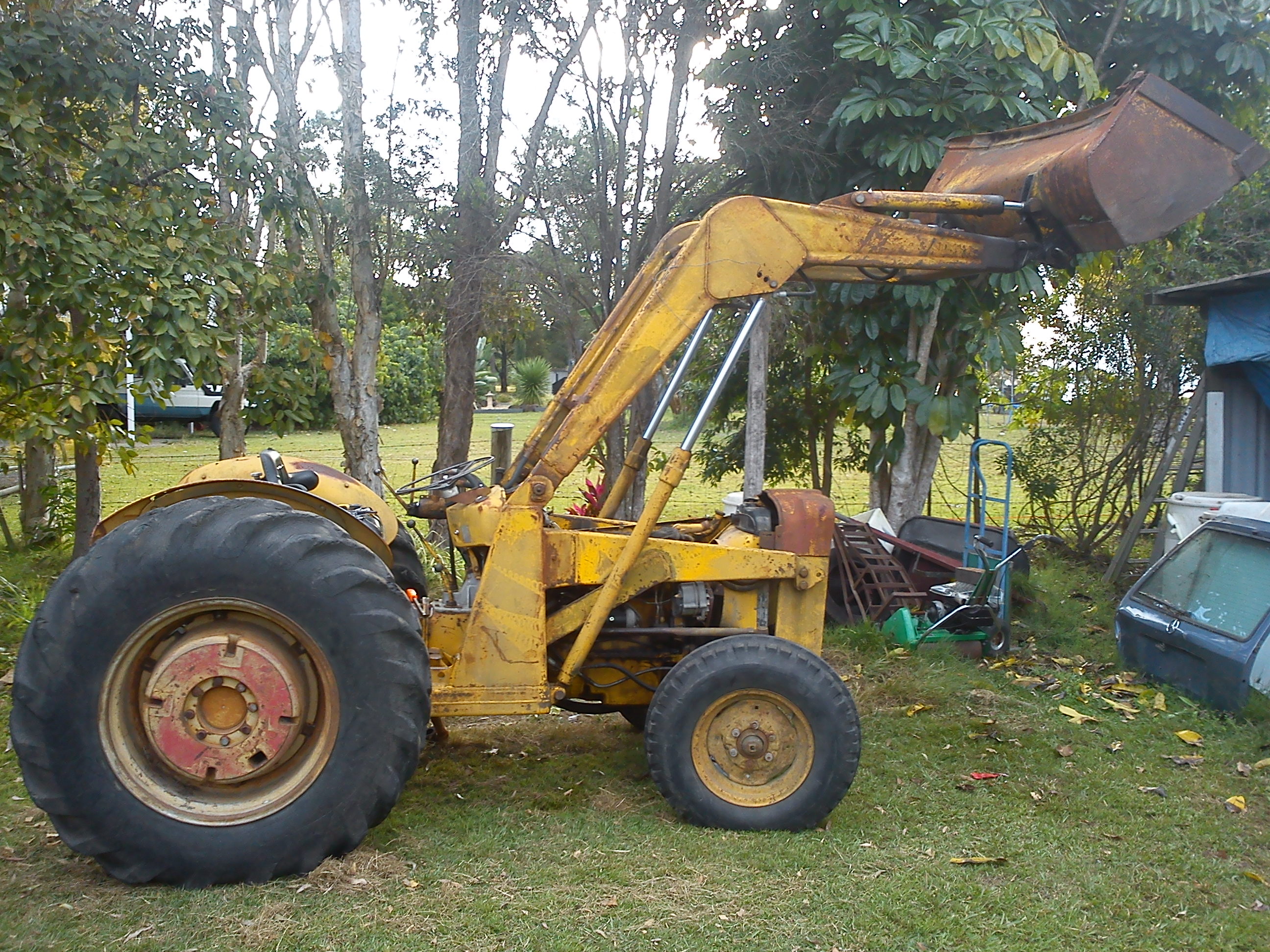

Geez Dave, that bucket must have been rough - even compared to mine! :laughing: It looked like this when purchased: :eek:

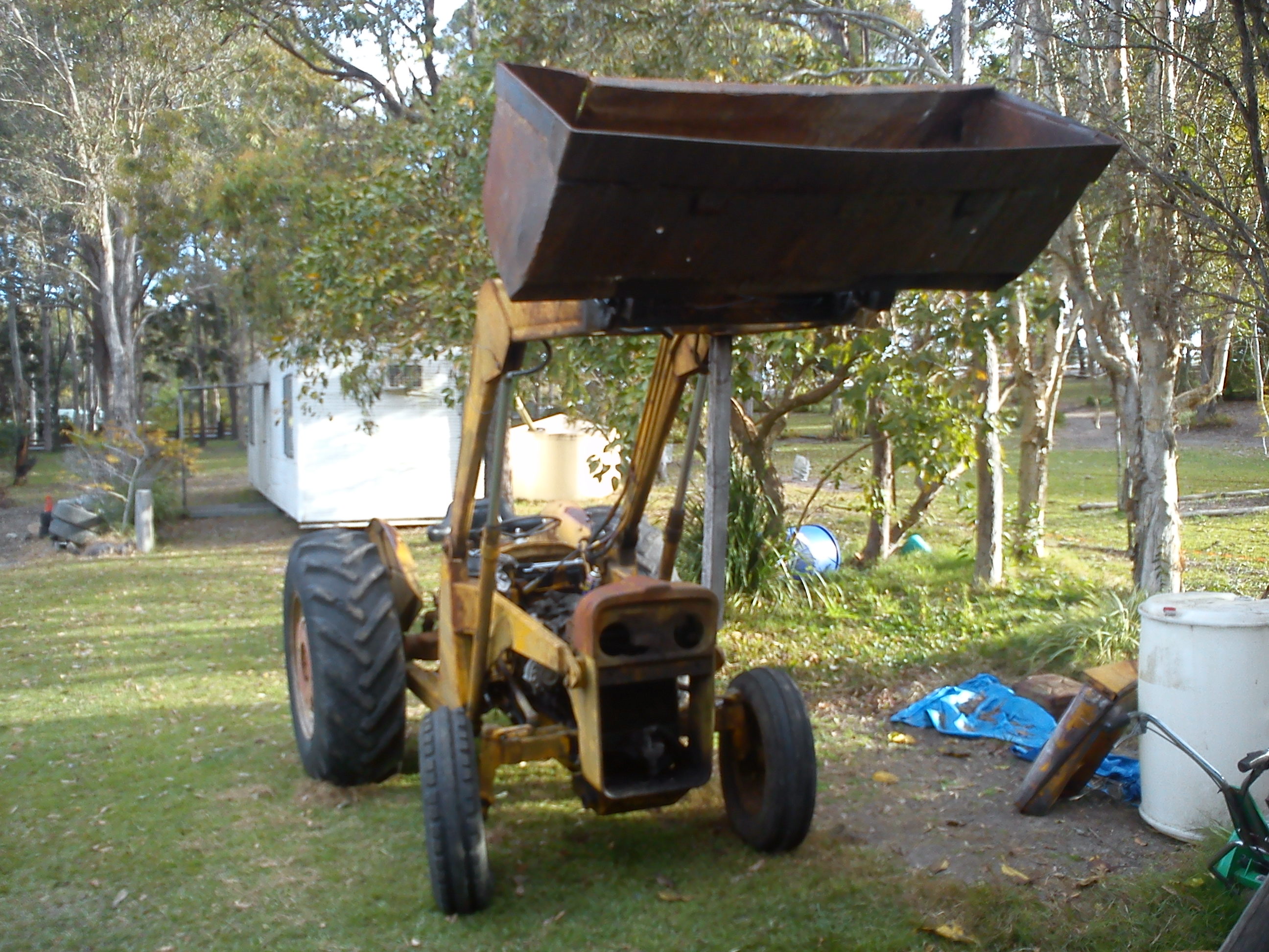

After I straightened it with a couple strong steel beams, chains and a truck jack ... I couldn't believe the strength of the cutting edge, :shocked:I thought I was going to break something there for a while! ;) Plus a little time welding up cracks, it looked like this:
That's a complete rear suspension assembly from a MB 300E in it - shows what a good-sized bucket they fitted to them.
It readily lifts it even when it's full of wet clay or sand - surprised me, considering the diameter of the lift cylinders. :thumbsup:
He should readily find a usable bucket in a salvage yard for a reasonable price.

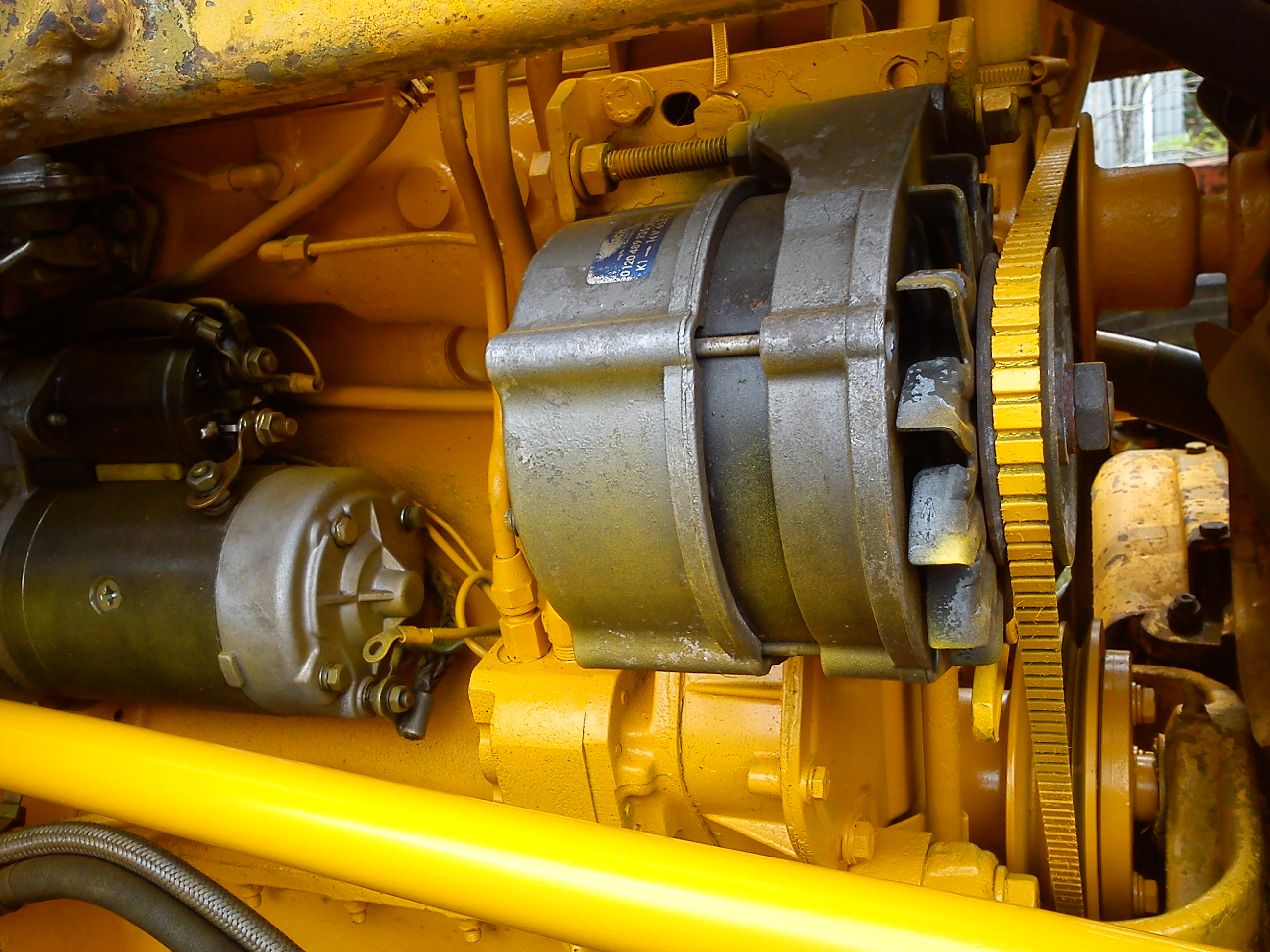

BTW, here's a good pic of the upper mount for the alternator.
I had to redrill the two mounting holes in order to move it forward to align the pulleys. The top "bolt" is actually a piece of threaded bar and with a few nuts and washers it all tightened up nicely with everything held in the correct position. Haven't had to touch it in two years. :thumbsup:

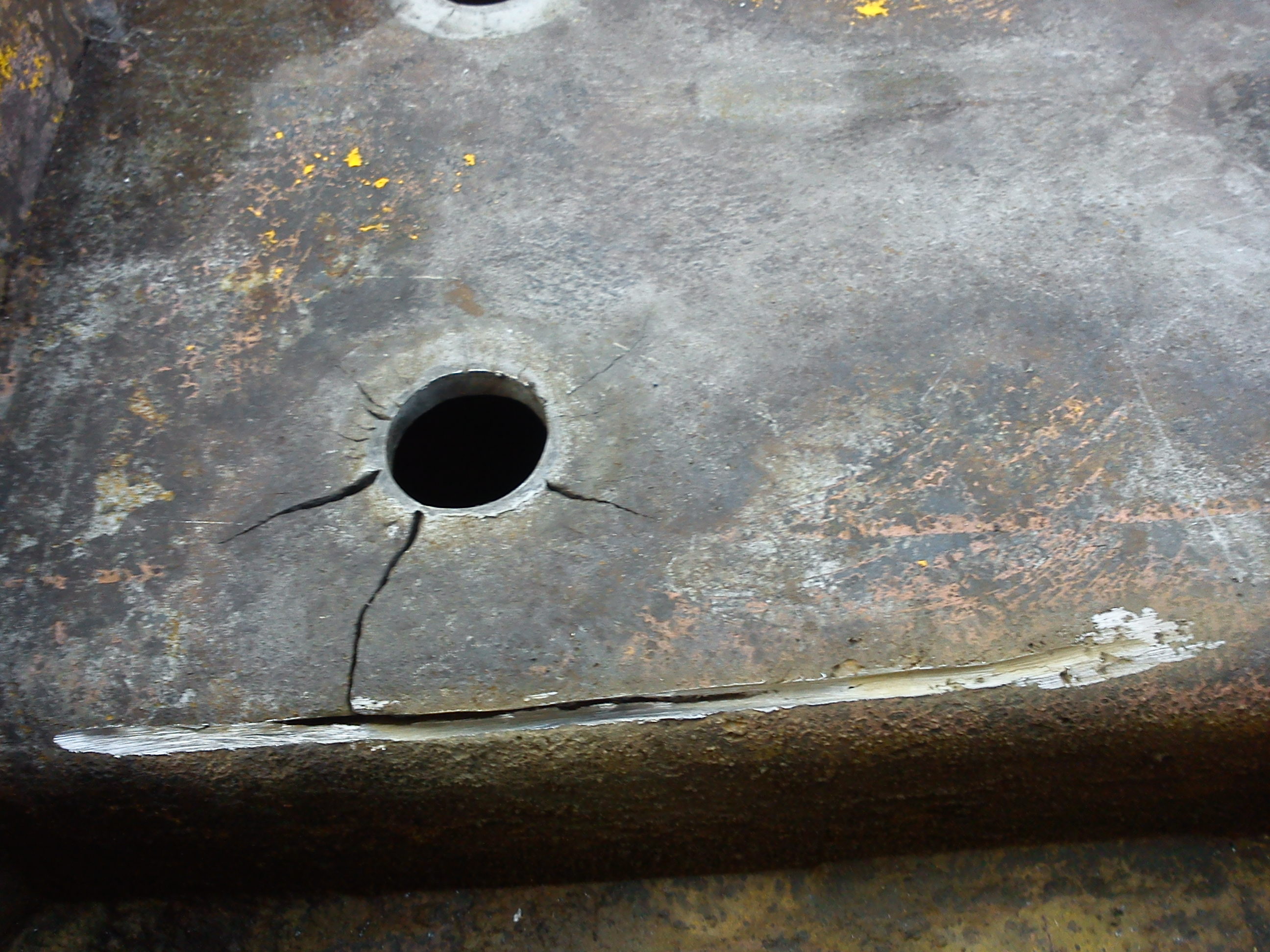

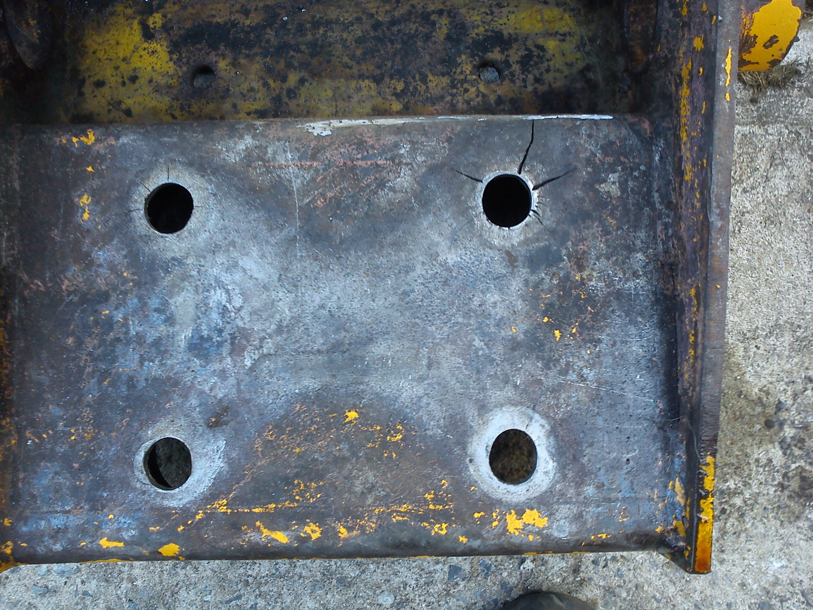

One last thought: Check the bolts holding the loader frame up under the front axle housing. Mine had only two in it :shocked: (both on the left side :eek: ) and the plate looked like this:
Needless to say, ground out and welded all those cracks, new HT bolts with 1/4" thick large diameter washers which I pressed to a slightly dished shape. This was to move some of the force away from the holes outwards to the edges of the washers - not sure how effective that idea actually was. ;)

Amazingly enough all 4 bolts were in there and the holes also looked like that. Luckily (or unluckily) for me the replacement shaft (the correct one) was two inches shorter than the crap they had cobbed in there so I drilled 4 new holes, actually 6 new holes as there was a cross piece for the loader so those holes had to be re located also thus sliding the whole plate backwards 2 inches. I was impressed with how the holes lined up afterwards! :) I did take my time laying them out though.
