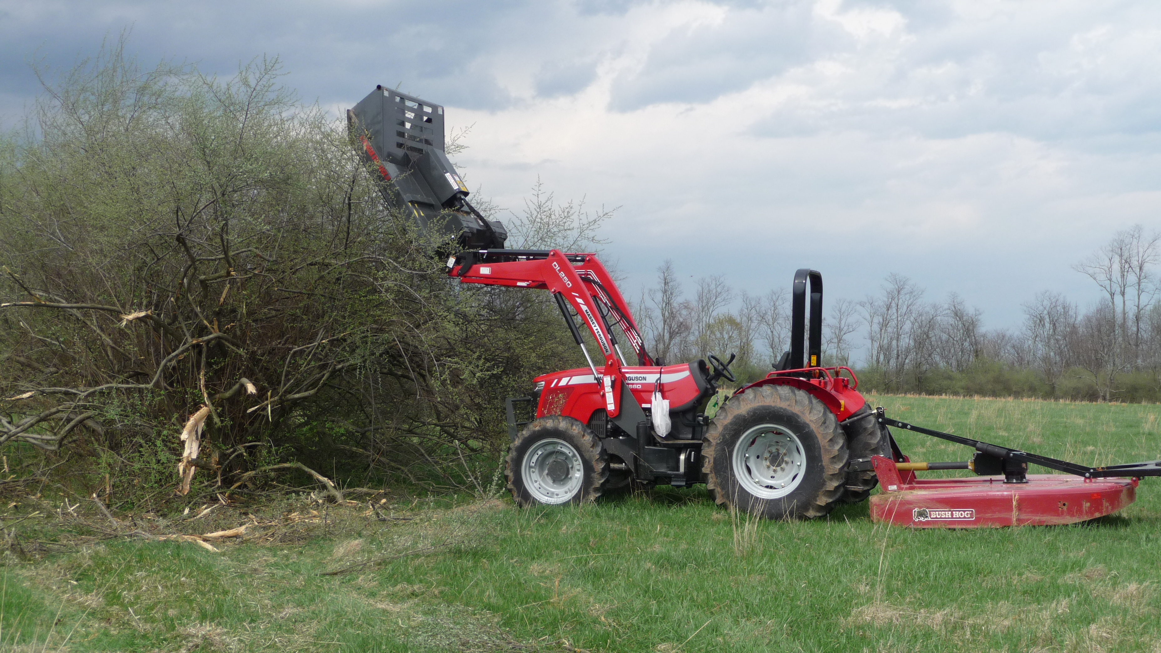

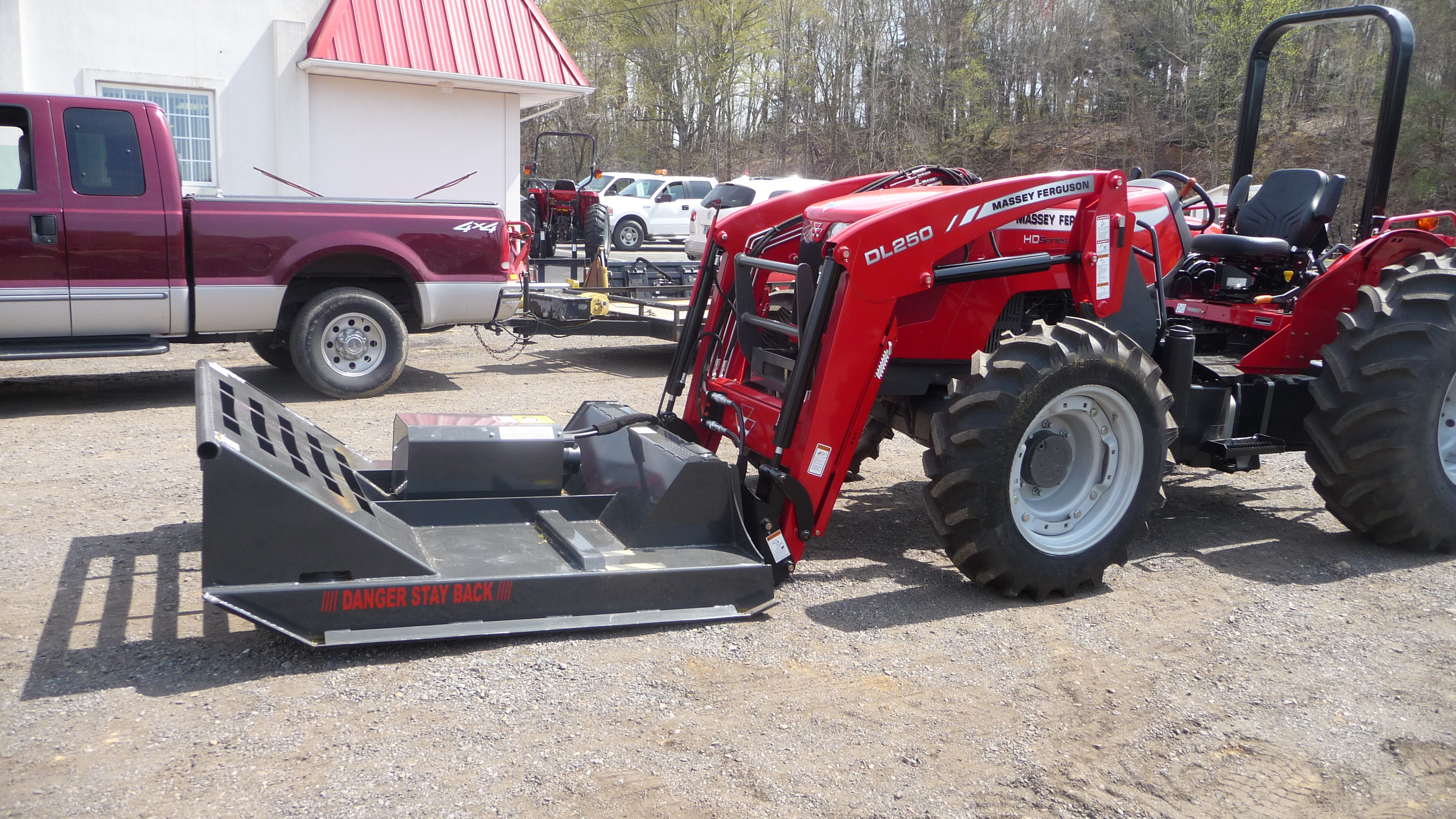

OK poopstink,,, here comes some pictures of front mounted hydraulic motor driven items.
This is a EDI Corp 60" heavy cutter on my FEL. Would cut very heavy material IF you had the hydraulic oomph to drive it which I did not. Sure it would work but not robust and got hung up and jammed way to easily. If I got a PTO driven pump to fix that problem I would have given up using the bush hog
at the same time.

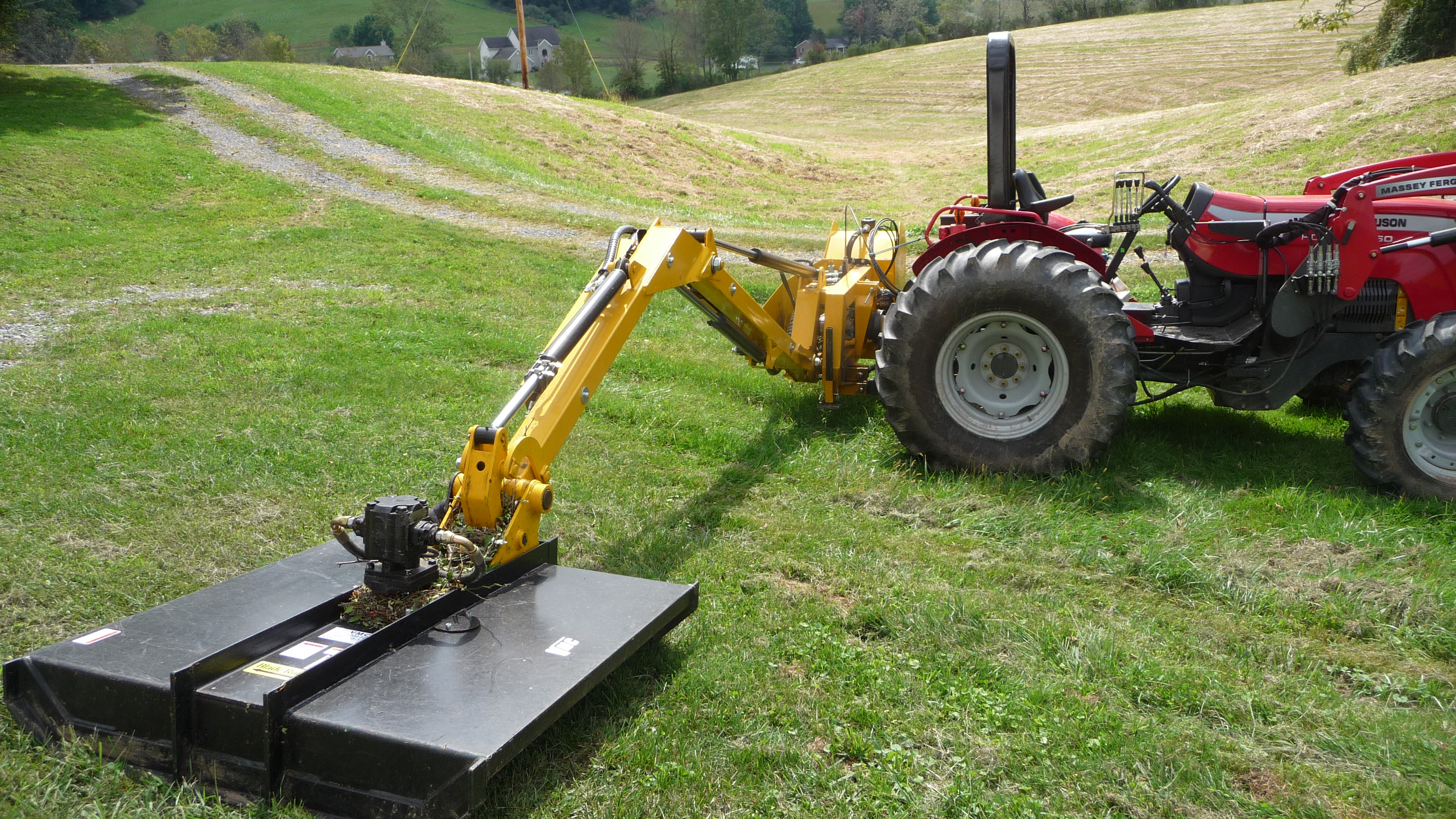

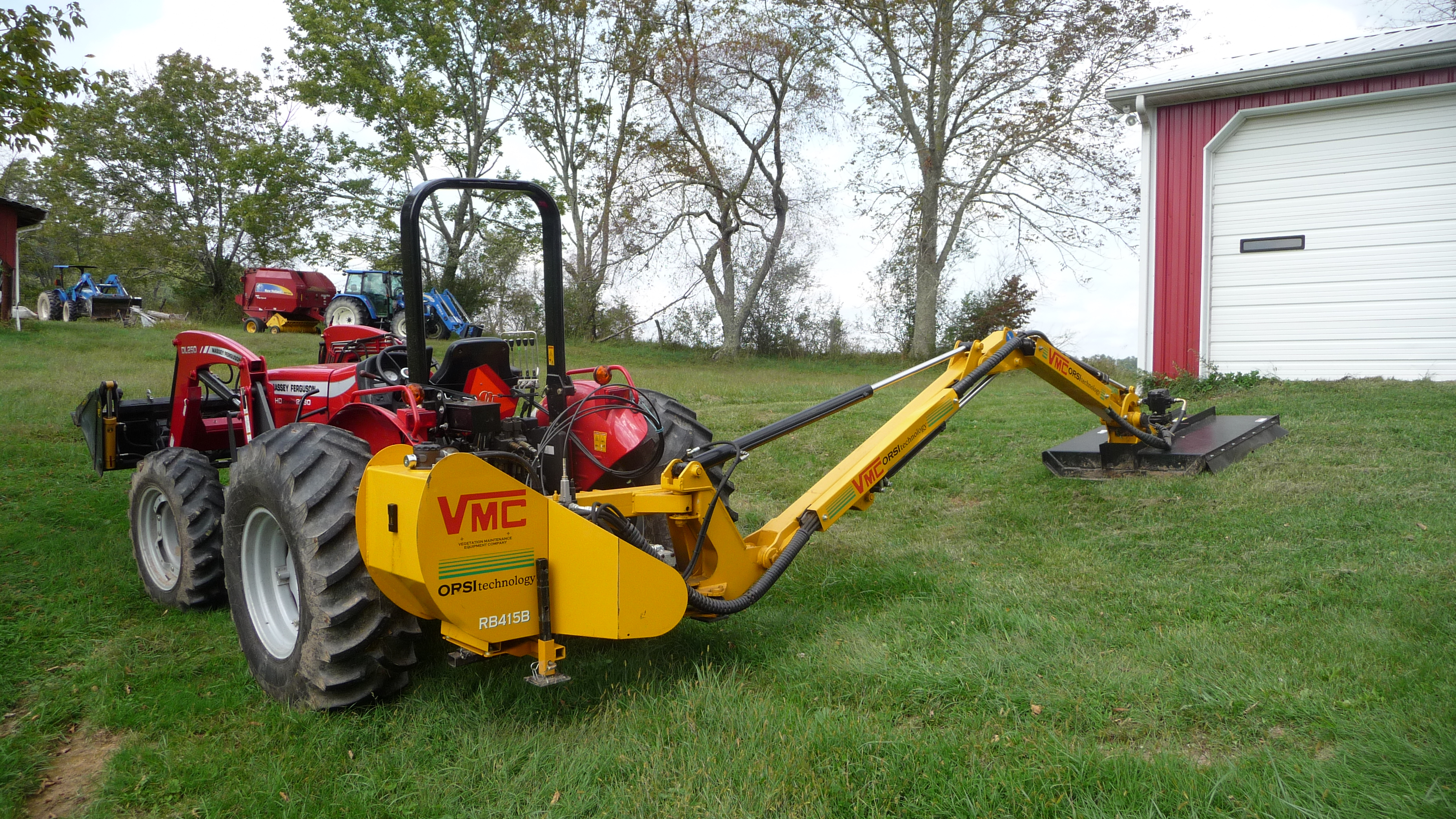

I traded off the EDI FEL mounted heavy cutter on this (which will whack anything that gets in its way and will not bog down, PTO driven of course.) I still have it but it is tough on an old man to get on and off the tractor and of course precludes use of the ordinary bush hog. By the way that far away background hillside, second photo, is measured to be 40% slope on the steeper right side. Two views of the ORSI here.

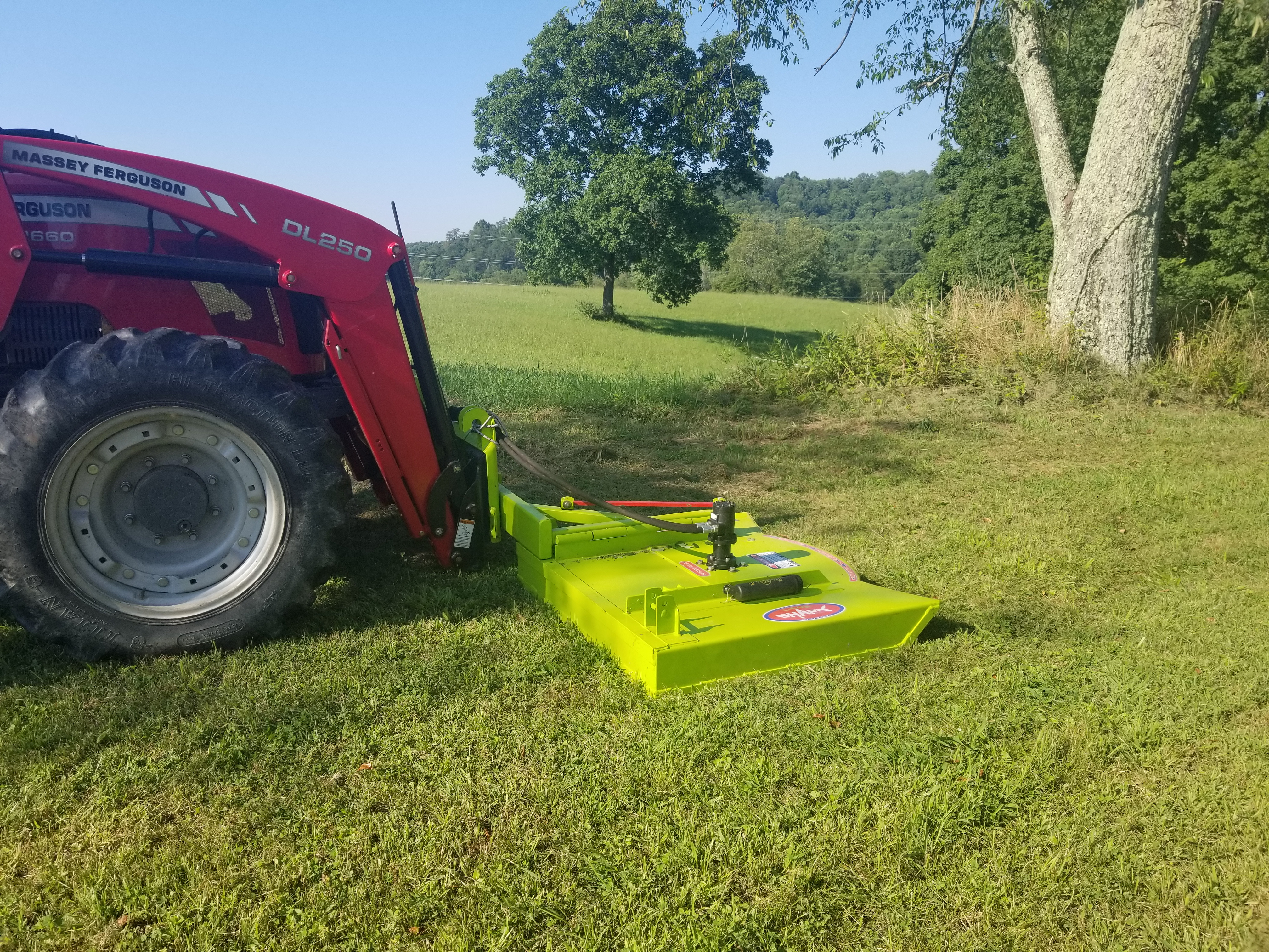

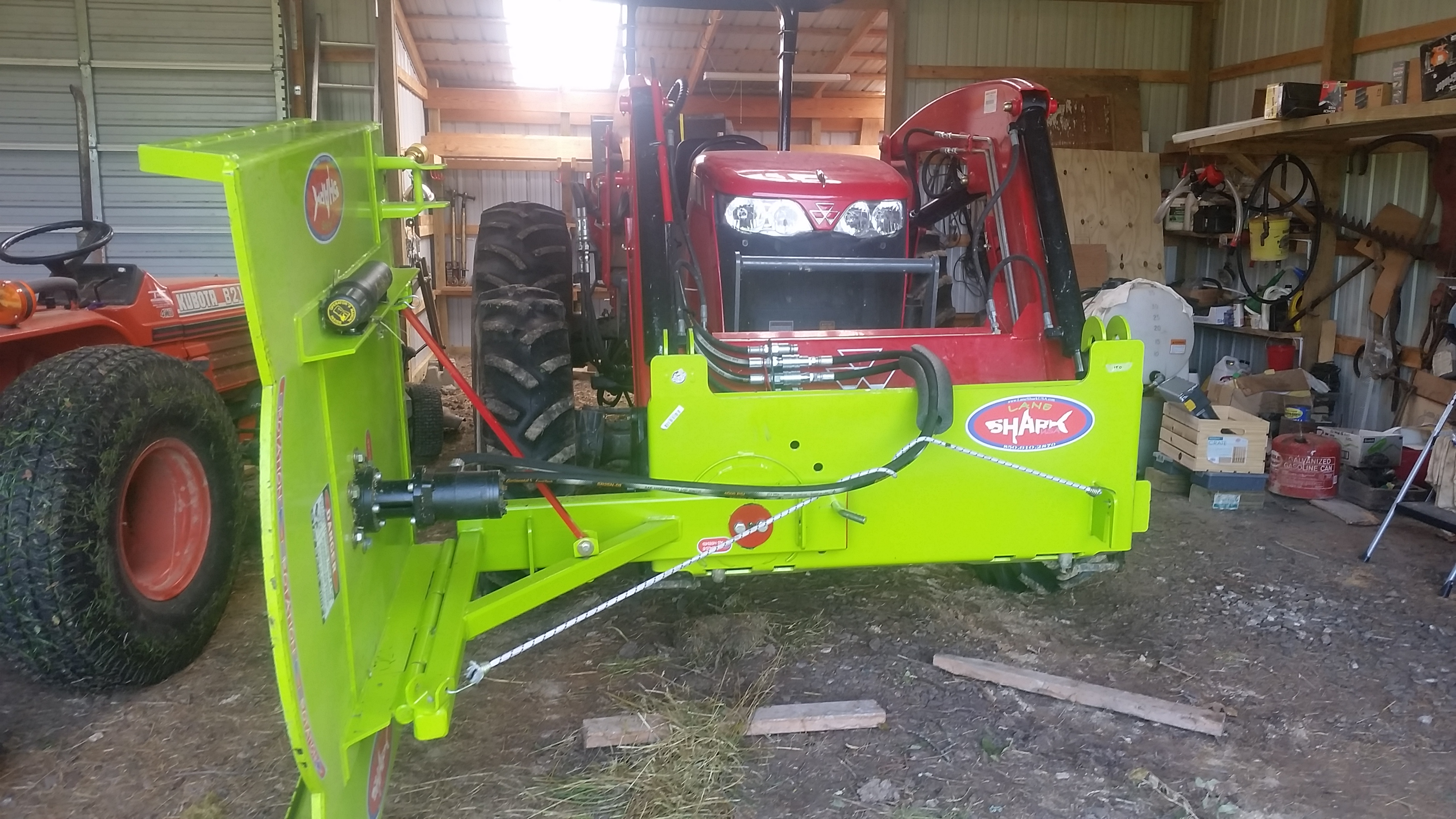

And finally, I got the first Lane Shark sold in WV a couple years ago. It mounts on the FEL, cuts very well and does not clog (unless you try cutting clusters of 3" material) and is designed to run on much lower hydraulic flow. My 2660 handles it with ease. That way I can run it on the front and a 7' hog behind for all day brush and pasture work. I do not know what the choices are for FEL mounted or otherwise front end snowblowers but lookout for flow requirements.
Notice on this Lane Shark I had an extra set of hoses of larger diameter run to the front instead of using the 3rd function hoses. If you put a snowblower up front I would do that too. You may think about running a blade in back and blower in front for your snow work if you have a lot to do. That would open the possibility of using a PTO mounted pump to get any amount of hydraulic flow the blower needs rather than using tractor hydraulic pumping.

This has been very informative. Can you speak on the Lane Sharks ability to cut ditch banks and pond banks? Cut quality? Is it hard not to scalp without a roller or gauge wheel? Etc.

Sure. I have used mine more for cutting overhead limbs, especially those hanging out over the edge of my meadows and pasture field than for anything else. As you can tell looking at it , it can be set to quite a few angles when out to the side of the tractor, can be used straight in front of the tractor, etc. I have several sink holes (elongated openings in the ground very capable of swallowing the rear wheels of a large tractor) etc. I've used it for cutting briars and brush over those sink holes quite a bit. The limitations are mainly lack of reach which the yellow ORSI in the prior pictures has (17ft reach for the ORSI.) But the Lane Shark is so easy to get on and off and for one old man like me to deal with. The Shark's cutting width is 44" so it is not your tool for mowing large areas. I have of course tried it just mowing weeds and stuff but with the relatively narrow width I never felt it needed a roller or gauge wheel. I've used it to cut a couple of my pond banks, up tight to fences where I can't get the big 7' bush hog, edge of little streams which I have gotten tractors hung in accidentally in the past, etc. I find it a very useful, handy implement but not for cutting large areas or that sort of application. One of the main things is that Travis and the inventers of this gadget have the valves and behavior of the hydraulics figured out really well. It does not jerk to a stop & half tear itself up when fluid pressure is removed, etc. It also works real well using internal tractor hydraulic pumps without tying up your PTO. Just well thought out. Limitation is reach but it does an awful lot of good within it's reach.

Around $4K. I paid $4284 in 2018 which included some installation work on my tractor, running fresh hyd hoses to the front, new flat face connectors, direct return flow to the sump on the tractor, etc. I have not checked lately. If you go to their website I think there is a dealer lookup feature. They are very good about tech support via phone, etc.
