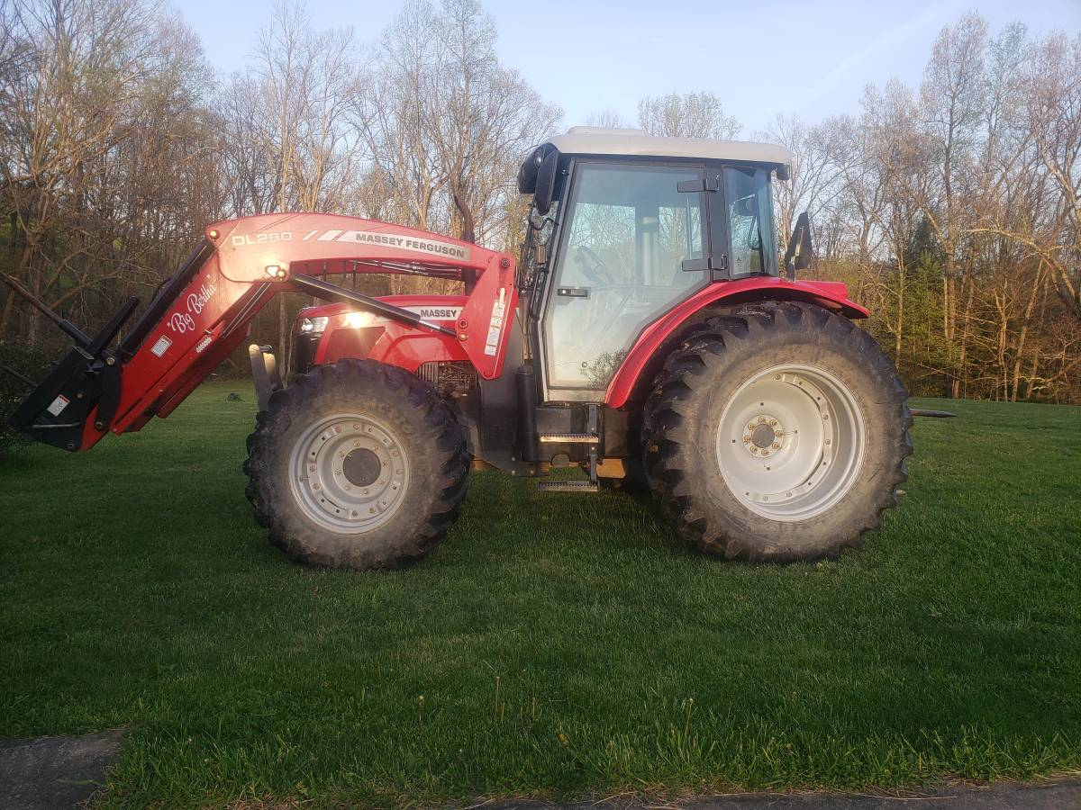

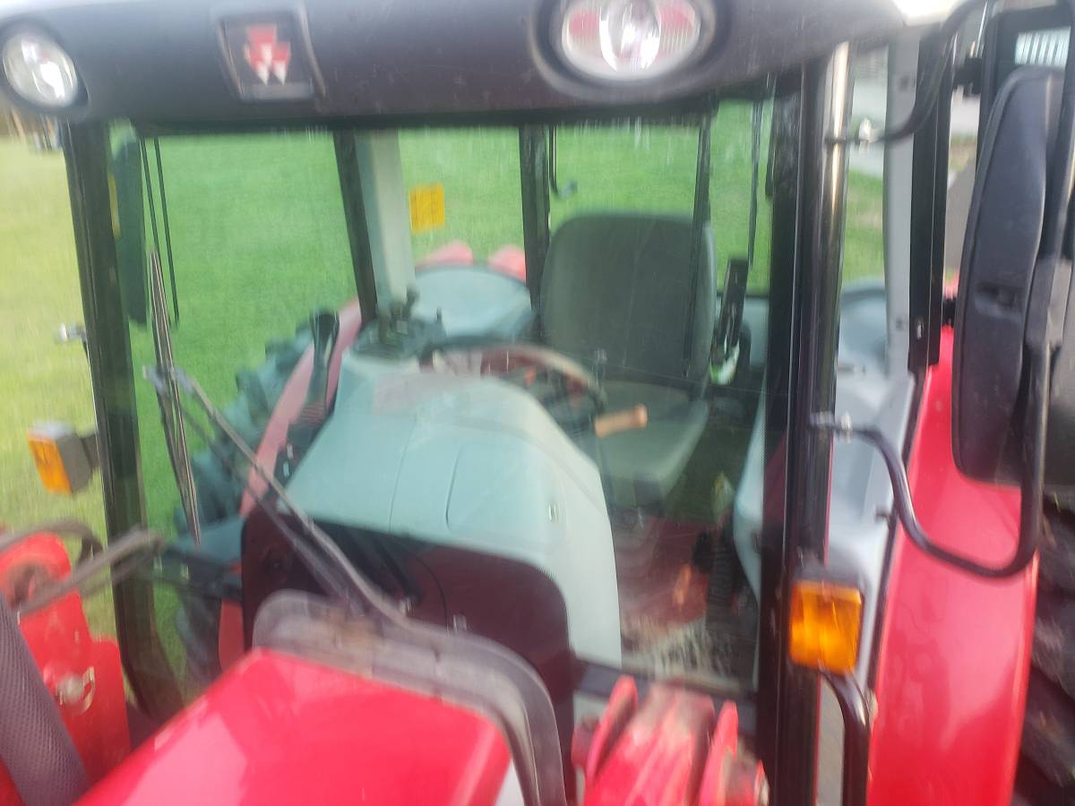

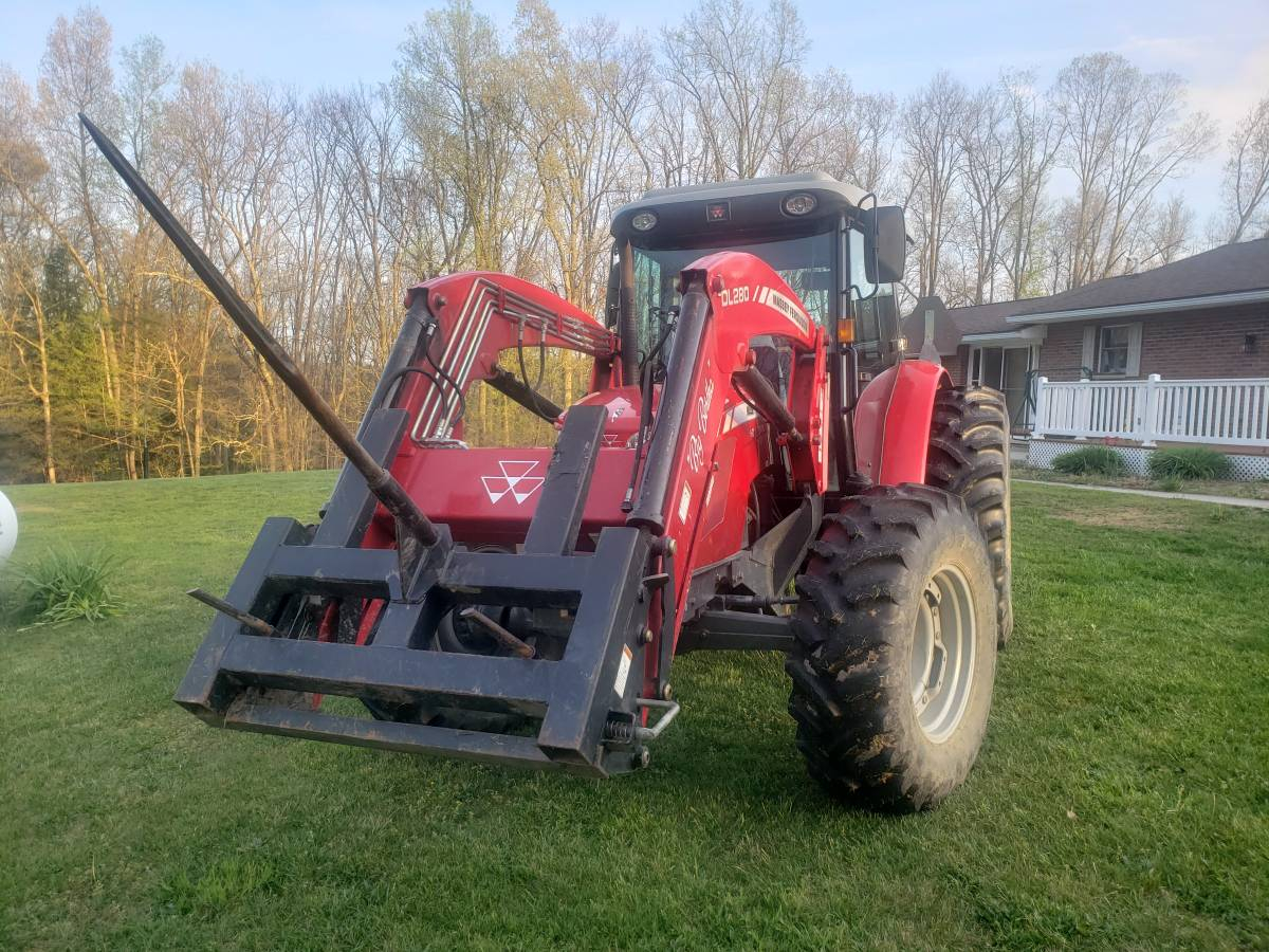

ya the cab kinda scares me. it has less clearance for the woods and greenhouse work, but would sure be nice during the Maine winters and snow removal! the added complexity of having that cab is also scary. the only reason id really jump at is is the "deal" factor. that DL280 loader will sure come in handy when moving 2500-3500lb containers/pallets full of soil. as far as trucking it myself that would be impossible. i only have a tundra and 8k equipment trailer. id be paying someone from USHIP to go pick it up. id definitely try to wrangle as much info from the owner as possible. have videos sent, etc. @sawtooth sorry to overtake your thread!

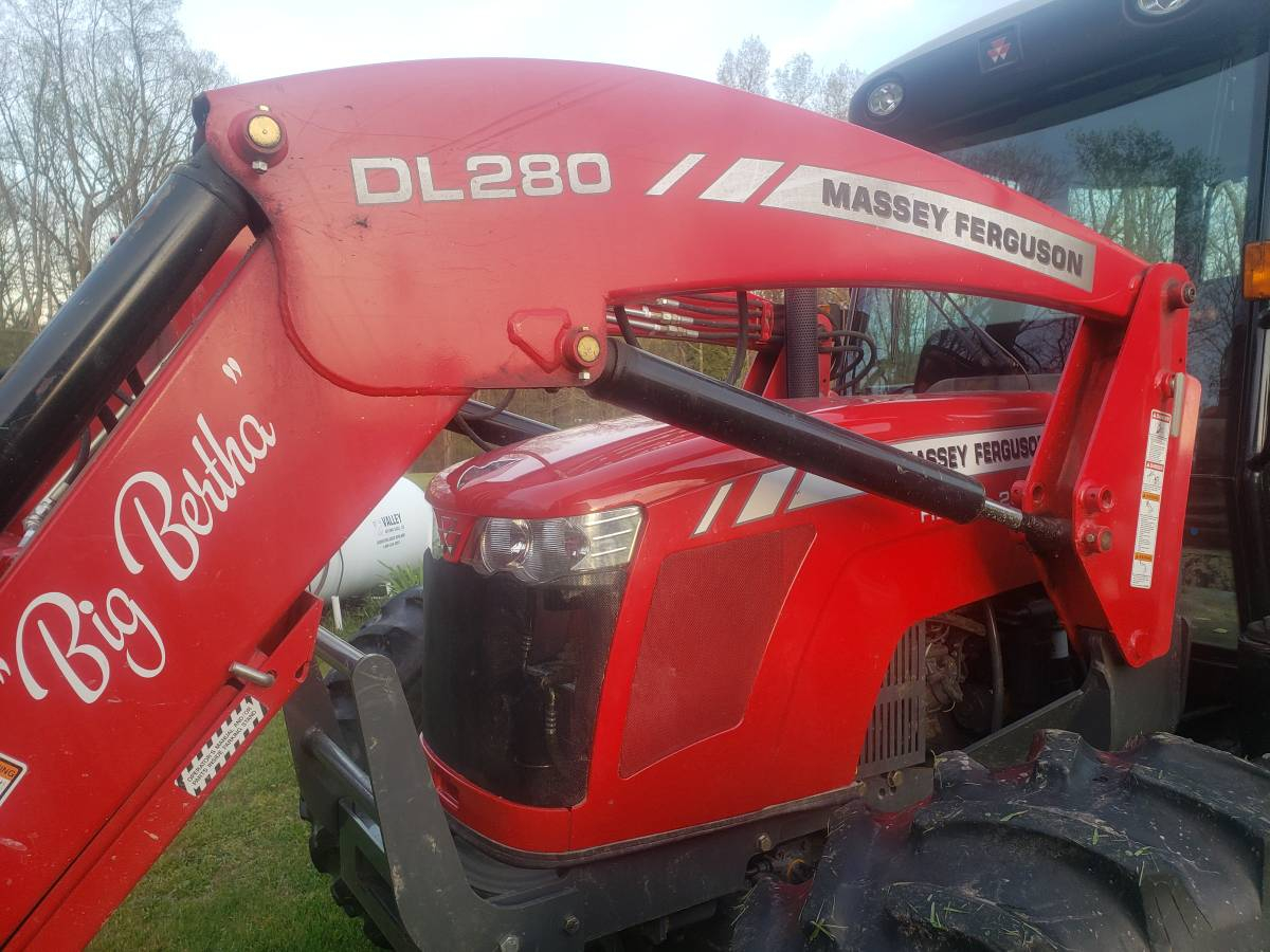

I understand. In a Maine woods environment the cab is probably well worth it in snow season. The DL280 loader should serve you well. Hopefully it has the quick-attach kit on the loader ? I can't tell from the picture. That QA gives you so many good options for attachments that normally fit a skid-steer. From the photo you seem to be dealing with a private individual which is probably a good thing, though some pros and cons. The pro is price.

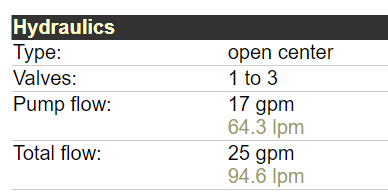

correct its a private part sale. Tractordata shows a flow rate of 17 gpm hydraulic pump, i wonder it that would be enough to drive a FEL mounted skid steer snow blower. It sure would be handy to add a valve and separate hydraulics on the FEL to drive a SSQA snow blower maybe even rough cut flail mower for taming the boundaries of my property. i dont think it has a loader bucket though. just the hay fork which i would never use.
   / Massey 2660HD rear brake issue #87

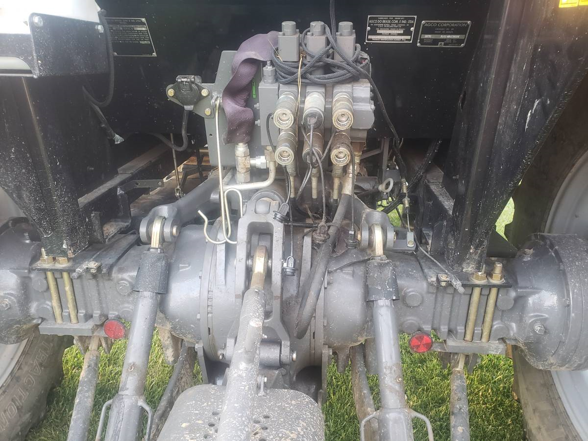

Well yes and no. My dealer in WV had a front mount snowblower on a 2660 to be used at a small local airport . They sent it out with "normal" 3rd function hydraulic supply to the blower and it was nearly useless. They modified the rig, primarily with oversized fitting and large diameter hoses and made it fairly usable. I did not have personal sight of it or try it out myself. I had a large front cutter on mine for a while and the tractor hydraulics was just not adequate to make the big cutter robust. It worked but not really satisfactorily. You should have a rather unique (to these tractors) combiner valve at your feet under the seat which allows you to add the 3pt hitch pump flow to the normal main pump flow for high flow needs. That 17gpm may be both of those pumps combined as I thought the main pump was around 14.8 ?? I'll throw in some pictures here in a minute.

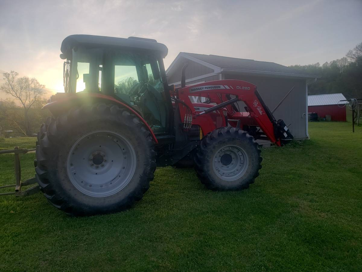

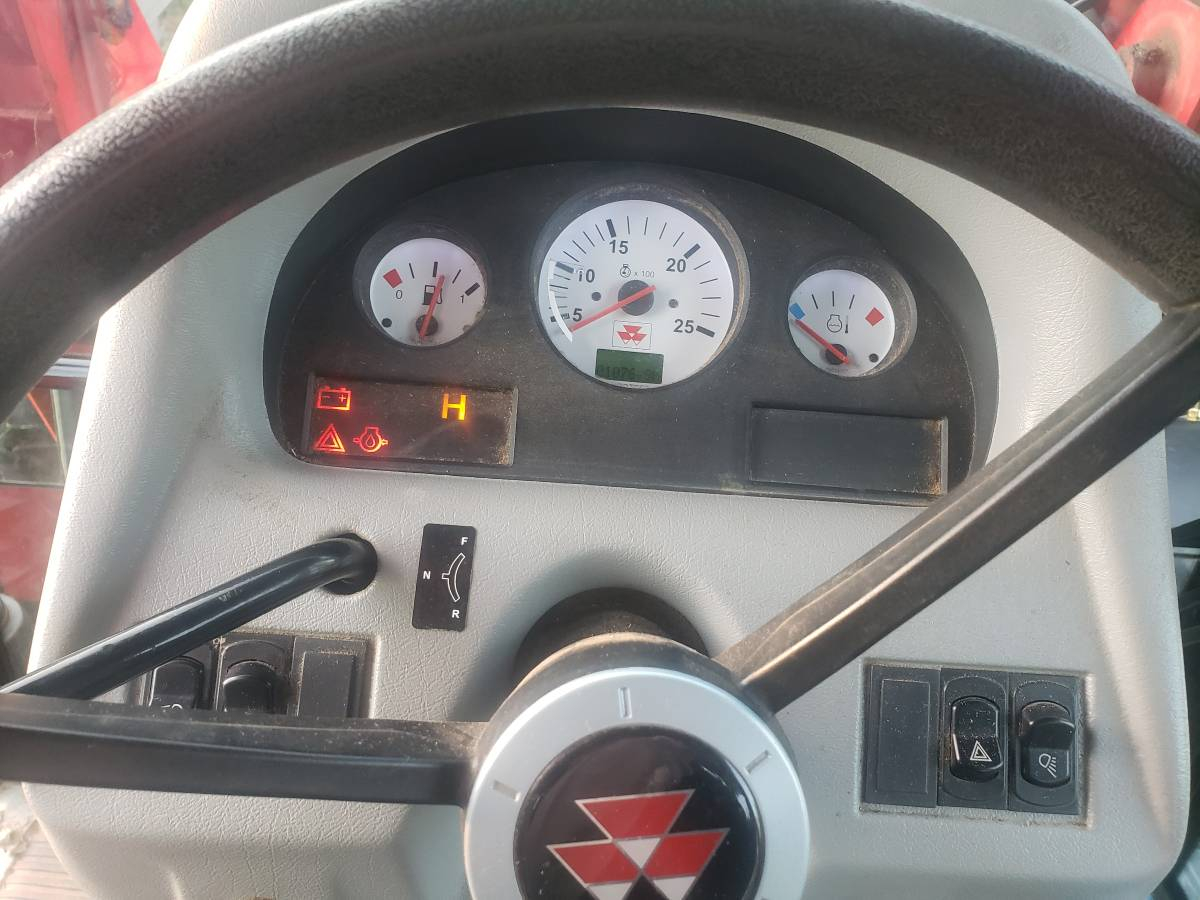

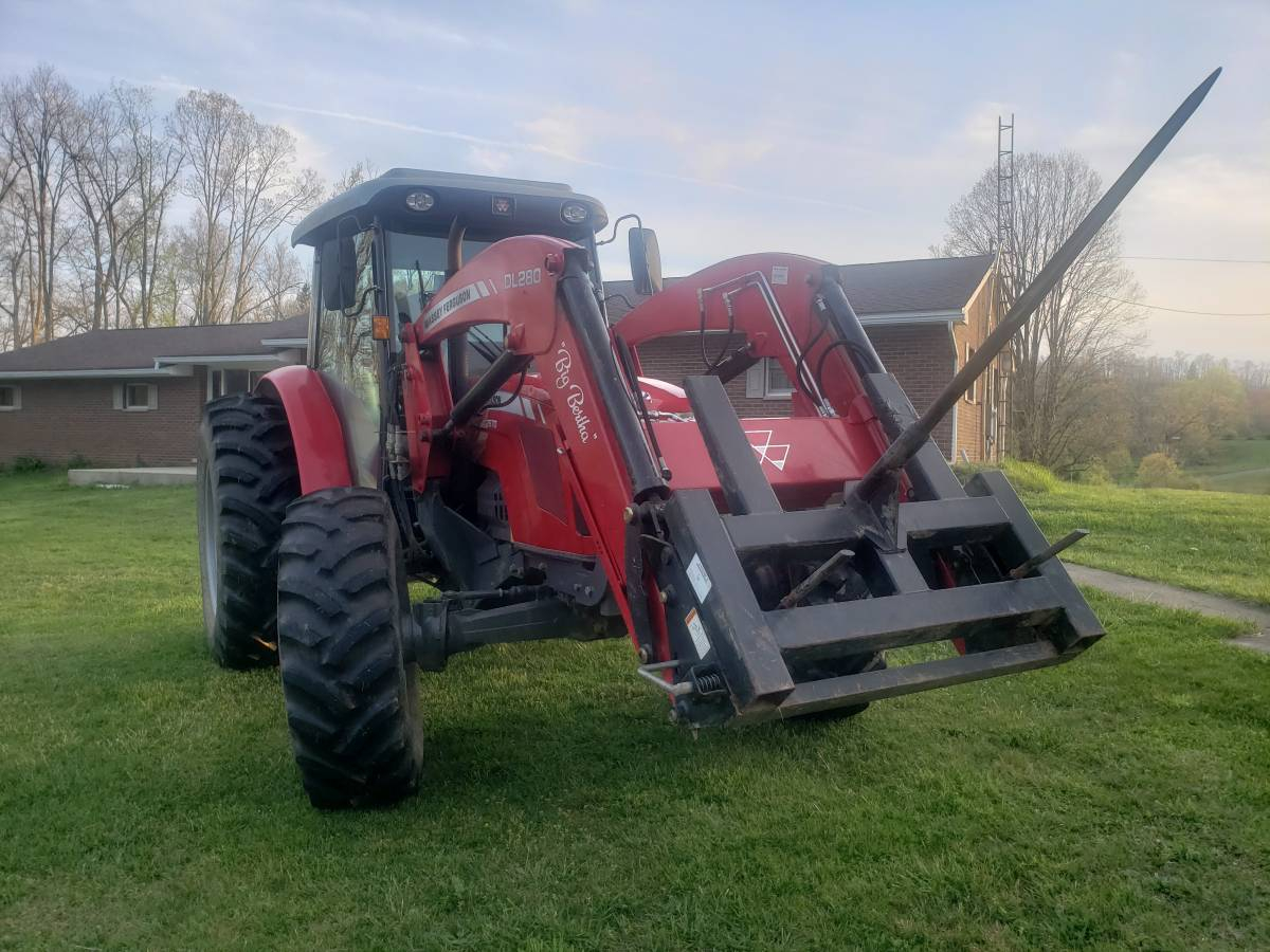

heres more pics i got today

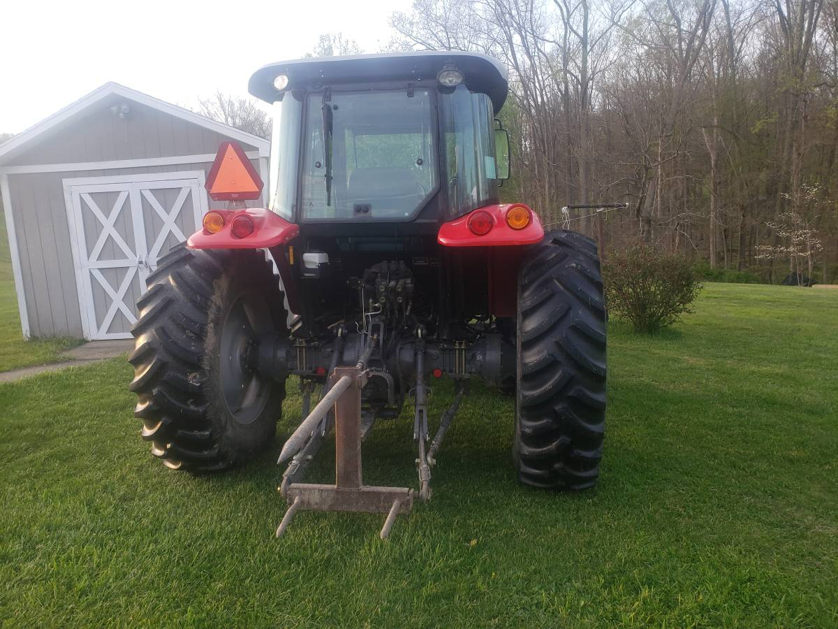

This is the rear end, can you tell what brakes it has?
Yep, I sure can. That is the marginal 4 disk type of brakes. See the 4 notches adjacent to the left side of the differential? The right side has the same set of notches but they are hidden in your picture. They WILL NOT hold you on a 40% slope with all your weight on the brake pedals. That with a 1460 lb bush hog on the back and a rops version tractor. A friend of mine with a 2660 cab model had his brakes modified for the 5 disk version by the same dealer who did mine in 2011. The 4 disk type brakes might be OK on flat land but I could not use the tractor on my place that way.
I see it has 3 remotes which is good.

Its a 2012 years as well so it must not be production year thing where they went to the 5 disk setup. on the other hand i dont have any hilly or sloped property so that wouldnt be an issue for me. id probably not upgrade them if they are currently working fine.
