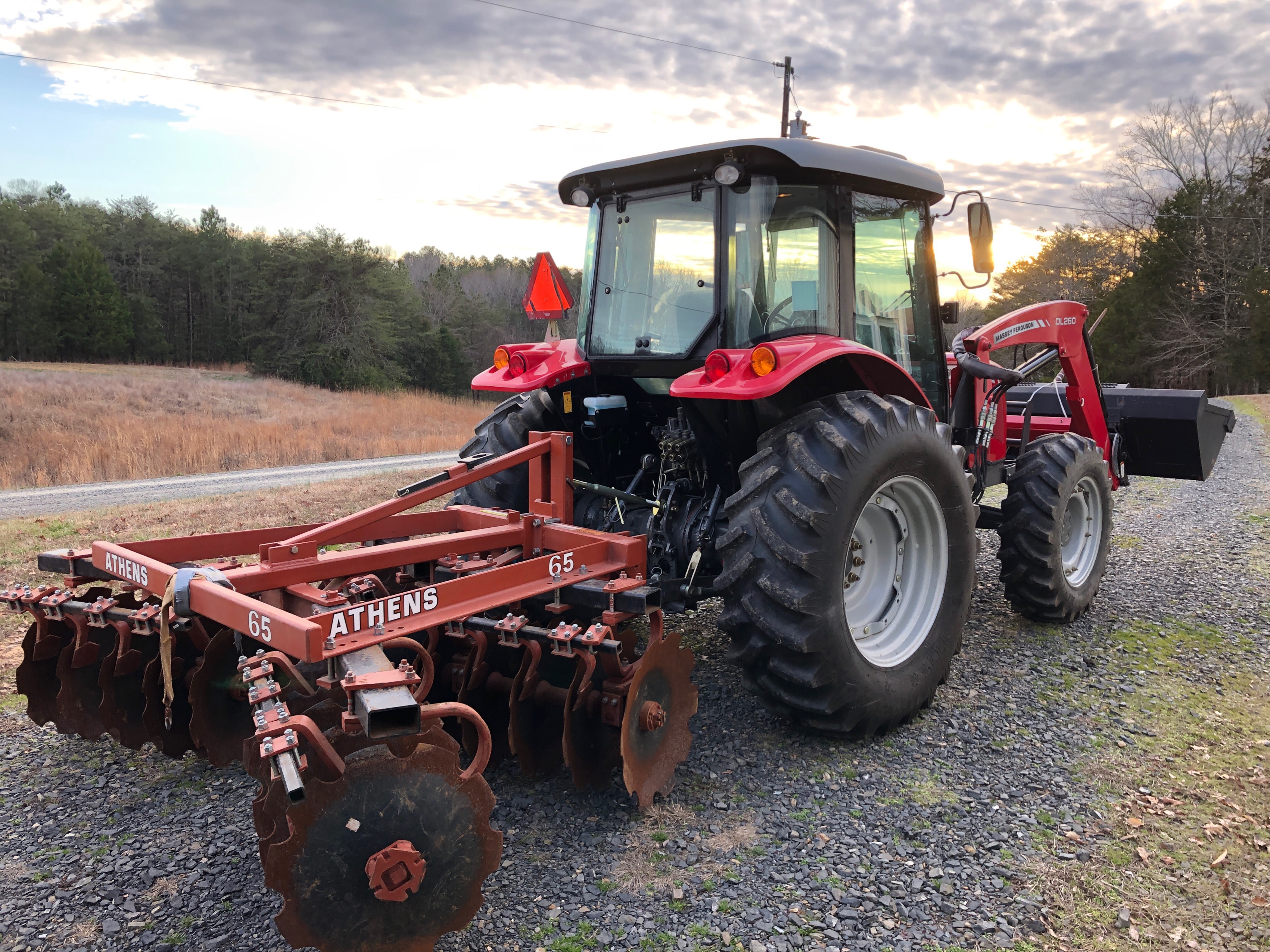

Here is the tractor with a recently found Athens 65 disk. It weights 1700lbs and lifts it without issues. Can’t wait to stick both of these in the dirt but need to address the brakes first. IMG_3127.JPG

Here is the tractor with a recently found Athens 65 disk. It weights 1700lbs and lifts it without issues. Can稚 wait to stick both of these in the dirt but need to address the brakes first. View attachment 639056
Lookin good. That is a beauty. New and well kept looking. The equalization is in the brake fluid side of the braking system up under the cosole. You have 2 master cylinders, one for the left and one for the right. The equalization line (and maybe check valves, I'm not real sure) run between the two sides. The intention is to prevent people from jamming on a left or right brake without catching the other brake pedal while running at higher speeds on pavement, during highway transport, etc. I have not studied it enough to know exactly how that works. The effect is to defeat wheel brakes to one extent or another and my dealer advised defeating it (after asking me if I wanted normal wheel brakes.)
