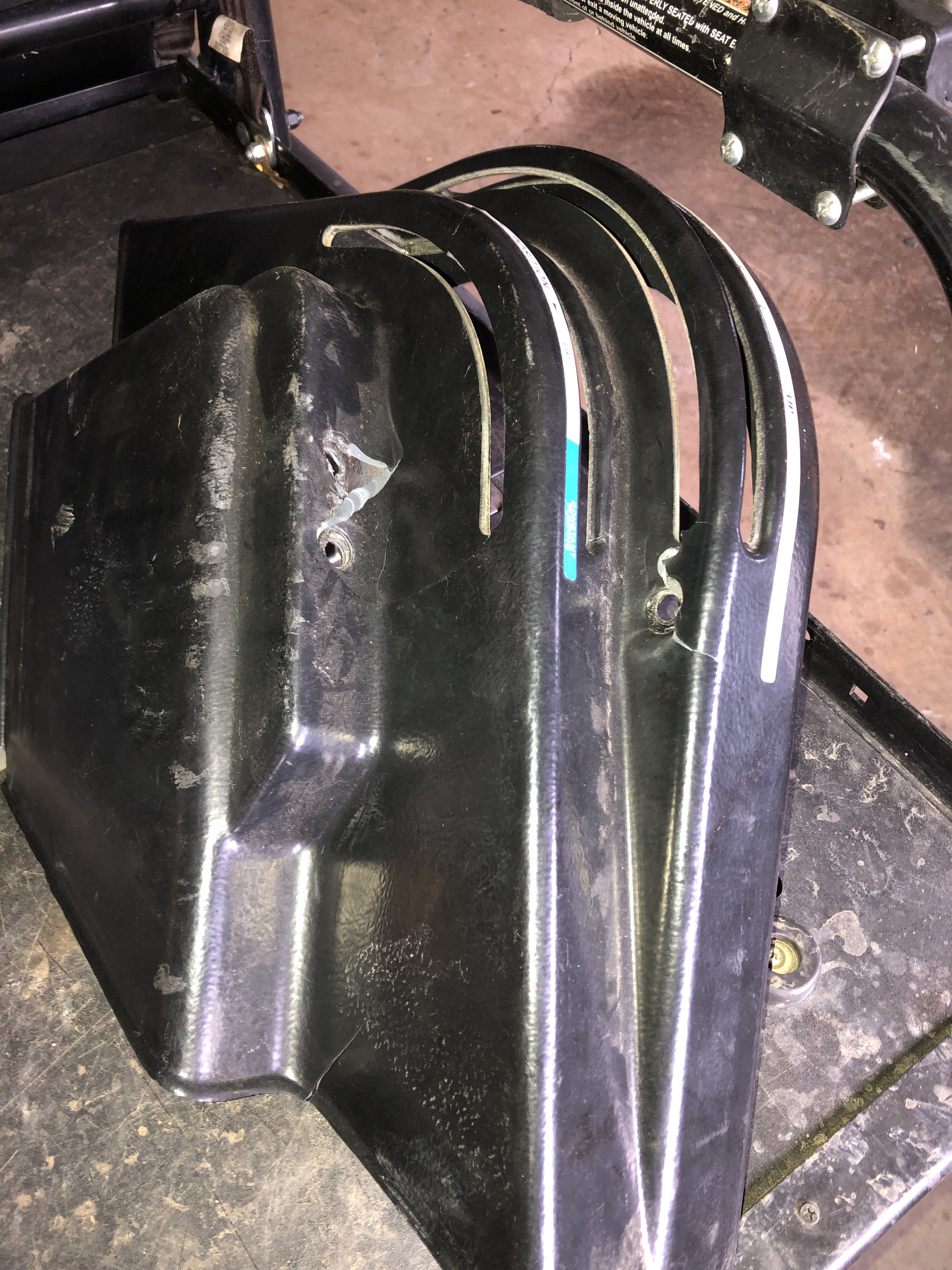

The only other issue now is that I believe they broke the black shroud that goes over top the draft and position control levers in the cab. I was having issues getting the stops to catch properly on the position control then discovered the plastic shroud was damaged in 3 places causing to stop knobs not to make contact with the position control lever. I believe what happened is when the cab was raised the handles may have caught the plastic as they remain stationary as the cab is lifted. It never seems to end does it? Lol

Well today was another repair day. Thankfully I could handle all this myself. First issue was the stops for both the draft and position control levers don’t engage due to the plastic shroud around them being damaged from when cab was raised for brake repair. I remove the damaged shroud and called the dealer to inform them of the issue. Thankfully they ordered a new one for me. The next issue was the lift abruptly stopped working correctly on Sunday and now only moves about 2-3 inches. After sometime while under the tractor I found a metal coupler that designed to keep both the draft and position control working together however the locking nut had come loose and was gone. Fortunately, I had two exact nuts so was able to use them to reattach the components. So next up was a leaky fuel line that had dry rotted in several locations. A quick trip to NAPA plus struggling to get into a tight place and finally all set. Man I hope next weekend presents less issues. Lol.
