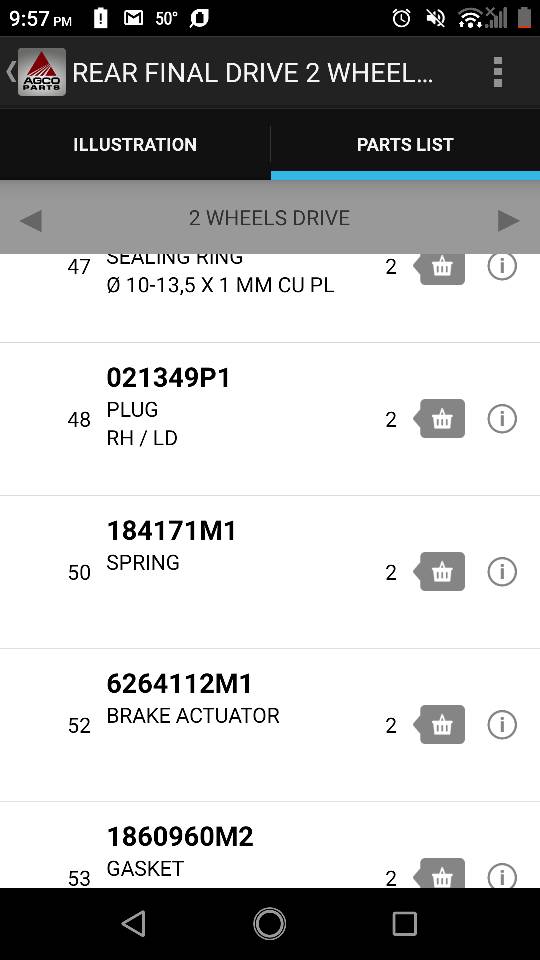

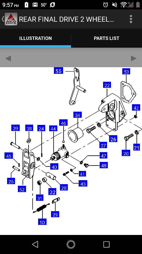

Maybe check if the spring is still in place too. Number 50 on the diagram.View attachment 638977View attachment 638978
You maybe onto something here. Dealer just contacted AGCO rep and was told replace the actuator spring as it’s been improved. I’m thinking this maybe it. Reason being as the tractor gets ran some and starts warm up sometimes the right brake starts working properly. Could this be because the fluid becomes thinner due to heat thus allowing the spring is then be strong enough to release as needed? They have ordered the part and will install it once it arrives.
