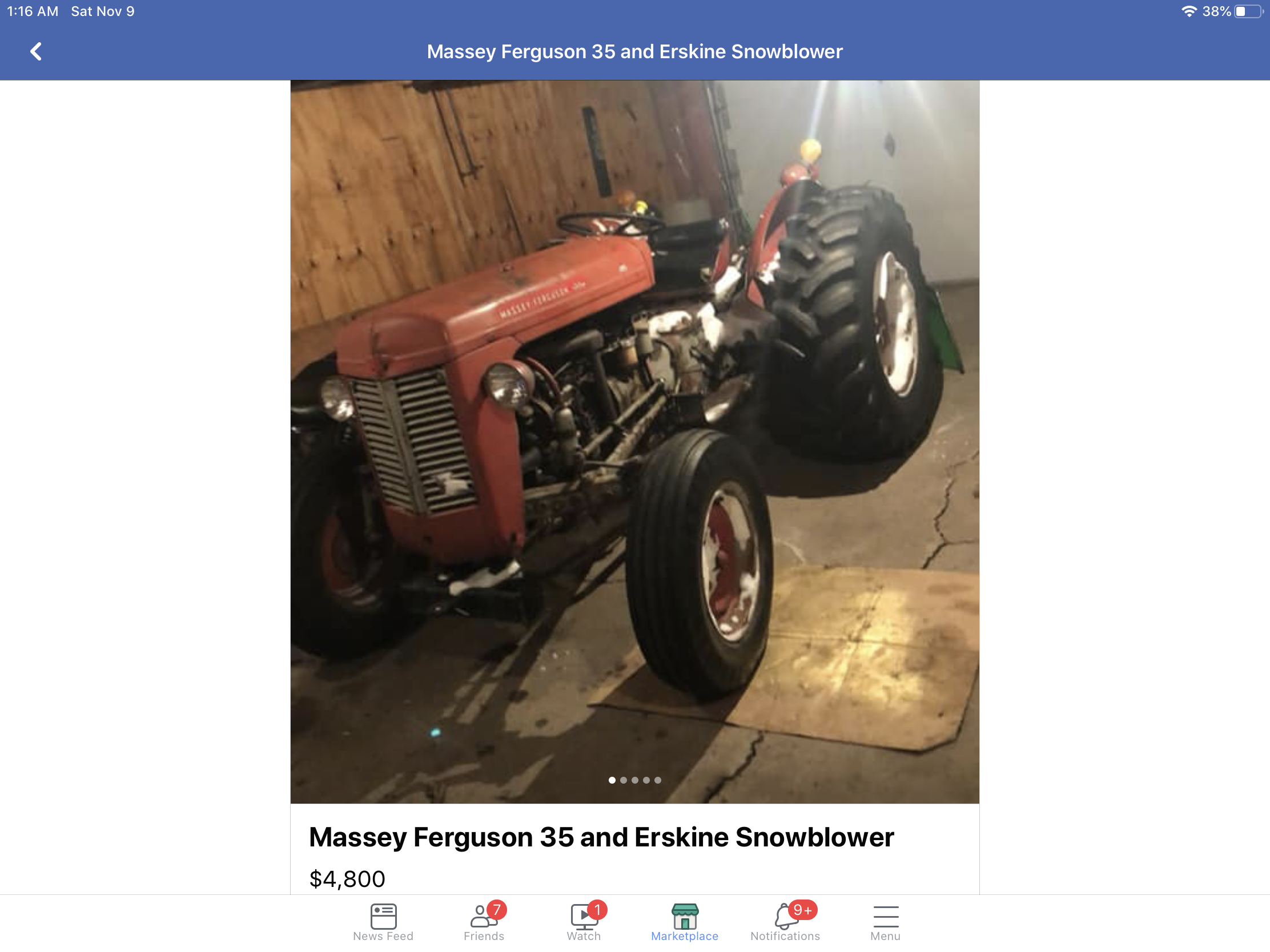

Not sure if this is right place but I came across this Massey 35 for sale not to far from me and it looks like it would be a interesting project to buy maybe, I know nothing about Massey tractors except that I have a 1705 scut.
What do you folks think about this?

Tractors have made an awful lot of progress in terms of ease-of-use and safety in the last fifty-five (55) years.
Manual steering on a 3,000 pound tractor gets old after ten minutes. No ROPS.
What use do you foresee for this machine?

You have to evaluate how much time and money you want to put into the project and what you expect out of it. Is it to be a show tractor or a work tractor? The 35 was a pretty good unit but it improved and morphed over time. It was based on the Ferguson TE 20 and the TO 20, later upsized to the TO 35.
/ Massey 35 #5
They were good tractors in their day. The Perkins 3 cylinder diesel is a better engine that the Standard 23c diesel that my TO35 has. Both engine and chassis parts are readily available for this tractor. Manuals are available. They are quite easy to work on. If you are looking for a project, you could easily choose a far worse tractor than this. It is a good choice.
/ Massey 35 #6
They are solidly built tractors, I have gotten 39 years of great service out of my TO35 with Continental gas engine. I have done a lot of bush hogging on rough terrain as well as plowing and discing.
/ Massey 35 #7
It's still sold new on some countries, it's probably one of the easiest tractor to own, you can buy all the parts dirt cheap, used parts everywhere, easy to work on. A servo kit is available if needed. The tractor without loader is not that heavy to steere.

It would be just a cleanup type of project not a total restoration but just cleaning it up and making it look nice, famous last words... not a restoration....I like the looks of the tractor and think it would be a good project if I could get one at a better price, this one was still available a few days ago, seems Everyone has Case, Farmall’s, McCormicks, 2n-8n and 9n fords so I want to do something different that you do not see a lot of around here and this has caught my eye.

When I was a lad, a lot of the small farmers around us had these tractors to work their small farms. 30 to 45 acres were about common. Some had the MF35, others had similar tractors. Ford Dexters and older Ford Majors, grey Fergusons, my dad preferred David Browns. There was also small IH and John Deeres for row work. The one tractor, no matter what type had to do all the work on the farm, The farms were as we called `arable`, meaning mixed crops from potatoes, wheat, barley, sugar beet, carrots peas, and various other crops the farmer thought he could make a profit on. The MF35 was known as a good little tractor, easy to use with minimum maintenance, and a good starter in winter. The only thing I can think of against them was that a few broke in half. They used to break near the clutch bell housing, saying that, some of the farmers were a bit cruel with them, FEL with weighted wheels and extra weights on the back, then mucking out the crew yard, was asking a bit too much. Yes a nice light game reliable little tractor without any fuss.
/ Massey 35 #16
How worn is it? I saw a similar one at my mechanic that the guy paid about the same for. Now, twice that for motor and steering box work. And then, it will be worth about what he paid for on the open market.

Not putting a loader on sounds like a good idea to me. Tractors without power steering aren't all that great for having loaders. This kind of tractor works best for pulling stuff like a disc, harrow, etc.
You are correct to a point. If it is a total pile of junk it isn't worth doing. But sometimes projects you do for the enjoyment of doing it don't always have to create a positive return on investment. Particularly if you plan to hang on to it after you are done. Fixing up an old tractor is seldom a wise financial decision. That doesn't mean it is a bad decision. I probably have $7k in my old TO35 over the last 30 years or so I have owned it. Probably didn't cost $2k new, and probably isn't worth much more than that now. I don't regret one dollar of that investment.

i like it is a diesel and it seems to be in somewhat good condition for its age, don’t think it will sell to fast but with snow coming you never know. It is about a hour away from my home. I will keep my eye on it and if it is still available later I might make a offer on it after I look it over. Would be a fun project when I get my new shop built.
