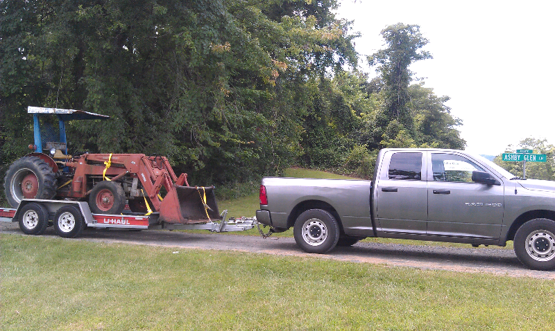

That looked exciting, and painful. Glad no one was hurt.
I rented a u-haul car trailer ($70) to pull my 2135 tractor home last month.
