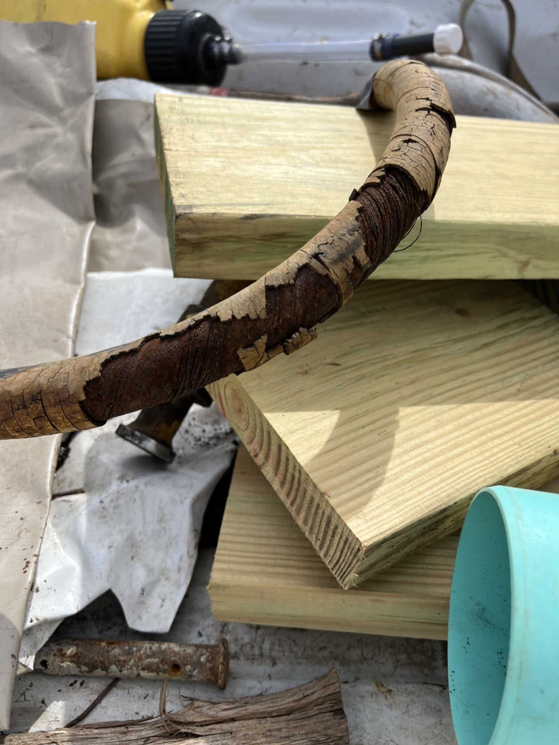

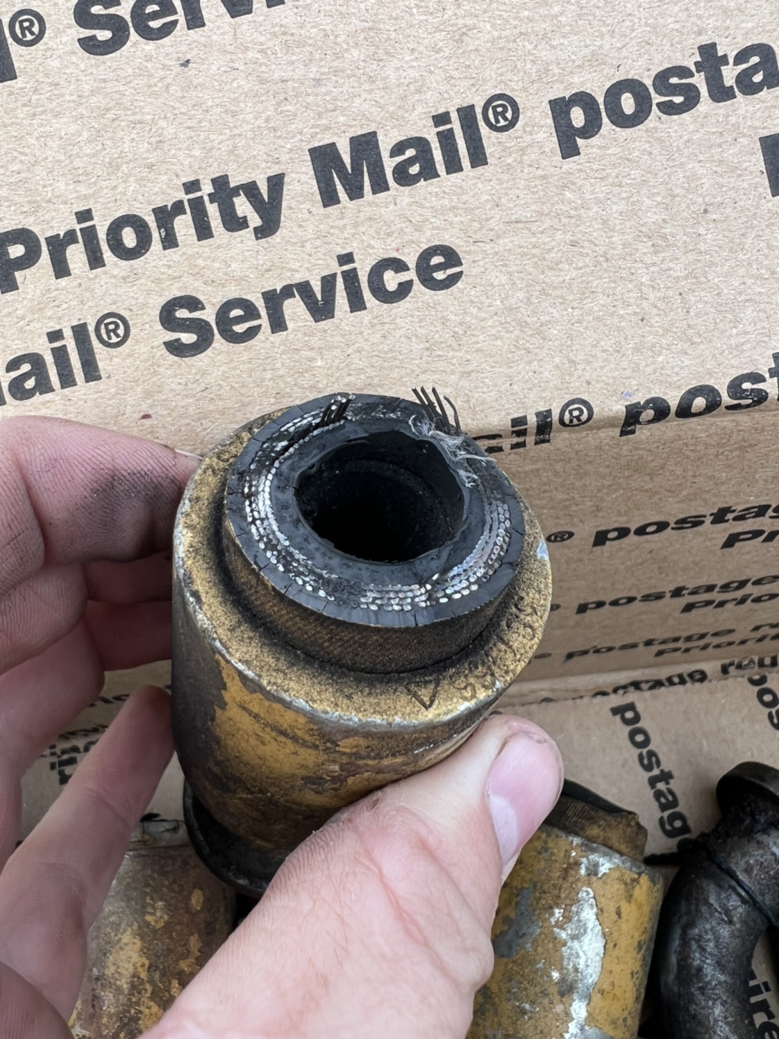

Here’s one of the 5 hoses I pulled off my dozer. It was still working and I’d have probably left it alone if it wasn’t likely to cause a fire if it blew. That hose is over 40 years old. I cut it in half and the inside layers actually looked pretty good.
   / Massey/Agco vs aftermarket replacement hydraulic hoses and replacement interval #17
That appears to be a 4 braid.
Some real heavy duty stuff.
   / Massey/Agco vs aftermarket replacement hydraulic hoses and replacement interval #18
Here’s one of the 5 hoses I pulled off my dozer. It was still working and I’d have probably left it alone if it wasn’t likely to cause a fire if it blew. That hose is over 40 years old. I cut it in half and the inside layers actually looked pretty good. View attachment 856198View attachment 856199
As long as they are not exposed to sunlight, thats possible. Your hoses were obviously in the engine bay and quite protected.
Hoses on the loader are exposed to all kind of threats. Sunlight, physical impacts and constant movement.
