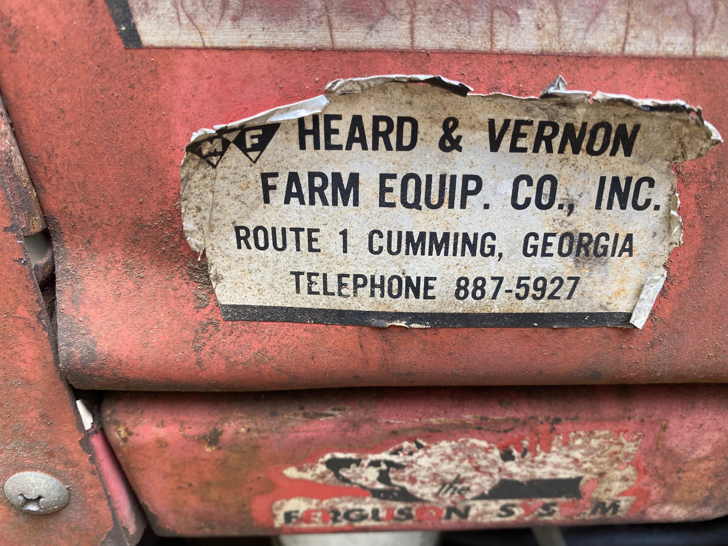

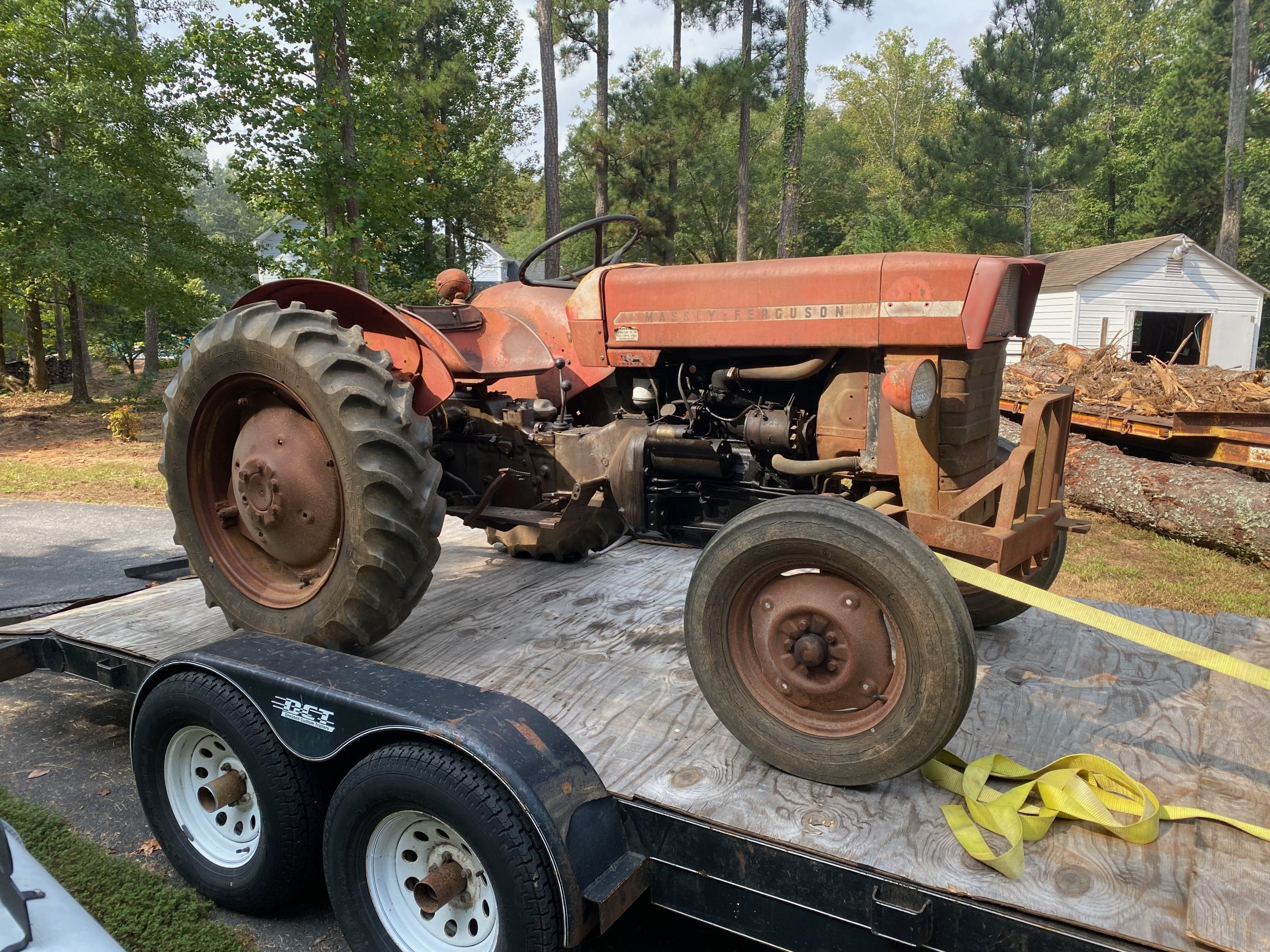

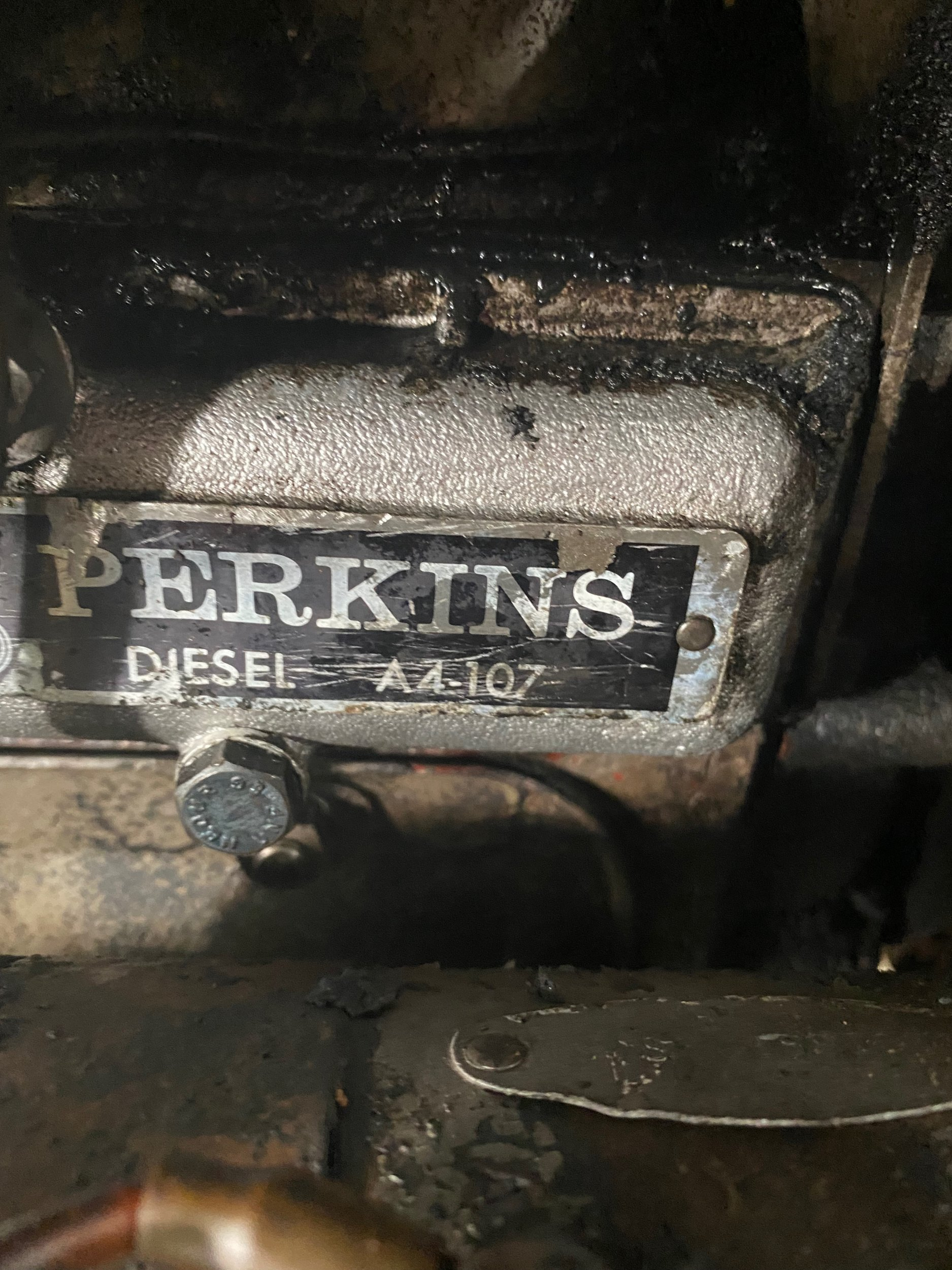

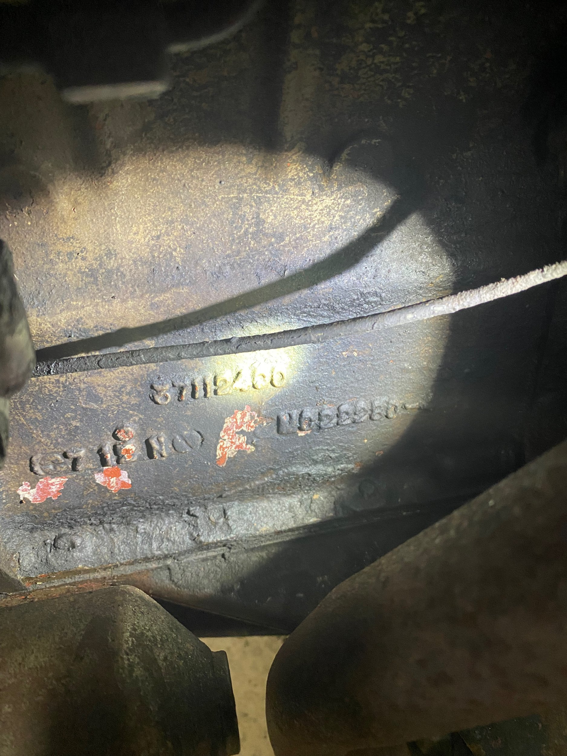

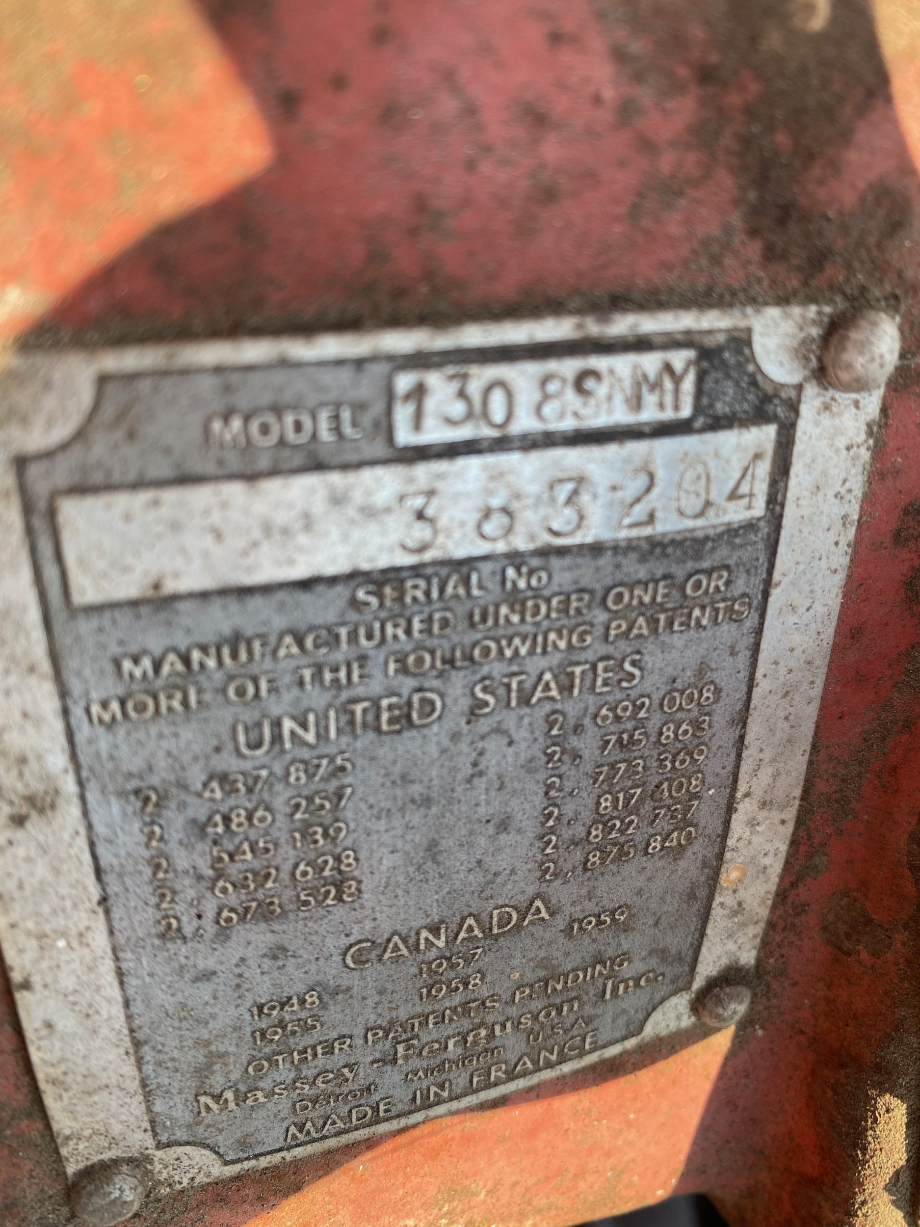

I see this is the place to learn about my tractor. It appears to be a 1964, Model number 1308SNMY, Serial on the plate: 383204, serial number on the block and head is 37112460. I know she was made in France, and imported to Cumming Georgia. There is a "dealer" sticker still on the side of her which is for [Heard & Vernon Farm Equipment, Co. Inc. Route 1 Cumming, GA 887-5927] Which is no longer in business. She is great little tractor, however she has a couple issue I need to get sorted.
So far I have replaced all the gauges (nothing worked when I got it). I have replaced the brake pads (super easy with the slide out holders), and added new headlights. I had to add a light switch as well as the original was shot. The injector leak, and so does the water seperator. The injectors are not as bad as the water seperator. The water seperator drips slowly. Someone has tried to "fix" the WS and the bolts are stripped and seized. I need to replace all of the injectors (new or remanufactured) and the WS. Could anyone help me with part numbers (or a link) to purchase new ones. I also need to replace the rear light (I assume it was amber) . I have have the housing and ring but not sure what goes inside. Lastly someone has harvested the 130 hood emblems off of her. I would love to find something to put in place (does not have to be original)
Thanks in advance. Cameron
P.S. I am not going to factory restore her, but I want her to run well and live on. We have cleaned her, and given her a could of coats of clear coat. The patina paint looks cool.

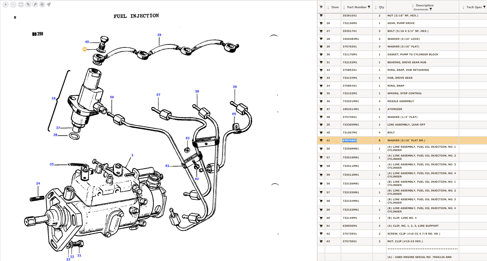

I went on to https://mytractor.us/ and spoke with a very knowledgeable lady named Sue. She was able to sell me a new water separator (the unit on the 135 is an exact replacement). She also sent me a schematic (I have included that here) of the injector / pressure pump assembly. She suggested I replace the 5/16 and ½ inch copper crush washers (which I can buy from advanced auto). There is also a leak-off line assembly for fuel collection that has been known to leak, so I will replace those rubber tubes as well. I do know the rear light is a 5 ½ inch sealed light, and I am searching for that now. Lastly the 130 emblem is very hard to find. No one makes them. If anyone happens across them (or knows something that can 3D print them) drop me a note.
I will let you know how things go with the above. As always I will take pictures.

The part number you require for the injectors is
1447768M1 and are available with a dealer I use in France and are 58usd each plus postage but you may be able to get them in the US
The year of manufacture of your tractor is 1967! the last serial numbers for 1966 was 381989 and the last serial number for 1967 was 38526, as yours falls in between these numbers it is defiantly a 1967 model

If you let me have your serial number I will date your tractor for you, as you can see from Georgia posting above there is a picture of the serial number plate (IMG_0921JPEG) if yours is missing I can tell you were to find it on the tractor

Serial Number 3866874
Eric
/ Massey Ferguson 130 - parts help #10
Hi Eric
The serial number you give has 7 numbers; MF 130 had only 6?
If you have 386871 then yours would be a late 1968 model
regards
BOBUK
/ Massey Ferguson 130 - parts help #11
Hi Bob,
I zoomed in on my photo closer of the SN and I see that I mistakenly thought the last 2 were 71 when actually it's 4 so my SN is 386684 not 3866871. Thanks for pointing that out.
/ Massey Ferguson 130 - parts help #12
Hi Eric
So yours is still an 1968 model
Type
LAST NUMBER 31 October
1967
SNMY 385261
1968
SNMY 386831
YOUR SERIAL NUMBER
386684
SO YOUR TRACTOR IS A 1968
