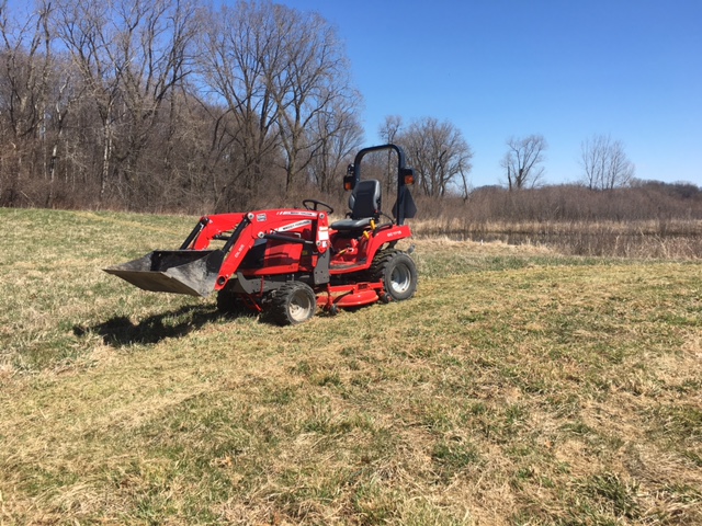

When I bought my tractor, the mower and tiller that came with it were not put together. The dealer offered me a discount of $200 each if I did it myself, I said no problem. Last Sunday I sat down with the mower manual, and installed the blades on my 2315 mulching mower. Filled the gear box, greased the zerks. I'm going to be tilling up the area by my pond that used to be clover and alfalfa, so I mowed it down to be ready for an application of round up. I was very pleased with the mower's power to mulch this grassy area up, never bogged down once.

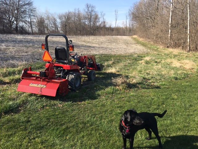

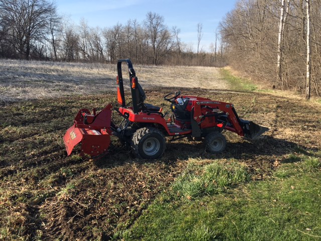

I hooked up the tiller today. Much more involved than the mower. You have to cut the pto shaft to fit your tractor, and that was interesting. The manual shows you how to do it, but the first time is always a challenge. Checked the gear box for oil, checked the chain box for lube, greased all the zerks, and had to "run-in" the slip clutch. Apparently, the clutch needs to be loosened and allowed to slip after it sits for awhile. If it locks up and you break the gear box because you didn't perform this operation, the warranty is not covered (says this right on the pto shaft cover). I loosened the 8 nuts on the clutch, and it slipped just fine.
I couldn't wait for it to dry out like it should, so I tilled up an area where my asparagus is planted. Lots of heavy grasses in this area, and the tiller made short work of it. Very impressed with the operation.
