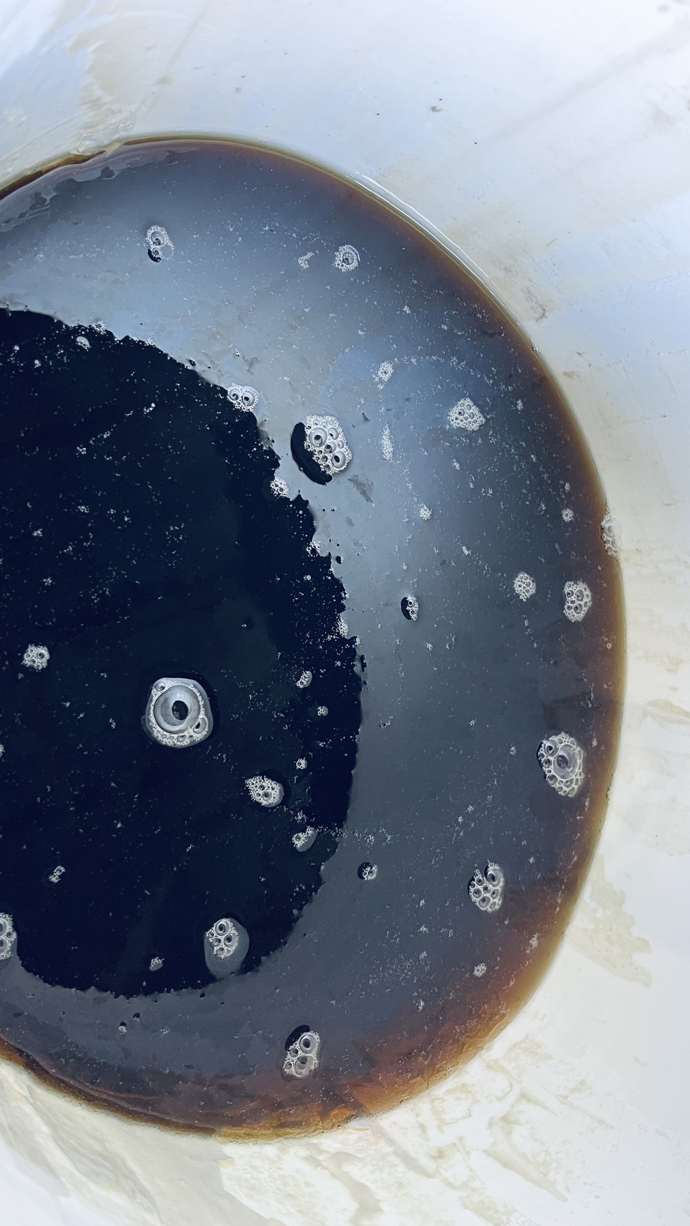

So today before my draining, I did the ole 40, had plenty of power during and when the power started to lag, I put her in the pole barn and immediately drained the Hyd oil. I was expecting it to be hot, but it was actually like a very warm shower, like that you'd have during the winter.
I also thought it would be milky-ish, well I was hoping anyways as then I thought I could start pointing a finger at something. Here is the pic of some of the 7.5 gls that came out...
   / Massey Ferguson 1740M Hydro: LOSS OF POWER when hot! #29
"Like a warm shower" doesn't seem very hot then. While I don't have a lot of experience with hydro oil doesn't that look pretty dark? Is what you are putting in more clear?
With your new fluid it will be interesting to see if after running for a while, 40+ min if you experience any sluggishness.
#30
I was surprised, I was anticipating my fingers almost getting "scorched" while taking out the oil plug (during in the last few turns).
To me as well; Oil did look dark, but maybe b/c I used a white used drywall mud bucket?... used this as it was a tad lower to get under the tractor belly better. I then dumped those loads in group of 3 into my bigger oil recycling pails while noticing the more darkness than the new. At least so it appears.
Not sure if this is normal or not?
