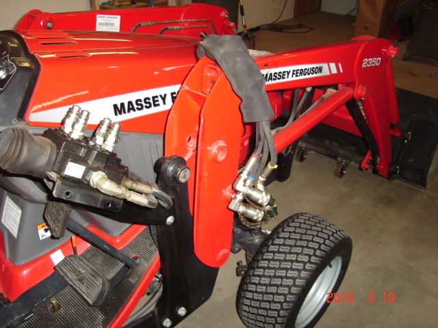

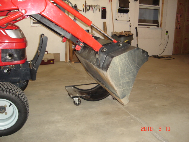

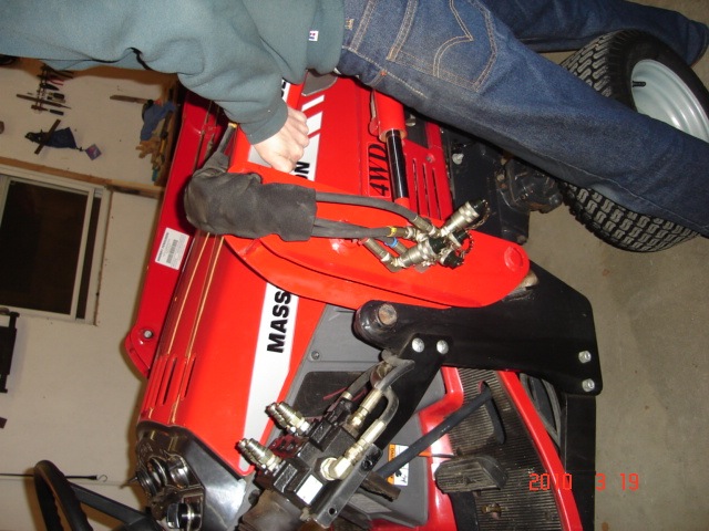

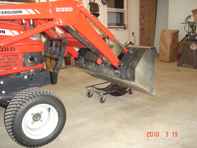

Phil, here are some shots of my 2310. To remove the FEL, I use a flat 4-wheel dolly: lower the bucket onto it at a slight angle outward; then, with tractor shut down, move the joystick so it settles down flat on the dolly and on its two "feet" that Ray was talking about. At that point, the pins will slide right out. I then re-start the tractor and move the joystick forward, IIRC, and the two arms will rotate forward and away from the frame on the tractor.
At that point, I relieve pressure and disconnect the hydraulic lines, then lift the bucket arms, one at a time, forward and out of their sockets. Then the tractor can be moved rearward, away from the FEL, and I can then, by standing between and lifting on both the hydraulic rams at the same time, maneuver the FEL into position for storage, rolling it along on the dolly. Just don't forget to put the two feet down at the beginning of the procedure! Sorry, but it looks like the pics are in reverse order.
Hope this helps. ijk

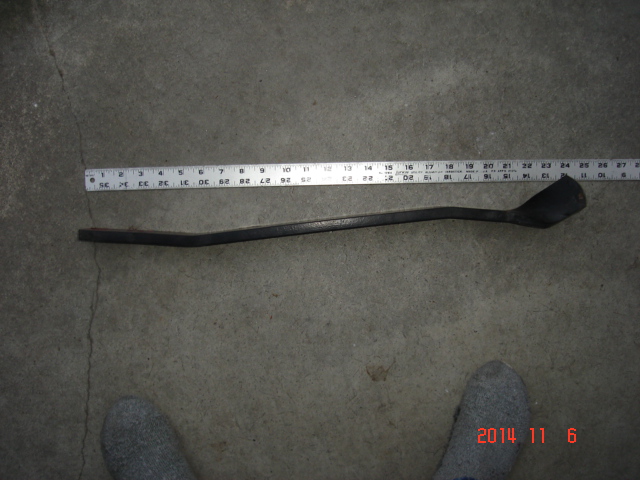

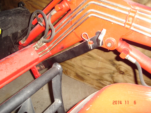

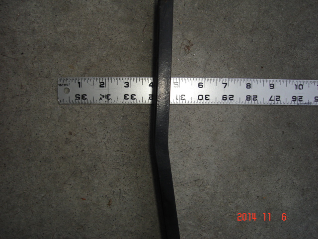

Phil, are you saying your FEL doesn't have the black stand arms at all?? Here are some pics of the left arm; the two legs appear to be mirror images of each other. Total length is about 24-5/8", but as you can see there are a couple of angles and one twist in it at the bottom. Steel looks to be a solid 1/2" thick. Second pic is the semi-permanent clip that holds it in place at the (lower) hinge point, next to the last pic is the right leg, in its stowed position along the FEL lift arm.

i bought it used, those two arms were not on it. he said he never took off the loader, cutting grass with the loader on seems like a pain, but he didn't mind. just seems like the added weight that's not needed would add wear to the tires and front axle ( 4 wheel drive). i did notice some oil leakage under the right front axle, under the planetary gears, next to the wheel. i will have to look into that and see if there is a seal i can replace. thanks for the dimensions, i can get some 1/2'' flat stock from work and add feet to it.
