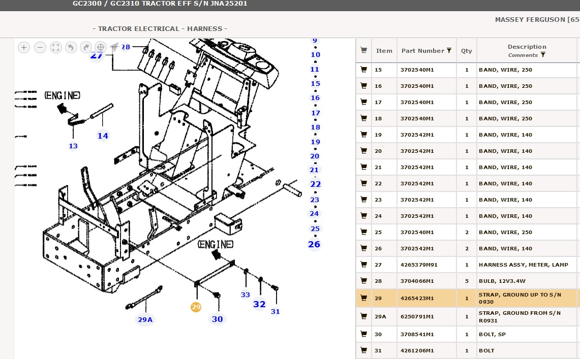

   / Massey Ferguson GC2300 Need Advice on Loading on trailer #9
The ground strap on the front of the engine to the chassis has been known to break. Some were too tight and engine vibration eventually broke them.
That being said, the GC2300s have a lot of corrosion issues with the fuse box. Even if the fuses are ok, the connectors inside the box may have to be cleaned.

   / Massey Ferguson GC2300 Need Advice on Loading on trailer #10
I have no ideal on the Gc2300’s, but on my old tractor the fuse block gets power from the ignition switch. Thus while corrosion at the fuse block would cause all types of electrical issues, it would not causes issues with the starting circuit.
