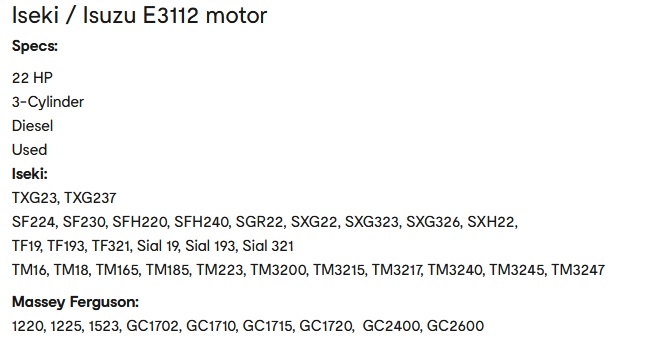

Purchased a non running 2008 GC2300. Replaced starter, battery, ground strap and bottom radiator hose that had hole from throttle cable rub. Turns over but will not start even after bleeding air from lines. Low compression on two cylinders, 500, 150 in center and 350. My guess head gasket from over heating due to lower radiator hose issue. Soaking rings now to see if compression comes up. Anyone pulled a engine from this machine? Any advise is appreciated. Should also mention it has 870 hours. Anyone know of a good rebuild kit?
/ Massey GC 2300 engine issues #2
No engines have been replaced by forum members AFAIK. Good chance it is the head gasket. Aftermarket gaskets are pretty cheap on Ebay. All the GCs use the same engine, and several other tractors as well. Double check on Agco Parts Book to ensure you order correctly (it has pictures of all gaskets).
