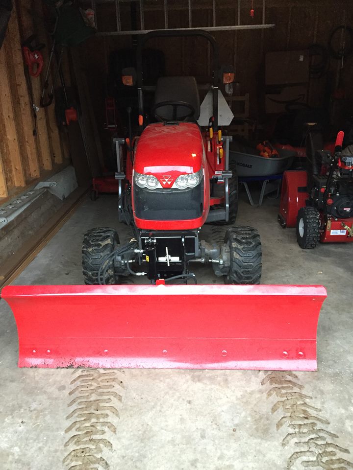

   / Massey GC1710TLB - getting ready for winter #25
I'm ready!
   / Massey GC1710TLB - getting ready for winter #26
I'm ready! <img src="http://www.tractorbynet.com/forums/files/massey-ferguson-owning-operating/448931-massey-gc1710tlb-getting-ready-winter-massey-blade-jpg"/>
That makes two of us.

   / Massey GC1710TLB - getting ready for winter #28
My turf tires are by now worn down some (7+ years); I used to leave the backhoe on for traction --it works!!-- but my driveway has a steep upslope and I found the steering was just shy of totally non-functional going uphill, so I eventually took the BH off. That gave me back my steering (and made it much easier to maneuver) but necessitated the use of 4WD almost all the time, but hey- no problem there, either.
Only had to put chains on once, which was last year after a "freezing rain/wet snow/more rain, then temps dropping" event. Only time so far, and the chains certainly did the trick. Otherwise, I've had no trouble (well, maybe a little every now & then) with using the turf tires, with the blower clearing the road ahead of the tractor.
Still waiting for a set of blades from Jack's Small Engines for the MMM before I put that away for the season, then need to remove & store the FEL and get the blower back out & mounted-- but I'll be ready!
