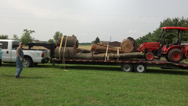

Go with a 30' gooseneck and you will never look back or want a bumper pull again. I have a short bed f350 and there are no issues pulling a goosneck. Don't get 7k axles you need 8k or larger if you go single wheel gets load range g or 17.5 well worth the extra money.
I have pulled my set up with older f350 and current 12 f350 and my 97 f450 all do fine up to about 22000 on the trailer as I run out of trailer tire.

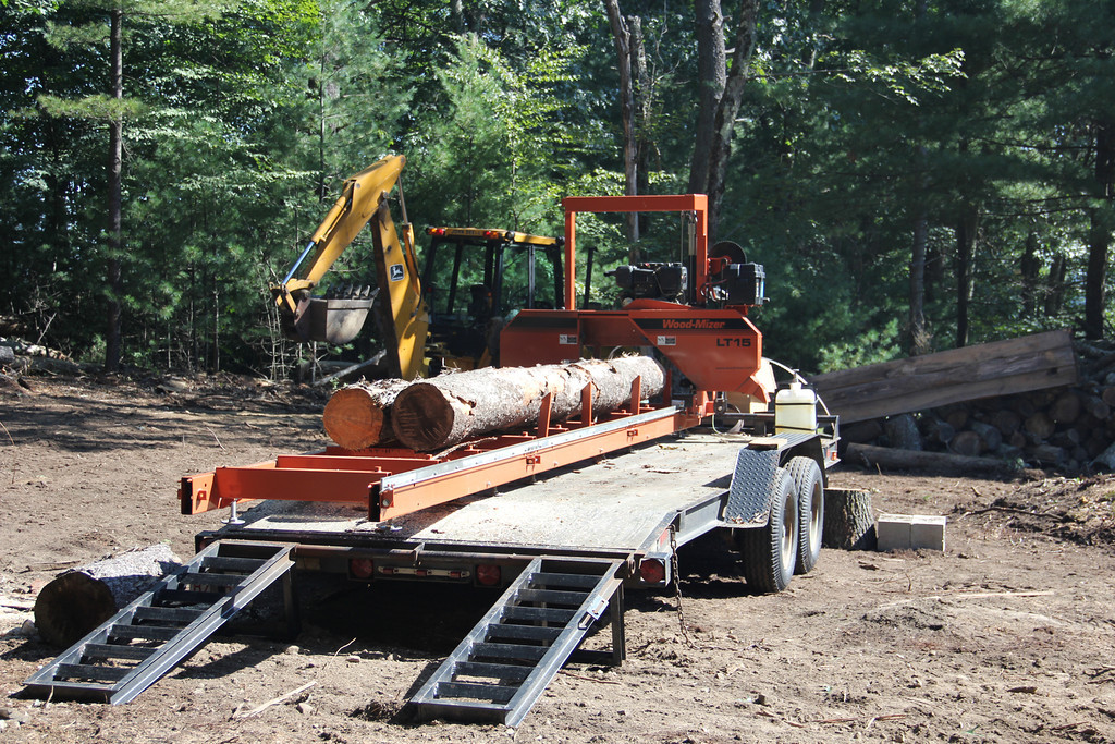

Rusty, have you used both? The reason I ask is because my current trailer is a dovetail with fold up ramps and I hate it. I know it isn't good to hang the rotary cutter off the end but I would love to be able to let it overhang a few feet, whereas now I can't, because the ramps are always in the way. I haven't used a flat deck trailer but I can't see why it would be a big deal. I would really only use it for equipment, and not a car or anything that needs a shallow angle of approach. I feel like I would get more usable space with a flat deck.
The other use I have for the trailer, is to lay my Woodmizer sawmill on it for when I want to do a mobile job. The mill is not a trailerable model (LT 15) but is easily setup on a trailer. I've done this on my current setup but it overhangs as well.
I also do not like how little clearance I have on the back of the tractor, more than one occasion I have scraped/dragged the bottom of the trailer on a customer's driveway, I have to be really careful of that.
