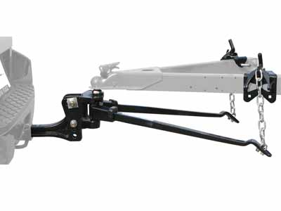

Is a Class 5 hitch and WD hitch, easily retrofitted to my truck? How much would something like that cost?
Weight distributing hitches will work on about any hitch receiver. You also need room on the trailer front rails for the connectors for the spring bars. This setup is normal and common for anyone with a bp travel trailer.

You can get a Reese Titan hitch for about any 3/4 ton truck up. They will easily handle the tongue weight you want.

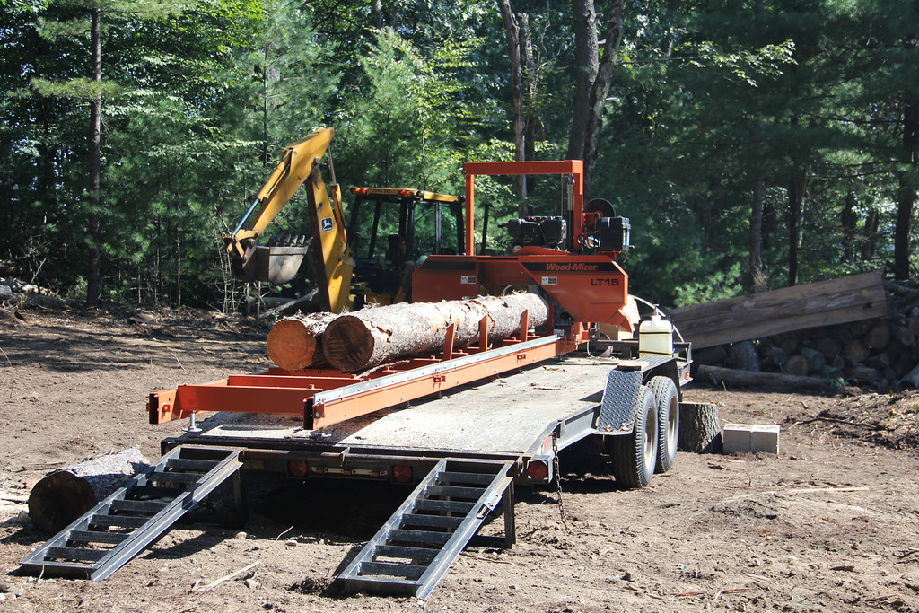

Rusty, have you used both? The reason I ask is because my current trailer is a dovetail with fold up ramps and I hate it. I know it isn't good to hang the rotary cutter off the end but I would love to be able to let it overhang a few feet, whereas now I can't, because the ramps are always in the way. I haven't used a flat deck trailer but I can't see why it would be a big deal. I would really only use it for equipment, and not a car or anything that needs a shallow angle of approach. I feel like I would get more usable space with a flat deck.
The other use I have for the trailer, is to lay my Woodmizer sawmill on it for when I want to do a mobile job. The mill is not a trailerable model (LT 15) but is easily setup on a trailer. I've done this on my current setup but it overhangs as well.
I also do not like how little clearance I have on the back of the tractor, more than one occasion I have scraped/dragged the bottom of the trailer on a customer's driveway, I have to be really careful of that.

You need to look at the capacity of your hitch. For example, my f150 with max tow package is rated for 500/5000 without WD and 1150/11500 lbs with a WD. This is the case even with some 3/4 and 1 ton trucks of recent history.
Yes it is safer and improves ride quality. Second, it could be because of structural issues but have no proof. The torque from the WD bars apply load to the front mounting bolts on the hitch spreading the tongue weight across the entire hitch. Without a WD hitch, the entire tongue load is supported only by the rear most bolts on the hitch through the truck frame. All that stress is also just applied to the frame at those two locations.
