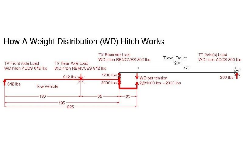

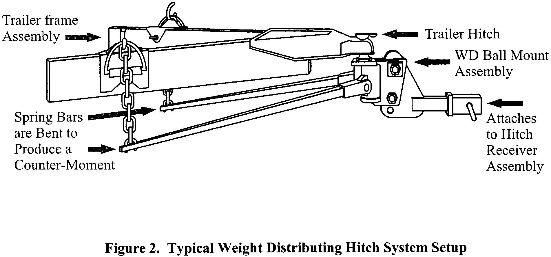

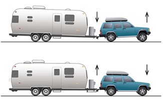

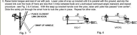

The key to understanding how they work is the spring bars are raising the back of the Tow Vehicle by twisting the receiver hitch, raising the rear of the truck, which adds weight to the rear axles of the trailer and the front axle of truck.
FastwayE2WeightDistribution.jpg HowWDhitchWorks.jpg original.gif RoundbarReesesetup.jpg
Types of hitches: Types-of-Hitches.jpg
<img src="http://www.tractorbynet.com/forums/attachment.php?attachmentid=327574"/> <img src="http://www.tractorbynet.com/forums/attachment.php?attachmentid=327575"/> <img src="http://www.tractorbynet.com/forums/attachment.php?attachmentid=327576"/> <img src="http://www.tractorbynet.com/forums/attachment.php?attachmentid=327577"/>
Types of hitches: <img src="http://www.tractorbynet.com/forums/attachment.php?attachmentid=327578"/>
Thank you, I do understand it now and appreciate your efforts to explain it. I can see how a WD hitch would do nothing but help in my situation.
Okay so I'll need a heavier hitch setup, a WD hitch, and a 26'-28' 16k deck over flat deck trailer with 8' slide in ramps. Sounds easy enough! Just need the money now!

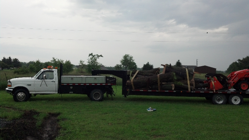

Couple of things I have noticed,
1. Pulling the loads you are looking at I would us a pintle hitch much easier to hook up and stronger. Also it would allow more movement offroad.
2. No way in would I pull a triple single equipment trailer. The may work fine on open road but in town or on farm just to hard on tires and rims. Yes I had one and yes I broke rims and rolled tires off.
3. Find a buddy with a gooseneck trailer and go for a ride with it loaded it will change your mind on goosenecks.
Just my thoughts everyone has likes and dislikes thus the reason for so many different trailers being made.
Fyi you said you may go to a topper on next truck? If your doing this for a second job get a service truck to work out of.

Is the WD hitch more for a better ride, and safer towing, or is it more so the weight of the trailer doesn't physically damage the hitch itself? As mentioned earlier, I've never been driving the truck and towing and felt any sort of ill effects such as too much tongue weight, too little, or anything like that. The rear end has never sagged any more than level. I have even stiffer springs in the rear than it came with stock, and had an airbag setup but removed it because I never once needed it. I've loaded the back up with just over 3k lbs of concrete and it didn't even sag....
If the WD hitch is for the hitch integrity, then i may be slightly worried about it, but if it's for a better ride, I can't say I've ever felt that I don't have a good ride already. Although, I have certainly noticed differences, and heavy loads of course, but I have never felt unsafe towing, like I have in lesser trucks/setups.
If I go with a larger bumper pull, I do plan on upgrading my hitch and going with a WD hitch, but only because I've read that I "should" on this website, I don't actually understand how they work and why I "need" one?
A WD hitch allows you to put the recommended 15% on the hitch without overloading the truck rear axle and without the truck front end getting light (poor steering.) Yes, you can balance the trailer to minimize the load on the truck without a WD hitch, but then things can get weird when the trailer suddenly starts wagging the truck.
