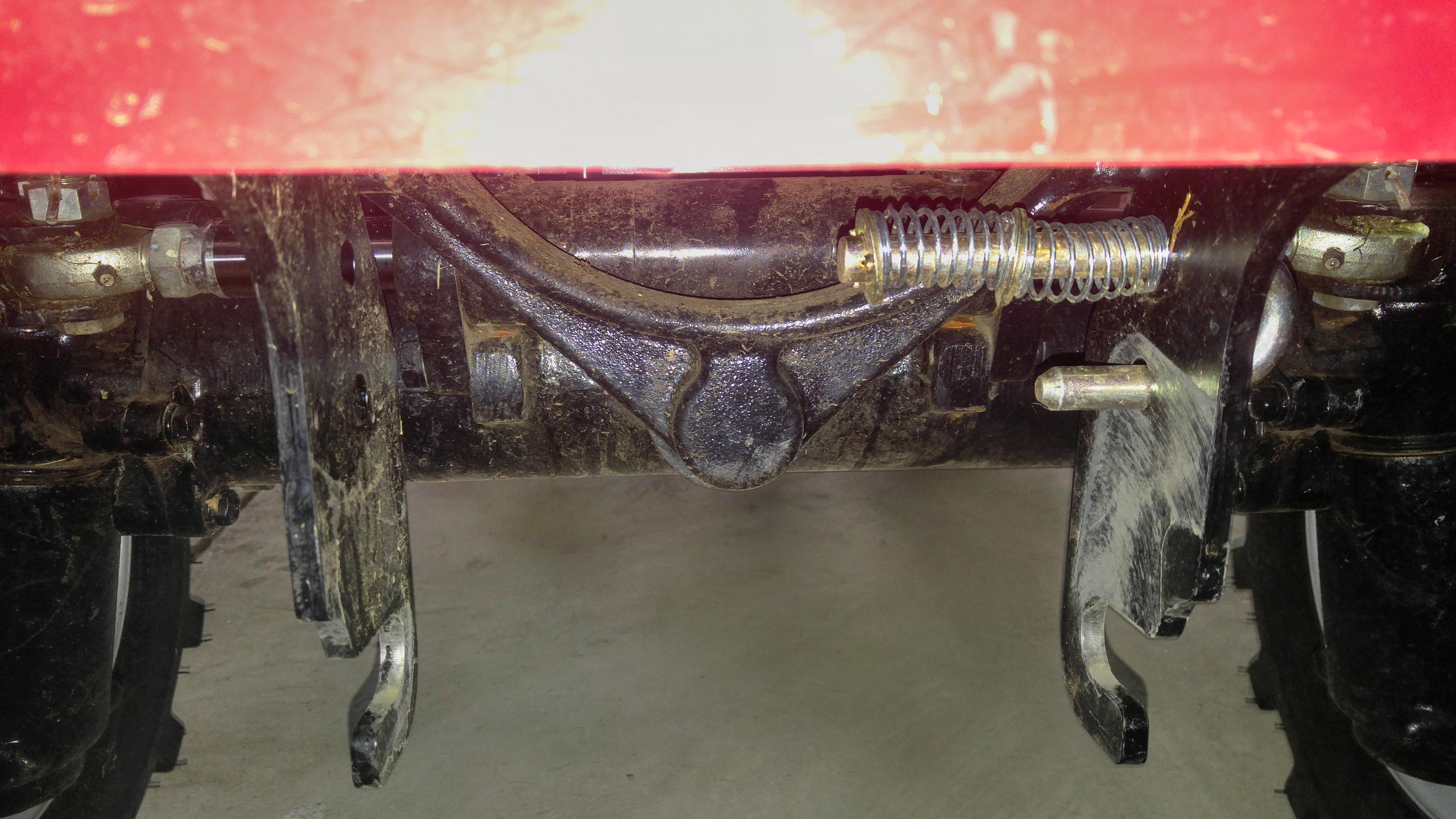

/ MAX 22 4 years in #8
If the dealer has a picture or you can snap one with your phone I'd love to see where that is!!
hope this picture works
/ MAX 22 4 years in
#9
Cramby, I know where the pivot is, what I don't see a Zerk in your photo, unless I am missing something. Surely they can't mean just trying to squeeze some grease in on the surface.

Service manager says there is no zerk, nylon bushings replaced the grease fitting. He said the max 28 had a grease fitting.
/ MAX 22 4 years in #15
Is your tractor a MAX or E Max? I just looked at the parts breakdown for both. Both show the pivot pin in through the front with a zirk and nut behind. I wonder if your zirk may be on the frame. Try jacking up the front so you can pivot the axle and peek in each side.:confused3:
/ MAX 22 4 years in #16
Its a max 26 xl. we looked on one at the dealer and found none. But I will look harder on mine.
/ MAX 22 4 years in #17
Just looked at the service manual for R&Ring front axle. No zirks. Manual says apply grease when assembling.Looks like at some point you owners should pull the front axle pivots and lube.:rolleyes:
