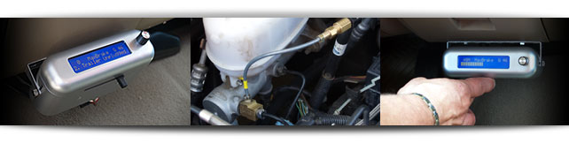

Does any of you guys or gals have any experience with the Max Brake Controller? Here is the site: http://www.maxbrake.com/
I install quite a few brake controllers. I use everything from Reese to Prodigy and have never been happy with any of them after buying my 2006 Ford PSD F-350 with its tow command system. It is hands down the best one I have used and I have probably used 50 different controllers in my 20 years of towing.
For those of you who are not familiar with the Ford Tow Command System it uses a pressure sensor mounted in the master cylinder to apply proportional braking to the trailer brakes. The harder you press the brake pedal the more power is sent to the trailer brakes. It takes very little adjustment compared to aftermarket controllers and allows the brakes to work in reverse without use of the override switch mounted on most controllers. This is important in my line of towing since a 20,000# or heavier boat will pull a 1 ton truck down the ramp no problem, even in park. GM also has a built in trailer brake option now but I am not sure how it works but I assume they did as Ford did and use a pressure switch on the master cylinder.
I saw this Max Brake system being installed on TV last week and was very impressed. It looks like it uses the same technology as the Ford system. It was tested against a Prodigy P3 and was able to best the stopping distances by 40% on average. They were using a 1 ton dually and a tri axle goose neck car haul trailer. The Prodigy P3 took over 500 feet from 55 to stop and the Max Brake took just over 300 feet.
So enough back ground info. Has anyone used one or installed one? The site says its a easy install, about 1 hour. They have a video to show how to do it on a 7.3 Ford.

You do not have to cut into the brake line. All you do is remove one line from the master cylinder and install a "T". On one side goes the break line you removed and on the other side goes the pressure sensor. Here is a pic of the system and how you install the "T". All you do once its installed is loosen the pressure sensor then pump the brakes and tighten to bleed. No need to bleed the brake line because it remains full of fluid.
I have used the Jordan. Its the one that has a linkage that connects to the brake pedal itself and is better than some but is no match for the Tow Command System in my opinion. I am guessing the Max Brake system will be a better yet.

How does such a hydraulic system account for the actions of the ABS system on the vehicle? With a hydraulic brake controller, if you push your foot all the way to the floor, the trailer brakes will probably lock up, but the ABS controller may only be actuating the vehicle brakes 10% of the time if the pavement is slippery.
/ Max Brake Controller????????????
Actually it works very well. It will actually prevent a jack knife and shorten stopping distance just as anti-lock brakes on our vehicles has. On the Ford system and the Brake Max system as your vehicles wheels lose traction the anti-lock system modulates the hydraulic pressure in the master cylinder. In these cases it would also cycle the trailer brakes preventing lock up thus shortening the total stopping distance because the pressure switch is installed between the master cylinder and the caliper of the tow vehicle.
At least this is the way I understand it.
Chris
/ Max Brake Controller???????????? #9
I think it's probably pretty good, but anyone who installs one better hope that little "T" fiiting is built to some tough specs. If that T lets go, you'll lose all your brakes. :eek:
I don't like the idea of modifying my brake lines, especially if it's anything like the cheap Chinese fittings I have seen let go in other plumbing systems.
I'm not sure about the ABS working on trailer because that usually requires an ABS sensor to be mounted on an axle. Maybe there's a way they get around that. Not sure.
I agree with you that you could loose all your brakes but if you are thinking when or if it ever happens you simply reach down and activate the manual lever on the brake controller unit itself. In this case you would be using the trailer brakes to haul down the entire load so stopping distance would probably be 5 times that of normal. In the end you are not modifying anything per say. You are just putting in a "T" fitting and then reattaching the factory brake line on one end and installing the supplied pressure switch on the other.
As for the anti-lock thing. On my Ford with the Tow Command System when the trucks wheel brakes go into anti lock mode it is modulating the pressure coming from the master cylinder, thus also modulating the pressure to the brake controllers pressure switch. I am assuming the same would happen with this aftermarket system.

This isn't consistent with the purpose of ABS. The point of ABS brakes is to control the braking of each wheel independently of the others. If you modulate the pressure coming out of the master cylinder, that affects all the wheels the same, which is no better than the old days when we used to pump the brakes with our foot.

But looking at my trucks I have 4 hard lines coming out of each master cylinder. I am guessing that means each wheel has its own circuit from the master cylinder. This would allow the master cylinder to do the controlling of the anti-lock brakes. I am just guessing how it works. I have only done simple pad and rotor changes along with some shoes and drum changes and changed a few hard and flexible lines. I have never done any work to the anti-lock system or master cylinders so I really am asking others for input.
I guess what I really need to do is visit my Ford garage this week and find out exactly how my Tow Command System works and then call Max Brake and get someone on the phone who know his stuff.

This intrigued me so I went off and read about Tow Command. It's an option package that includes something called IBC, integrated brake controller. IBC takes the output pressure of the master cylinder and the truck's speed, sends it to one of the computers, which produces the proper trailer brake voltage given those inputs. During an "emergency braking situation", which I have to infer is determined by looking at the behavior of the ABS sensors, the master cylinder modulates it's output pressure. This causes the electric signal to the trailer brakes to also be modulated, equivalent to pumping the brakes. By installing the "T" into the hydraulic system at the master cylinder, it's possible to use that modulating pressure directly to pump the trailer brakes. The truck's ABS system continues to control each wheel independently. Very slick.
If the fitting should fail, you'll only lose the brakes (front or rear) on the line you install the 'T'.
The other line (and again, front or rear) will still operate normally.
