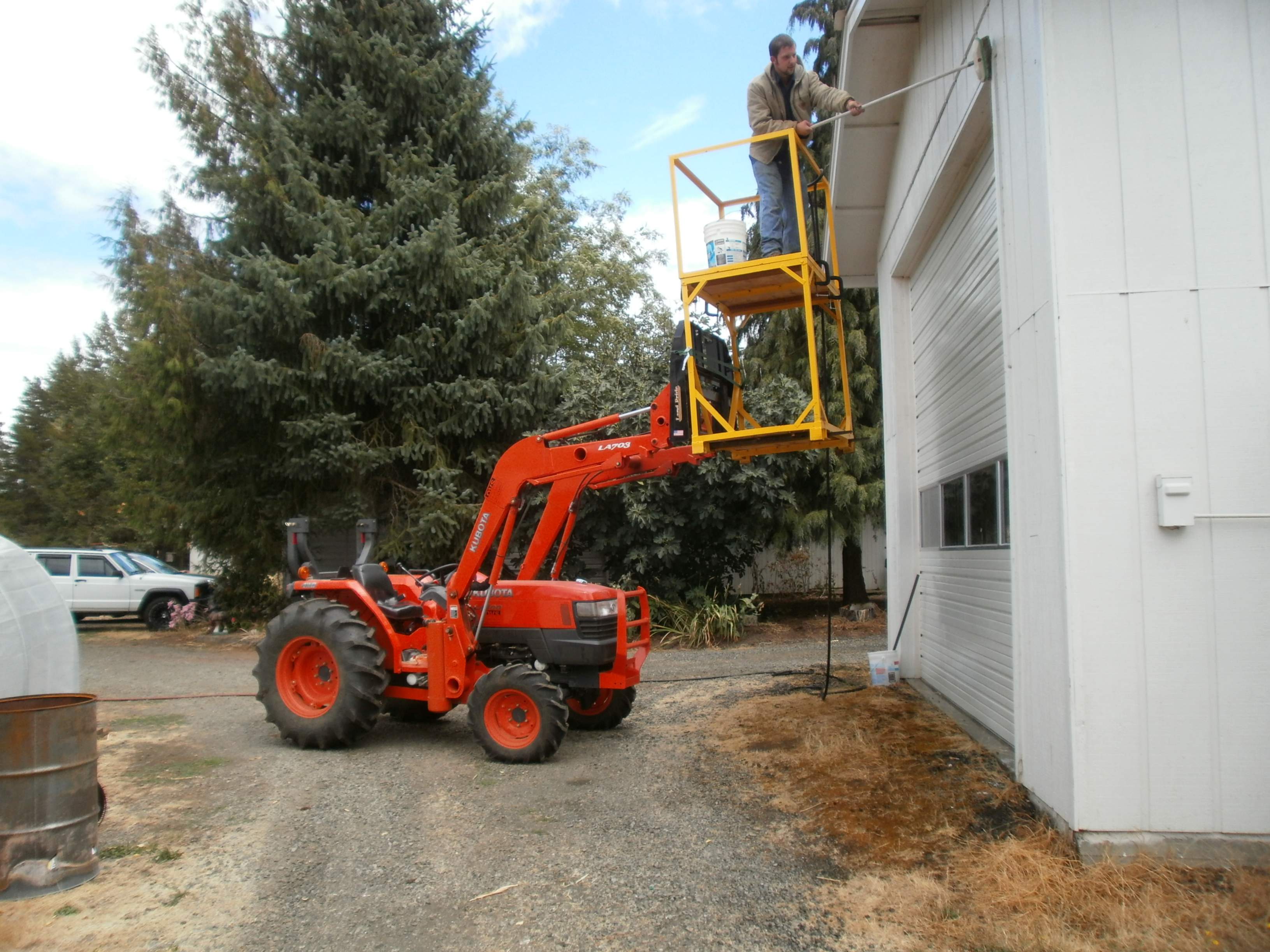

   / May get a new chipper #75
Here is a totally off the wall comment..... You can make the steel shipping pallet cage into a manlift cage.....that is what I did with my woodmaxx shipping crate.
