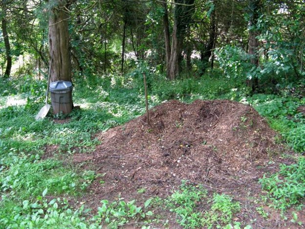

Here's my compost pile and kitchen waste collector that I put in the middle of the pile when the container is full. Recently put a bag of shredded papers in the middle of both piles recently. Got a 2nd pile from the local landfill, to right of one in the picture. Collecting urine to help decompose the shreddings.

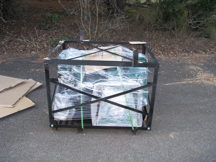

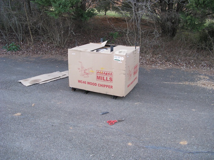

I'll try to do this assembly bit in pieces. Otherwise, just having a bunch of pics may be confusing.
Here are the picture of it as shipped. Forgot to get the camera before I ripped most of the top of the box off. Just have to unbolt the 4 half inch (where's metric Canada?) bolts holding the top metal to get at the machine. Had to remove all but the PTO shaft to connect the 3ph quick hitch. Failed to notice they'd put the top pin in the 13 inch spot instead of the 15 inch one.
Ordered last Friday. Got here at 4:15 pm on Wednesday. Got a card for $100 off military veteran.

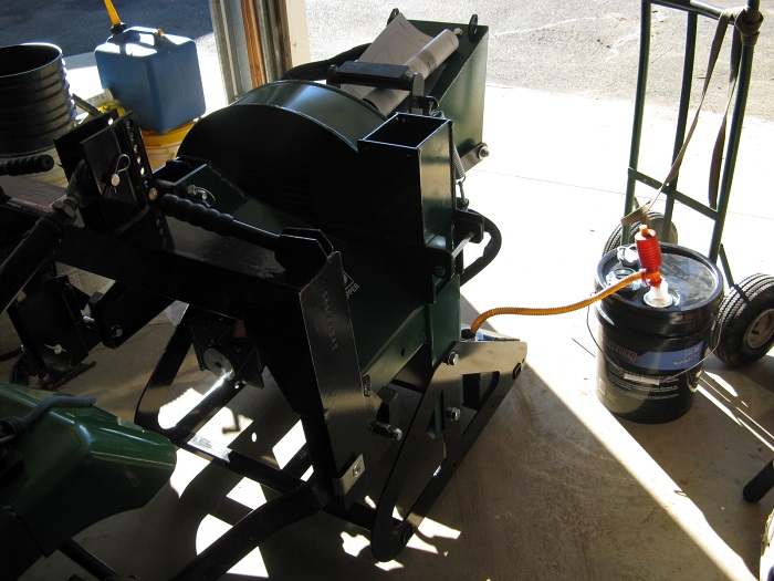

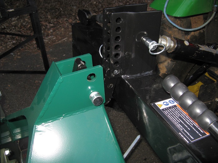

Here're pics showing hydraulic oil fill and Quick Hitch (Harbor Freight) top link spot (in lower 2 holes; probably can raise it one more hole with the top pin in the 15 inch position). The chipper was unusually low because one of the first steps is to raise it and reposition its base so it is about 4 inches higher. The shipped low position barely allowed my lower arms to fit underneath the pins, but the top hook would not go. Had to remove it and put it back after getting the QH in on the bottom pins.
Thought I was smart syphoning the hydraulic oil out with the machine slightly elevated to keep that last 1/2 gallon from going it. Didn't work. I ended up rinsing out an old milk container with water and then alcohol and pouring 1/2 gallon into it and then pouring the 4 1/2 gallons into the machine's reservoir. Virginia is right on the border of using either ISO 32 or ISO 46. Went with the ISO 46.
Wrong top hitch picture. This shows where it ended up with the bottom 2 holes used for the top hook, but this pic is the temporary short pin I used to just get it into the carriage house last night. Actually found a long, skinny pin to use in place of one of the bolts for the top hook but have 2 on order from Kenny's boltonhooks.com web site.
