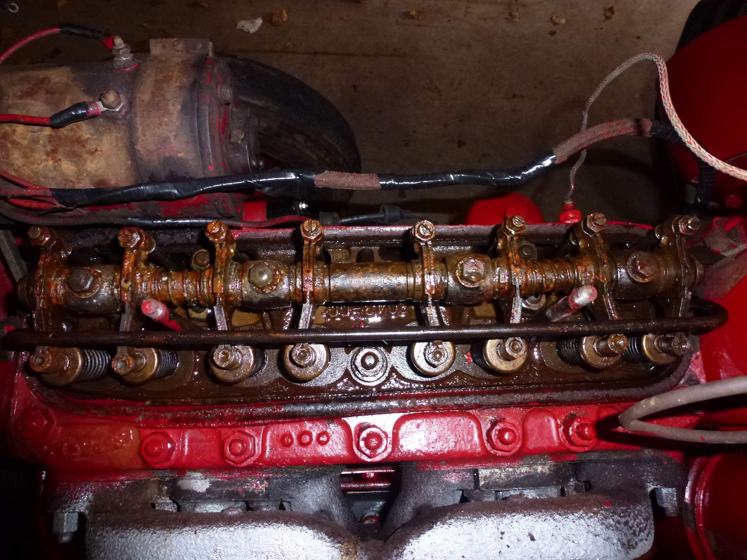

P1040296.jpgHere is a pic of what it looks like under the valve cover. There seems to be plenty of oil spread over everything. It is the exhaust valve on #4 that is stuck. Nothing seems to be broken or bent. What is the best thing I can put on it to free it up? I don't have any Marvel Mystery Oil but what else would work? Also there is a hole on the top of what seems like the oil dispersal tube near the end closest to the rad. Can anyone conferm that it should be there?

I got the exhaust valve free. The intake was leaking slighly too. I did the leak test with compressed air on all 4 cylinders and all is good exept the exhaust on #4 isn't seating properly still. I got the compression up to about 70lbs on #4 but no matter what I try I can't get the exhaust to seat any better. I think once I get it running and rev it a few times it should knock the carbon build up thats holding it open out. But judging by what it looks like under the valve cover, I will go buy some Marvel Mystery Oil and mix a quart of that into the oil for the next couple oil changes to clean everything up.

Could be that #4 exhaust is burnt too. Could have been hanging open slightly for a while, and burned. Possibly carboned up the stem and guide enough, it finally hung open. Moisture got, or is definitely getting in under the valve cover.
If it were mine, I'd pull that rocker assy. and clean it up outside the engine, but that's me...
And are my eyes deceiving me, or does the couple of spots/puddles of oil look milky..??

Your eyes don't decieve you. There was a fair bit of water in there and red paint for that matter. The gasket is toast and let moisture and the new paint under the cover. I think the water just seeped in through the gasket when I flushed the coolant passages in the block via the thermostat housing, I didn't see any water when I did the oil change when I first got it. I definitely will tear into the engine but I would like to get it fired up to see what all is wrong first. I cleaned the rocker assembly quite a bit, in place.
