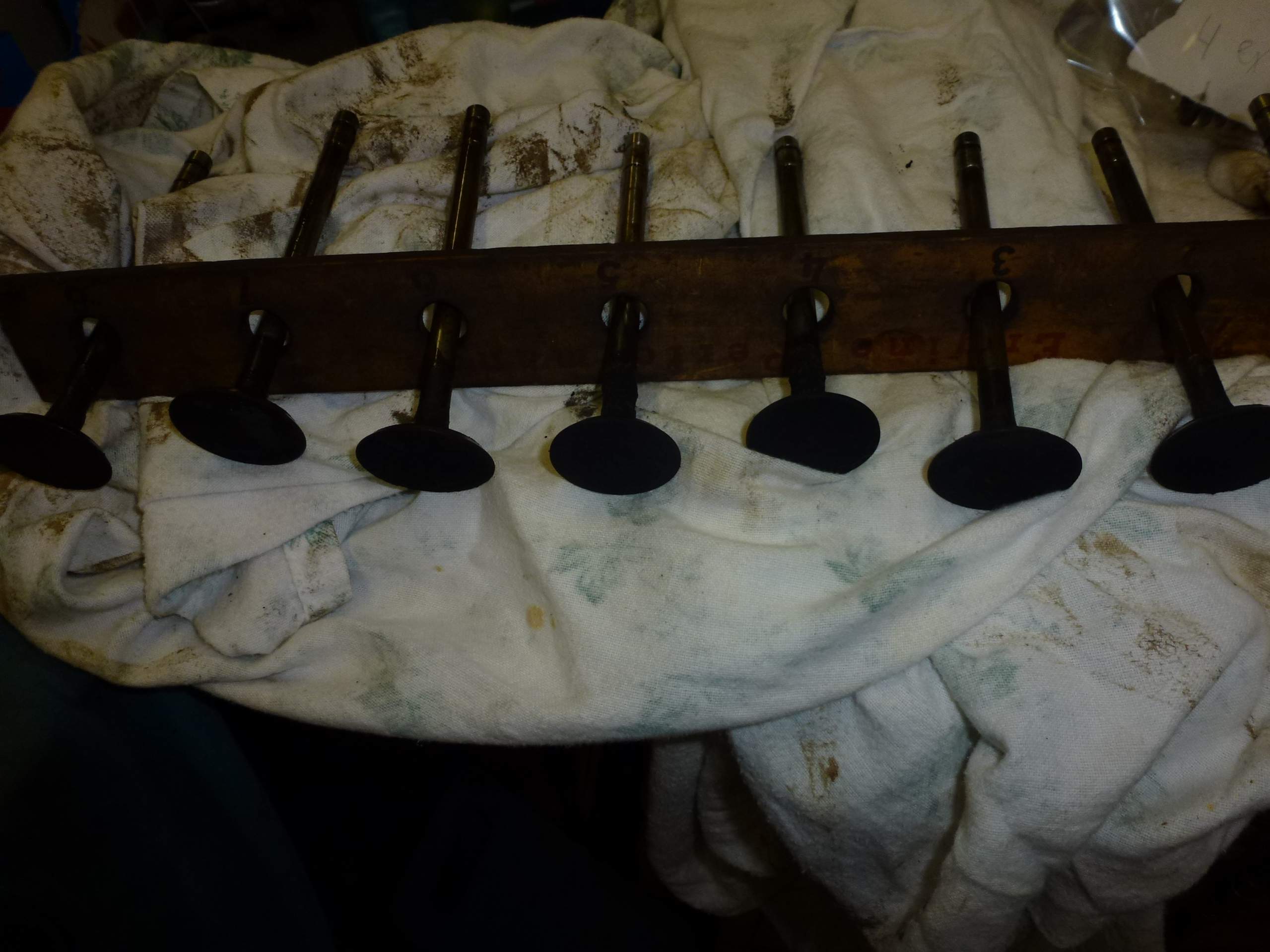

MikeR gave me a hand to take the manifold off today. I looked at the valve stems and they are COATED in carbon. I think I'll take the head off and give everything a once over and good cleaning before I do anything else. I'll post a pic of one of the valve stems soon.

Sorry it took me so long to get these uploaded but I've been busy with a lot of different projects lately. Heres the valves and head. No major surprises. Theres definitely some seating issues but no obvious major problems. I'll update you guys again once i get them ground.

No major surprises.
What about the screen from the carb that got up in there, At least it didn't cause and damage.
I found a flattened piece of metal in the #2 exhaust seat. My guess would be that it is screen that was missing. But your right, there was no noticable damage to the seat.

I've soaked the valves in "Super Clean" for 5 days and brushed them off with a brass brush. The exhausts on #2 and #3 still won't come clean though. I'll just keep soaking them and brushing them until they do. I just wanted to update you guys on my progress.
