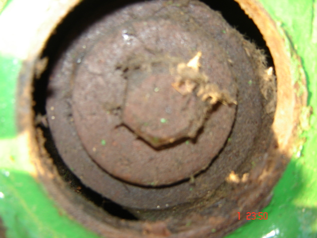

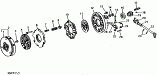

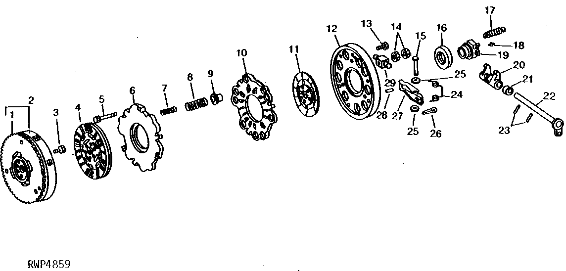

I'm curious as since you posted other photos of the 1020 why you can't remove the round inspection cover and take a photo of the PP? All I'm searching in for is thickness of PP. Look at the differences in the way the 2 PP are constructed. 1st photo dual stage clutch. 2nd photo trans driven pto.

I am sorry about that I misplaced it, I found it sitting on the tractor seat.
   / Mechanic say's this J.D. is a factory "FLAW" #36
I think the PP in photo is for a dual stage clutch which would indicate the mechanic that replaced it needs to redo the clutch job. As I previously stated it could be incorrect finger adjustment or a warped pto clutch plate.

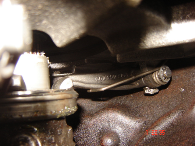

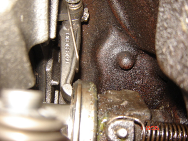

Jim when had the tractor apart he showed me the old parts, well at least the P.P. the clutch was in pieces, he told me that this clutch was odd and that J.D. used
a variety of different applications. I do know he had some difficulty finding the right clutch disk, and was adamant that it is a single stage.
I'm trying to cover every base before i talk w/ him tomorrow, let me take some more pics. and send them to you, just to make sure.

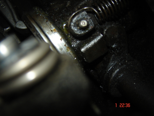

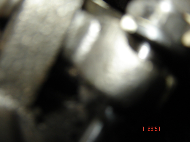

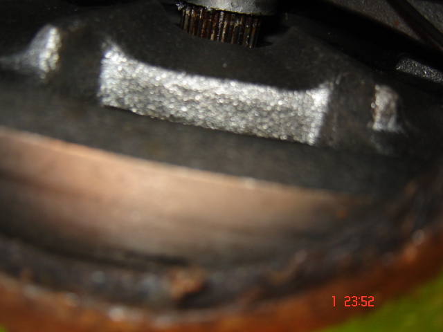

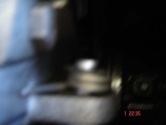

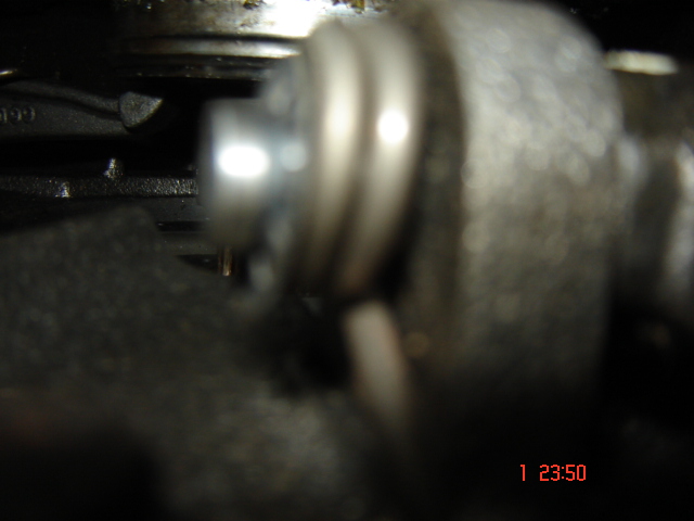

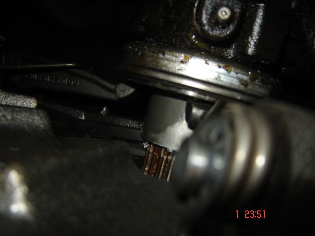

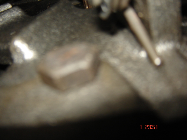

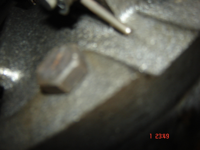

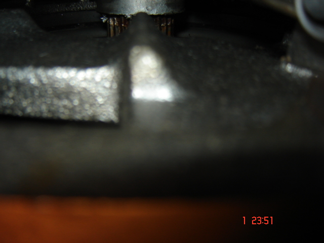

See if you can get/reveal any casting numbers. I saw a number on a PP finger but couldn't read it. Yes JD did use a few different clutch assemblies but they're a long way from as scarce as "hen's teeth". The dual stage PP assembly comes with pto assembled in it so to a novice it might appear as as a single stage clutch.
#40
DSC03282.JPGDSC03285.JPGDSC03286.JPGDSC03287.JPGDSC03288.JPGDSC03289.JPGDSC03290.JPGDSC03291.JPGDSC03291.JPGDSC03294.JPGDSC03295.JPGDSC03293.JPGDSC03292.JPGDSC03290.JPGDSC03284.JPG
Jim I bumped the starter to give you a different view, can you tell if it is a 2 stage or single, as he stated, or anything else.
