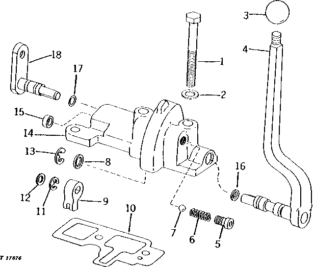

T17876_________UN01JAN94.gifYou could have an independent pto option. That would be a single stage clutch for the foot clutch with a separate clutch for the pto. Do you have a lever between the two shift levers? If you have a lever like this, lifting up on the lever engages pto clutch and pushing it down disengages it.

View attachment 342014You could have an independent pto option. That would be a single stage clutch for the foot clutch with a separate clutch for the pto. Do you have a lever between the two shift levers? If you have a lever like this, lifting up on the lever engages pto clutch and pushing it down disengages it.

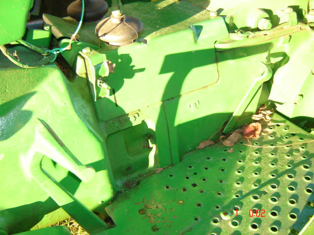

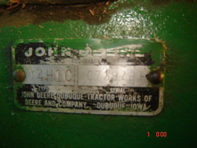

Mechanic replaced a clutch/pressure plate on recently purchased 1020 John Deere, the clutch is single stage, when a bush hog is attached and you attempt to engage
the grinding begins which will not allow engagement of the bush hog.
The only way is to pre-engage, and than start the tractor. The mechanic says this was a flaw with this type of single stage clutch setup and this is why those who purchased
these single stage John Deere's got rid of them.
The tractor was purchased very cheap because the clutch was out and the repair was justified for this reason. Does this make sense to anyone or is this mechanic
blowing smoke because he did something wrong during the installation ?
