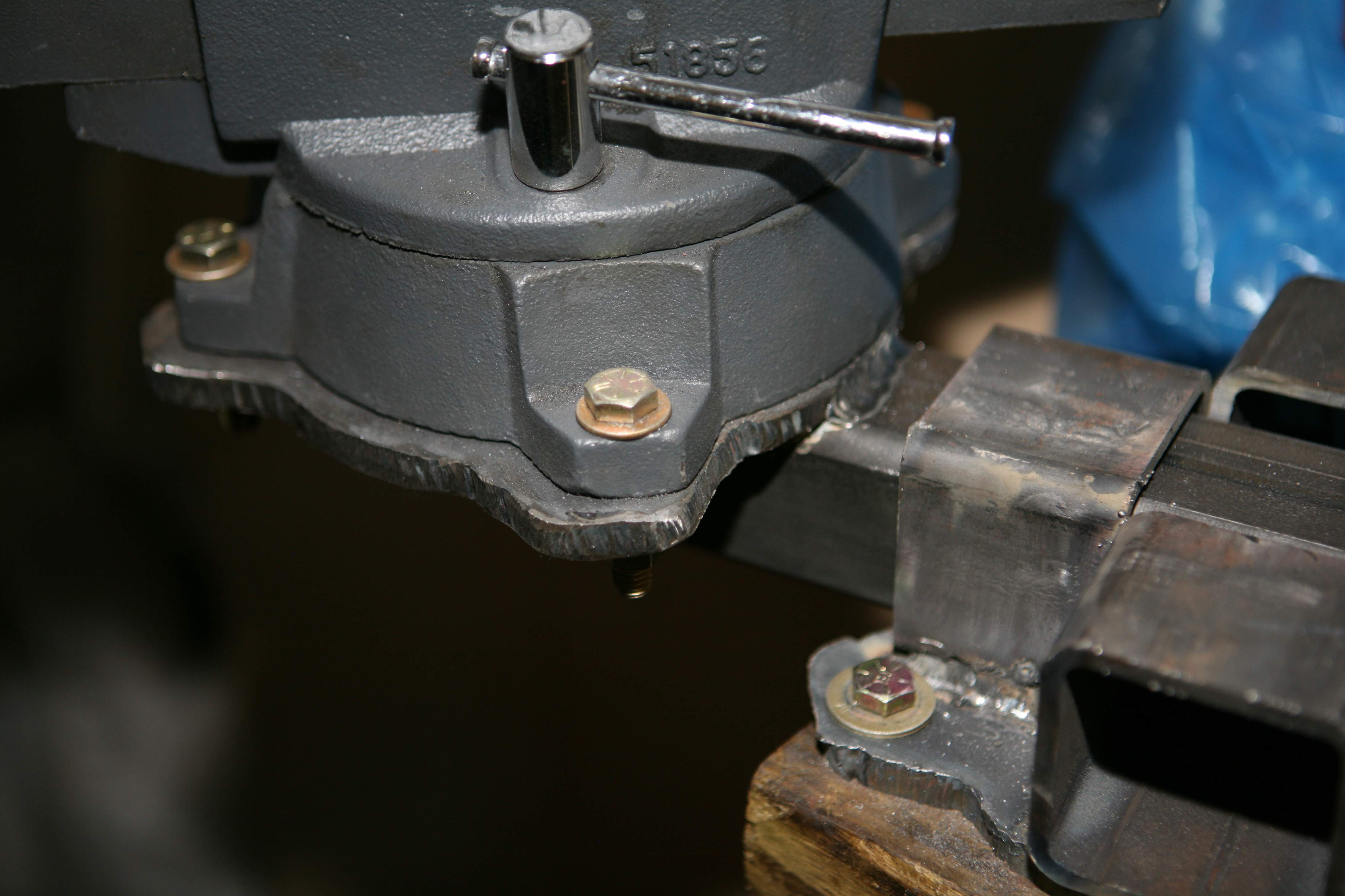

I have a 6" Craftsman. Don't know if its "professional" quality. It serves my needs. I basically used it to hold stuff while I grind or weld and on occasion replace u-joints.
I had it mounted on my work table, but discovered being portable was more beneficial. I cut out the base from 3/8" steel using the vise as a templet and welded a 2" square tube to it.
