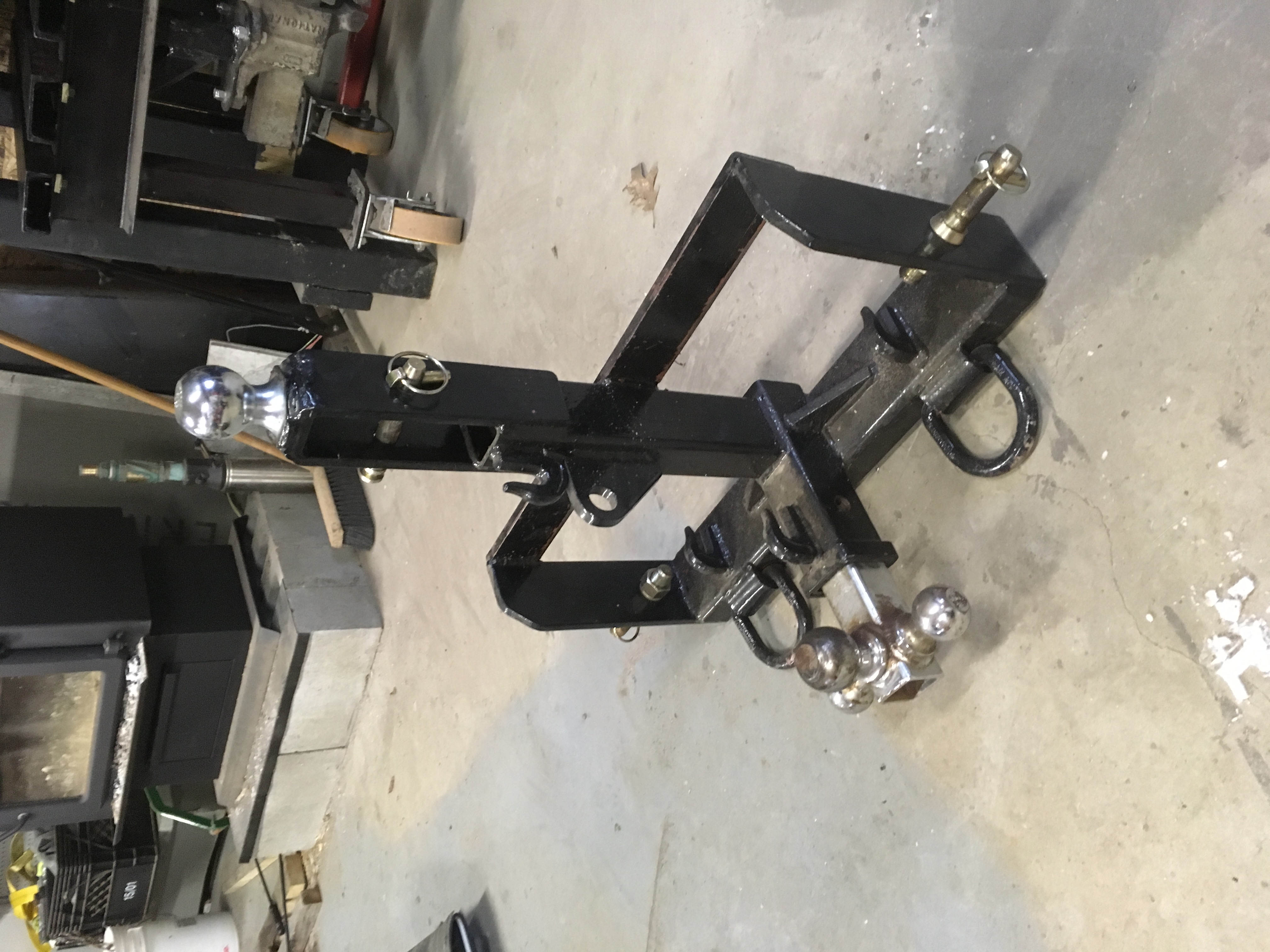

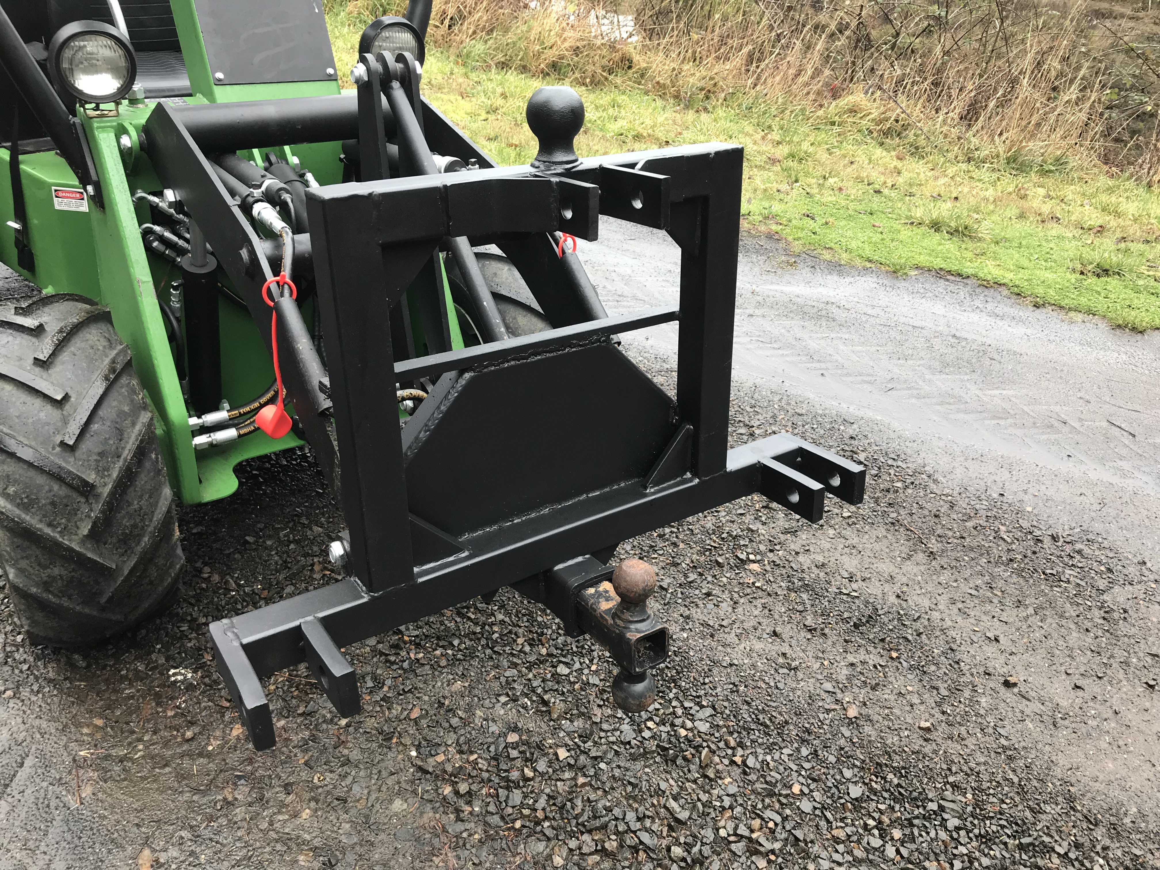

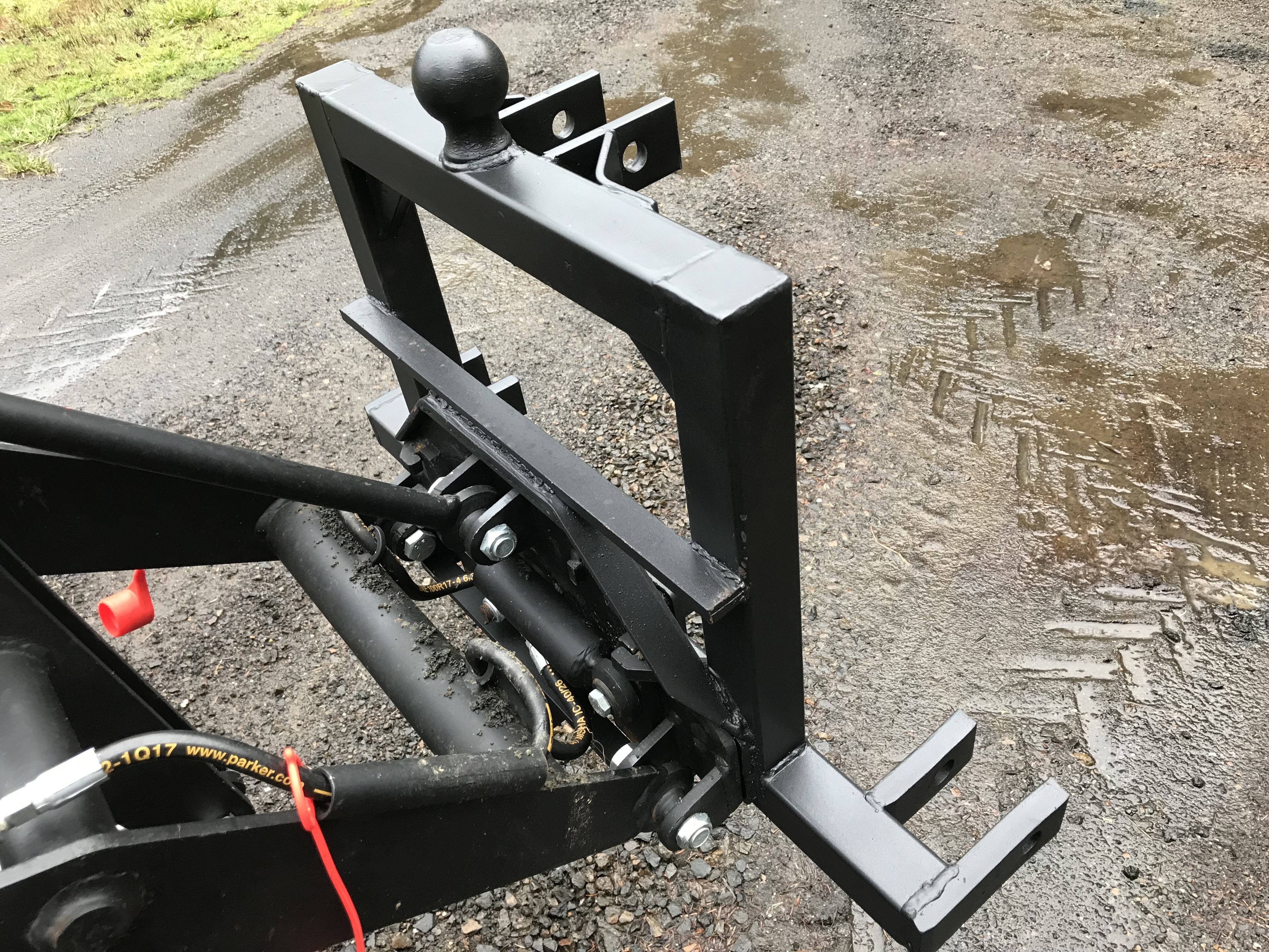

Not great pics... But you should see me draw.
So originally a tractor 3pt to skidsteer adapter. In the pics it's mated to a skidsteer tree shear.
Changes : added 1 pt 1850 qa plate, 1 pt 425 qa plate
Hard to see, the 1850 has stickers and is low on the frame, the 425 plate sits above and 3" away from the frame (toward the PT) this over /under setup means either machine can use its native qa plate... Attach the small qd set and crush some trees...
One more mod and then we'll still be able to use the tractor 3pt (which I have added to rear of my PTs) so I can for example work the forestry flail mower on the front of the 1850, stump grinder in the front of the 425 and the shear on the rear of either.
The yellow cylinder is replacing the red one and 4x the shear pressure... We'll harden a couple of spots for the extra force.

WOW! Very nice you can use it on either size machine.
