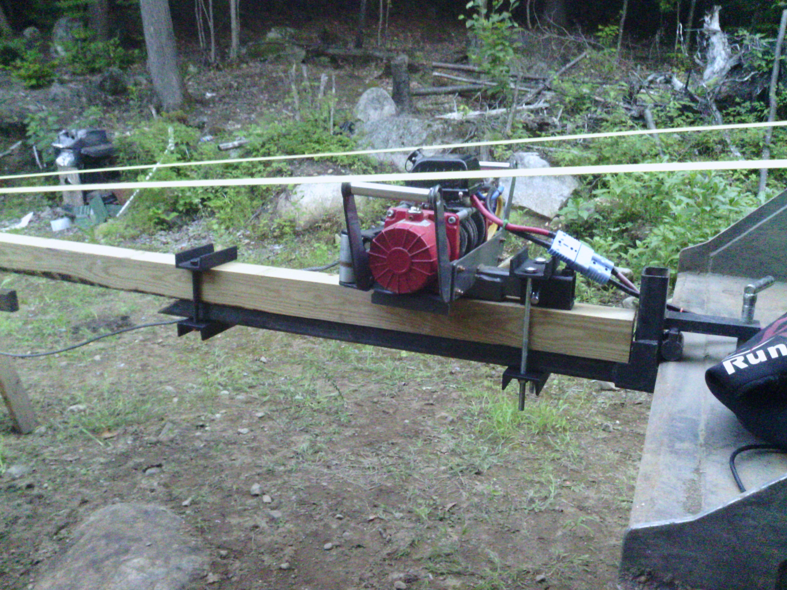

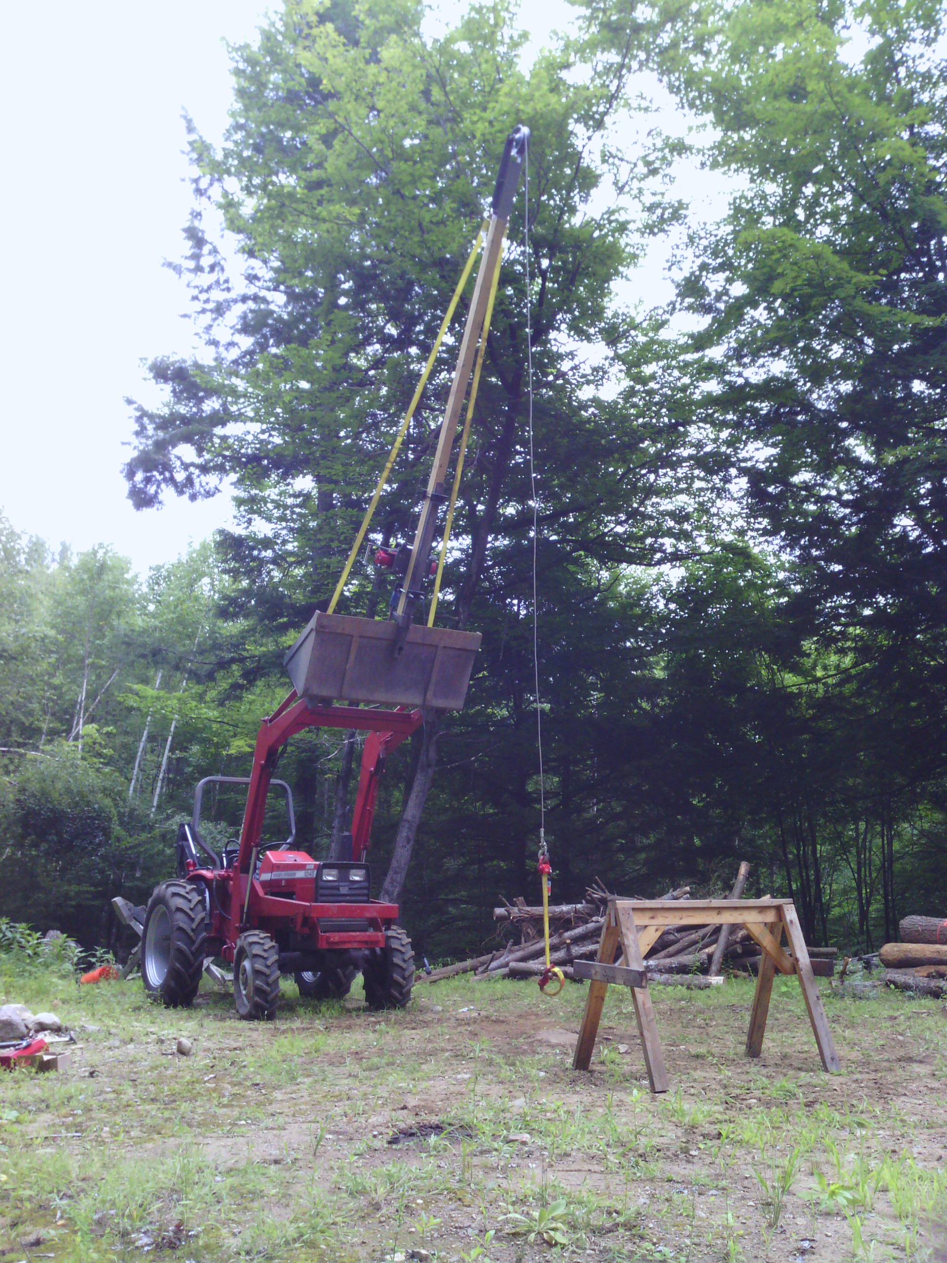

Electric loader boom hoist 23' lift

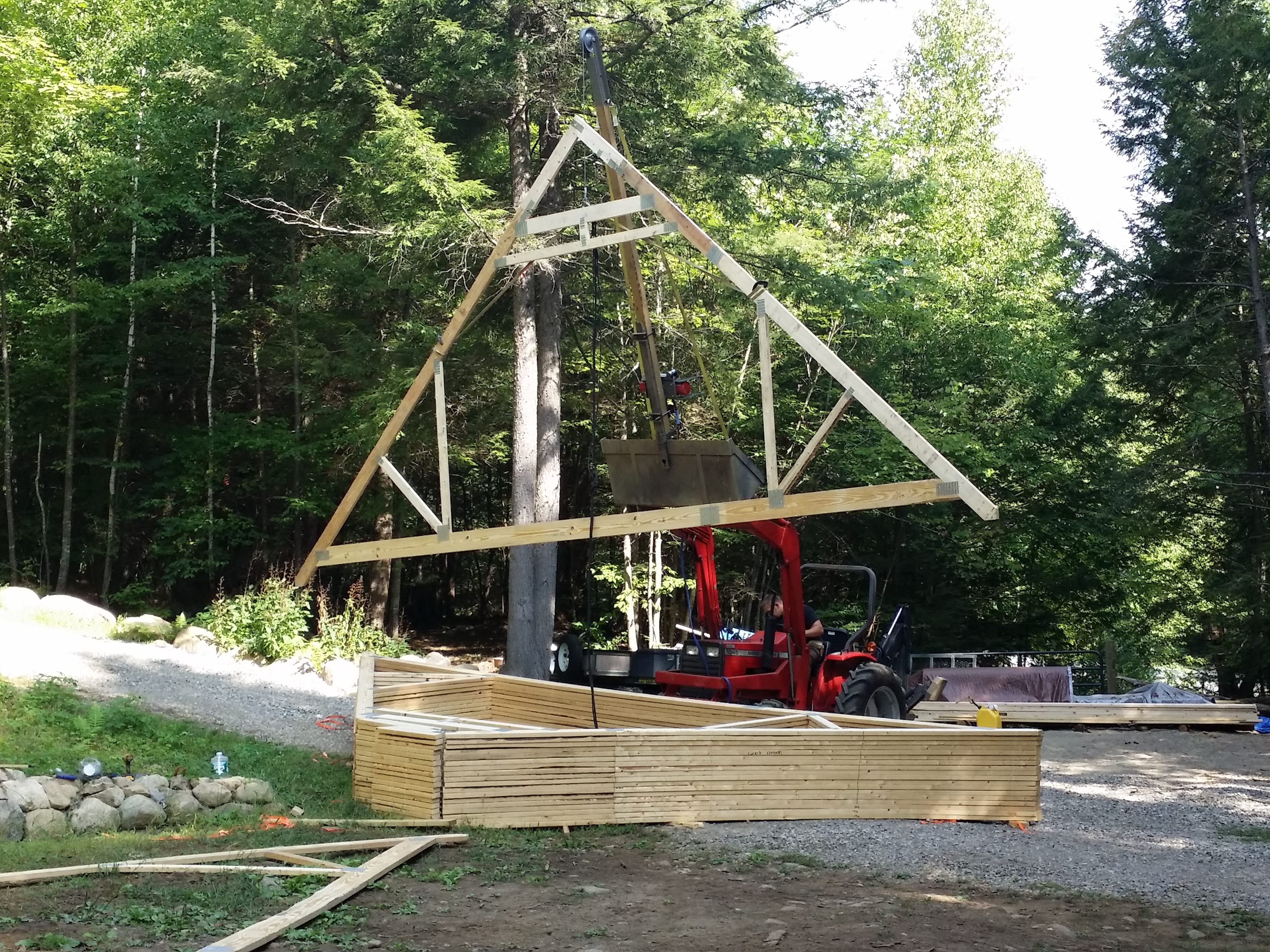

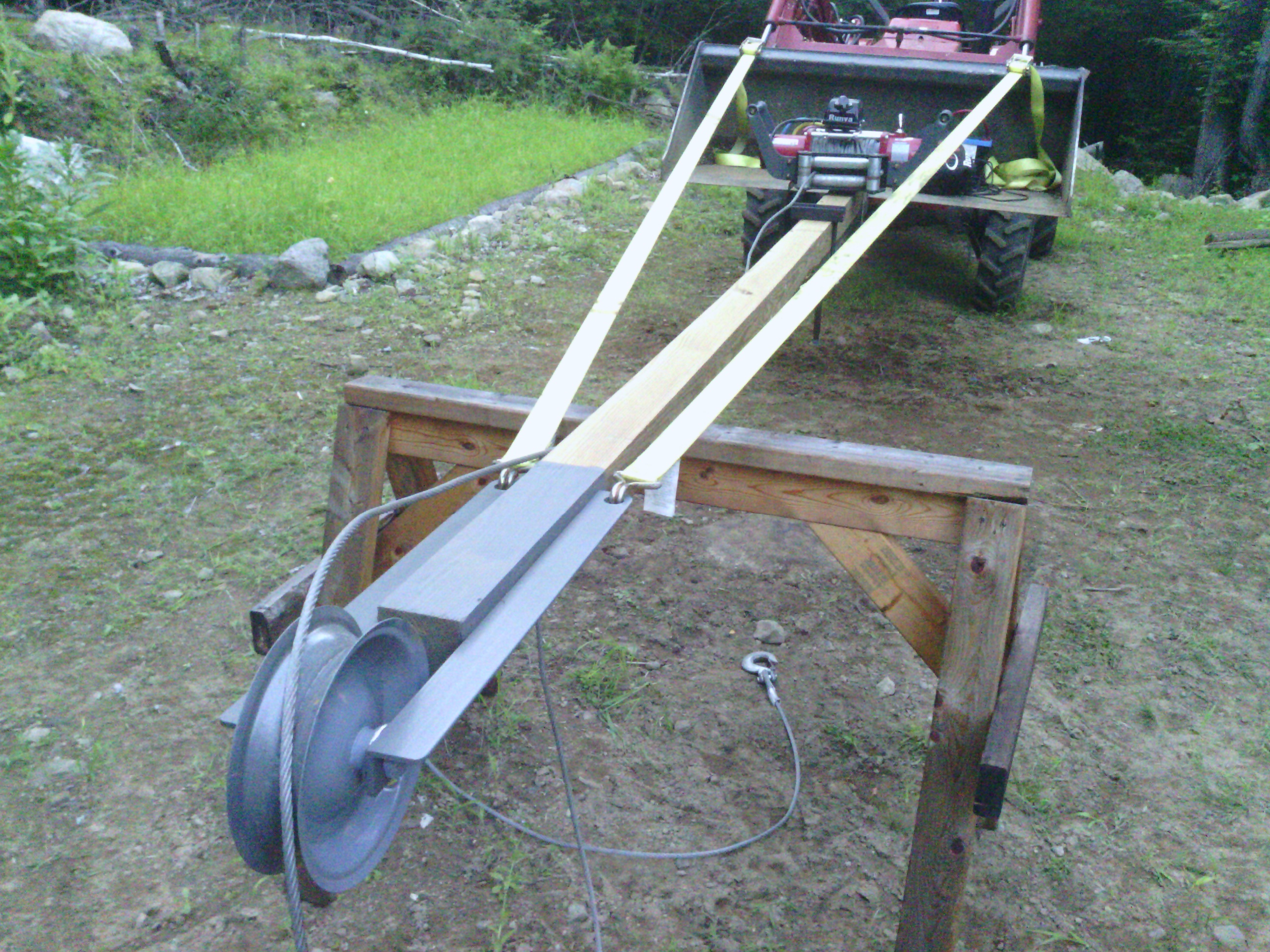

Yea if you already have forks straps and a winch it's cheap to build. just a 4x4 some steel angle and a wheel barrow wheel. Winch is waaaay overkill but it worked to set my trusses on 10' walls.
   / Members home made attachments / improvements #346
Winch might be necessary to do with with a loader that lifts less than yours. That's quite a lever arm. I'm pretty sure that no loader with only 1000lbs or so of lift would have an easy time of raising those trusses.

I like it. Two things come to mind.
What stops it from being "flipped" back on the tractor operator if a push comes from the front?
I don't know this I'm wondering if the loader is loaded with more weight than its relief pressure is set for, would it bypass and drop the loader suddenly?
   / Members home made attachments / improvements #348
trusses were 190lb. Even at that length if the boom was maintained at 15 deg or so off vert it had no problems lifting them. Just cant go too low with it. As for it flopping backwards, Self Preservation is the only thing that prevents that.
   / Members home made attachments / improvements #349
Yeah I knew the weight is well within your safety and really like the idea. I think the boom piece under the bucket stops that flip back after I looked close and as you said the angle is key.
What I'm wondering is if that winch picked up more than our 1000-1500 lbs what the loader would do.
Absolutely not dissing this. It's in my need one of these pile! Just a "wonder what happens when I do this" question. Whether the loader system would check valve stop or bypass relief drop random question.

It absolutely would. If the tractor didn't nose first. Thats an 11,000 lb winch. A 1500lb atv winch would be much better suited for this, but it's what I had.
